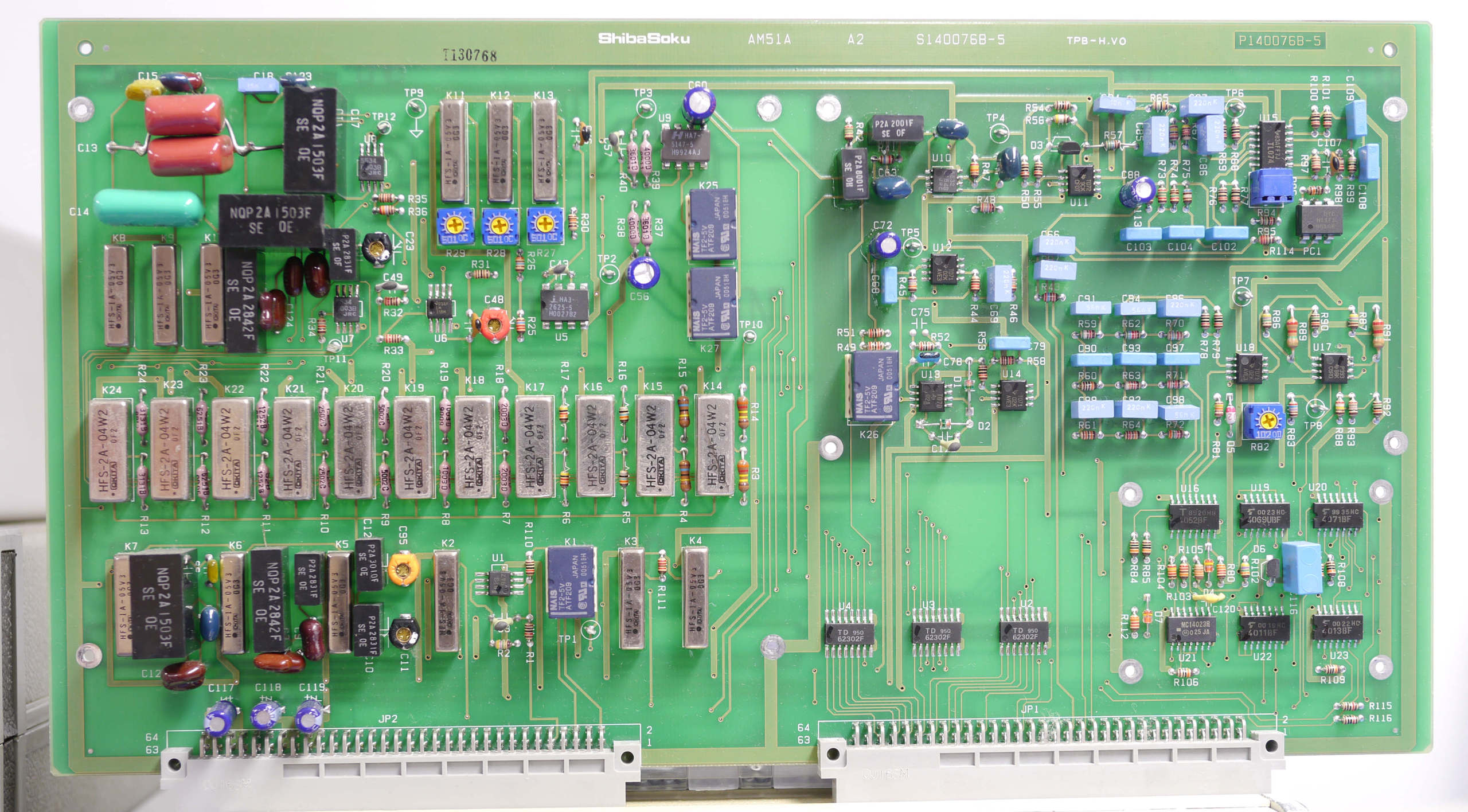

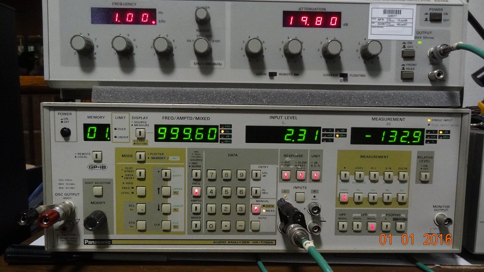

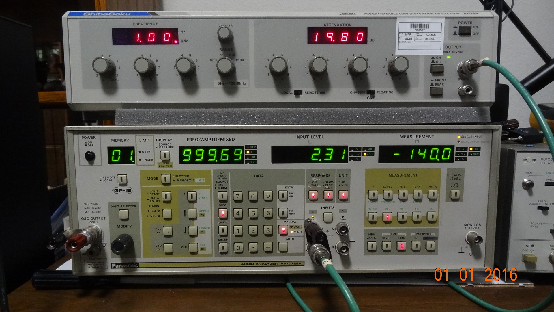

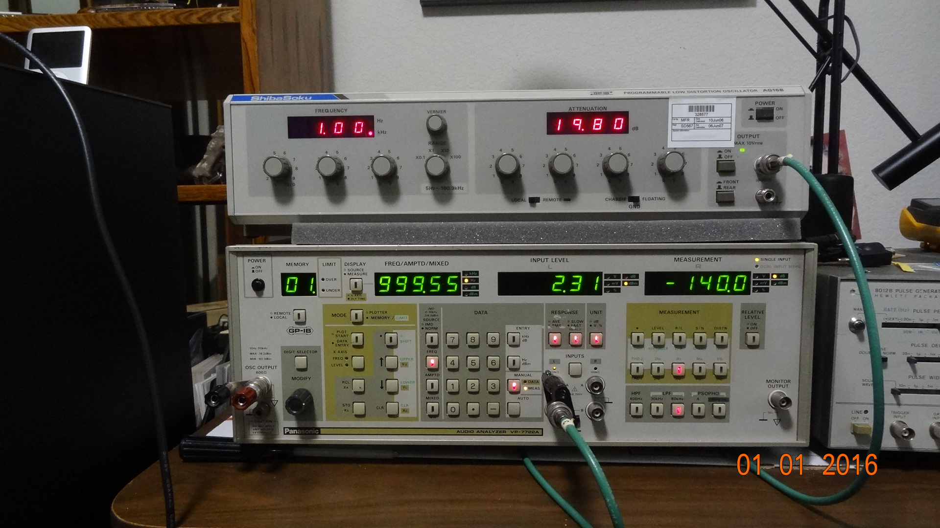

I replaced the feedback amp for the first notch filter on the AM51B.
The original part is a NJM5534M by JRC in a DMP-8 package. It is designated U8 on the upper left portion of board assembly A2.
The replacement was an OPA1611 in a SOIC-8 package. It'll fit just fine on the original PCB footprint, no modifications are necessary.
The distortion on the second harmonic was reduced by about ~7dB, the 2nd now reads -139dB on the meter using the built in oscillator.
I need to investigate the funny business going on at ~13kHz, I think it's poor ground routing, oh boy...
Is that that ground doing a complete loop around the perimeter of the PCB?
If so that's a no no in PCB design. Besides looping the ground it also forms a dipole antenna.

I just break the loop. No rearrangement. But first determine if it really matters.
What on the board? What gains are pressent.
If the loop is on a board with 30dB + of gain or more then there may be ab issue.
If it on a digital board then probably not an issue.
The earlier Shibasoku deigns didn't do these ground loops on the boards. So it's not the same people doing the design.
The loop might just be for the grounded back pane.l In which case then it doesn't matter since the back panel will close the loop. See if there are any parts/circuits using the ground.
