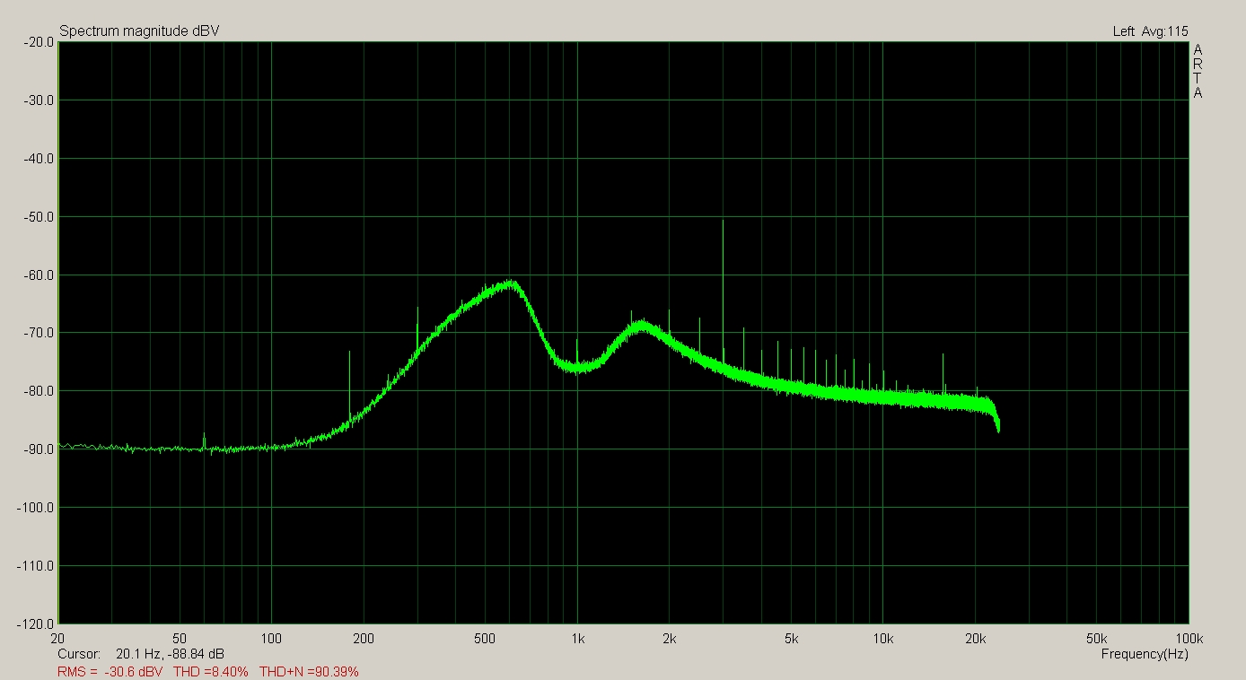

Here it is with the Shielded A6 Board.
I've got to fool around with the boards
and ground to reduce noise, not increase it.
Signal about 3-5 dB down. But the noise
went up....not so good.

Original (64000/30avg):
w/back plate (64000/50avg):
.Any other size difference complements of Microsoft and I can't undo it.

That is with the back plate back on the boards.
How did you get your noise so low? That is looking good.
Okay pic coming up shortly.

Sync-
1) Make sure the 3H is not from your source.
2) the DC offset on the input has influence on 3H
3) a linear plot makes it easier to see the harmonics
4) the 60 Hz and 120 Hz will limit things. Getting those down (use a battery powered source) will help.
5) Max in is 100V. Don't overload it with the MC350.
