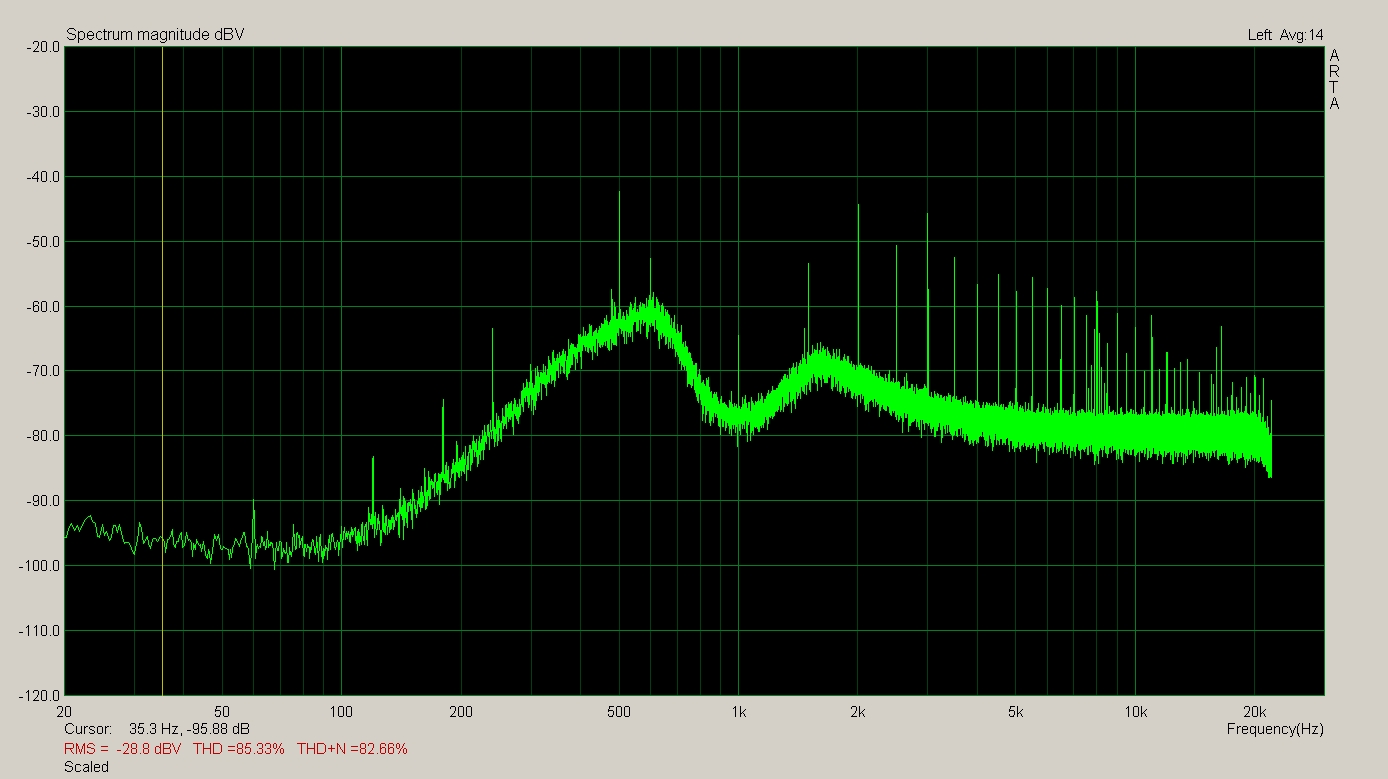

I see. The 725D has one extra range on the scall.
Here is one with the scale corrected.

I have the QA400.
I'll have to figure out how to set it.
1kHz from HP339a Oscillator to unbalanced input
of Shibasoku 725D, Meas Function = Level. Response slow.
Frequency 996Hz, adjusted to to 10 on the 0/1 Meter Range.
Meter @ 10.
I assume the difference is the insertion loss of the QA400?
At follows:

No it not insertion loss it's just the way they calibrate the QA400.
You have to delete the cal file in order to recal the QA400.
I don't think you'll be able to do it with the QA but give it a try.
No matter if it 3dB low we can mentally add the 3dB.
Show one in distortion mode.

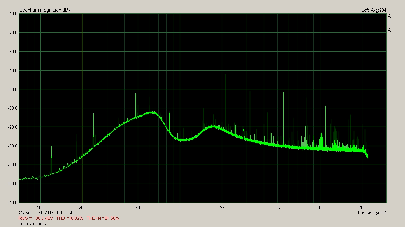

Some improvement here.
As the spike around 500Hz is brought down the harmonics generated from this clock signal
drop proportionally. I've got a 10dB improvement here so I'm going to call it a night.
I've been at it for hours. Not easy to do without a schematic. I want this signal into the noise then all the grass above will be gone.
Next step will be to reduce the distortion.

I'll be damned. Clock noise. And that propagate throughout the analyzer.
Or is that clock noise coming through the monitor output?
or Both? Is there any benefit to getting a clock upgrade for this?
One of those radiated and hardened clocks?
What is the clock frequency?
I'll ask other questions when you get finished.
Poor ground routing. Unfiltered rails t noisy digital circuitry.
The 725D meets Shibasoku's spects. There was no reason for them to go further.
Not all the boards where laid out by the same person. It shows. One digital board has all the grounds looped around the parameter of the board as well as all the supply rails.
This turns the whole board into a transmitter with a dipole antenna pointing straight at the analog boards.
But the main problem is drawing current by the digital circuitry through or by the analog
circuitry. The analog ground needs to be downstream from the digital ground return currents.
Rerouting the digital ground, the clock, back to the analog ground at the analog power supply
solves this problem.

The clock is about 498Hz. That's why the harmonics show up in the FFT. The clock is part of the analog divider for the meter circuit. The analog divider circuit does the THD+N calculation. It operates on a DC signal provided by the peak level detector at the output of input amplifier (impedance convertor). A peak detection is also done at the analyzer output which also supplies the signal to the monitor output. The two DC signals are ratio by the analog divider and it is the output of the divider which is sent to the meter for THD+N mode.
