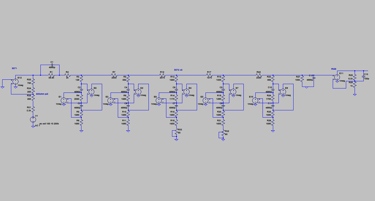

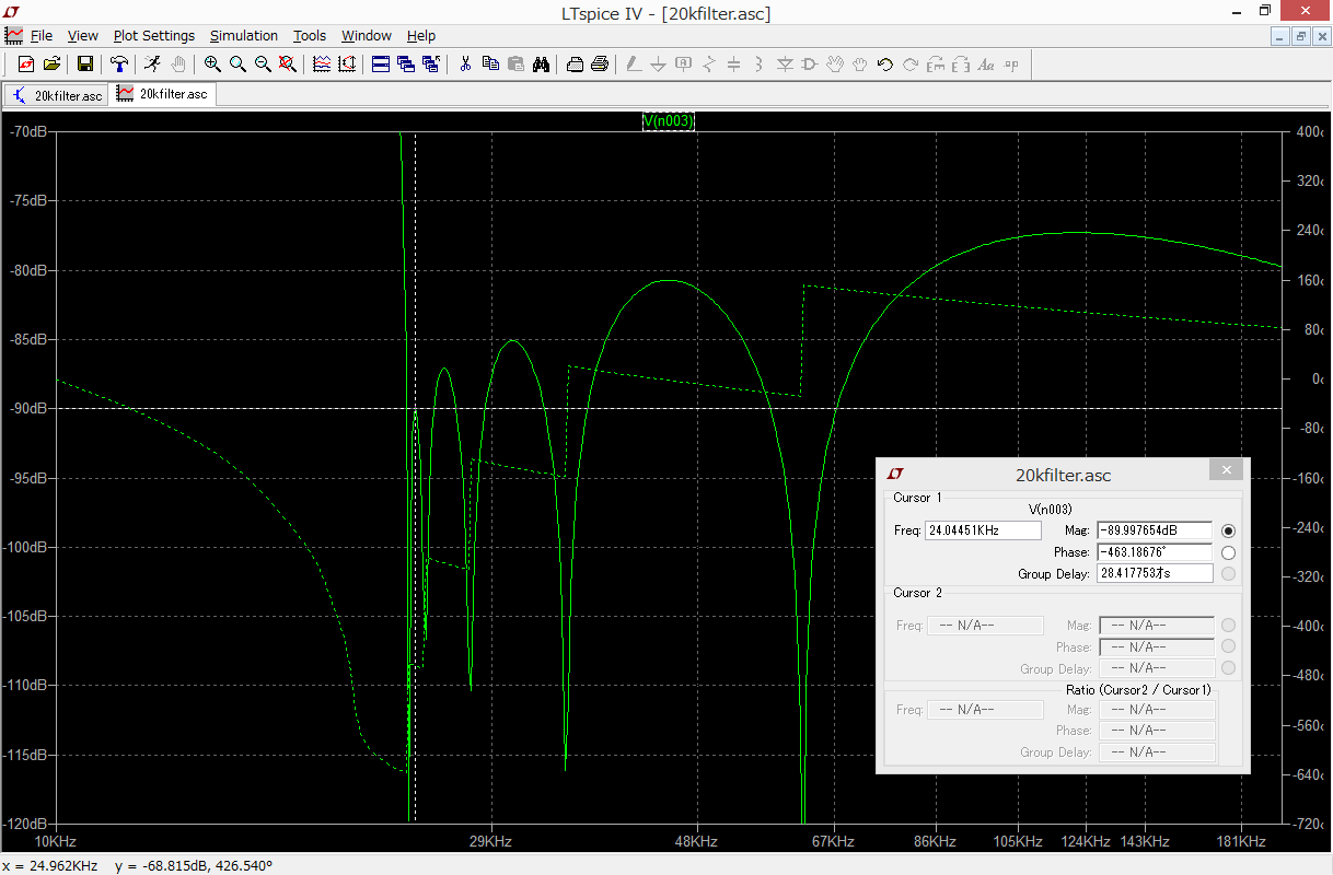

725C optional 20kLPF
11th elliptic? but ripples are far from ideal.
and NOISY! I replaced TL071 and LF356.

I tried putting little 12V lamp on 1.5k resistor which is DCR=20ohm at room temp.
At first look, residual noise reduces around 2dB at low input range, yeah as expected.
When testing at some input frequency at upper limit of amplitude range , the distortion rises irregularly. aaaah it is oscillating.
I experienced similar phenomenon when I trid to replace a notch opamp. I checked oscillation at notch output only at the time but not input. i must confirm what was oscillating.
The 20ohm may be too low, though the differential input capacitance between JFETs gate to gate must very small?
singal source I used is 600ohm output impedance.
725C's *20k* filter is on the other board inserted between 3rd notch and filter board switched by relays on the mother board.
Fundamental wave is attenuated before it so distortion do not matter.
In simulation the residual noise is 77uV up to 30kHz BW ,which is -118dB of 3.16Vinput*2gain*10gain.
I'm curious about this observed oscillation. Are you sure it is oscillation and not an ingress signal. Is it in any way related to the change at the input with the lamp?
The circuit formed by Q2 and Q2 has a dual purpose. It keeps the the Ac potential across the Jfets relatively equal which nulls the effect of the nonlinear
junction capacitance of the Jfets. The circuit does the same for the input protection diode circuit by keeping the AC potential equal across the diodes D4 and D5. This nearly eliminates the leakage current through the diodes. Two sources of distortion are eliminated or minimized. Effectively there is no capacitive reactance other than strays at the input amplifier. So what effect if any would a change of input resistance have in this range?
