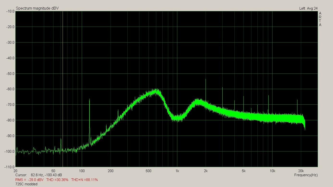

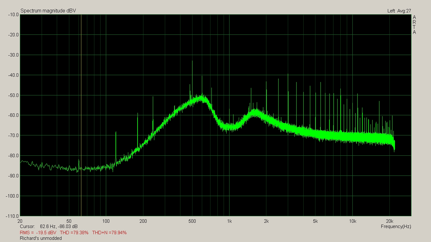

Had some time to look at this today and this is what I've found.
A lot of work to be done here. It will take a while.
First pic is Richards 725D unmodified.
Second pic is my 725C modified.
Can't justify why the 20kHZ filter on the 725D sends the meter almost to FS.
The 725C raises the noise 1dB
David,
The levels are about 14 dB different, can that account for the difference?
RNM
62.6 Hz, -86.03 dB
Davada
62.6 Hz, -100.43dB
If so I can do similar with my 727D and the post same.
At least you would have two 725Ds plots.
I'll be able to follow along if you like and point out anything
that is confusing to me which might help others also.
