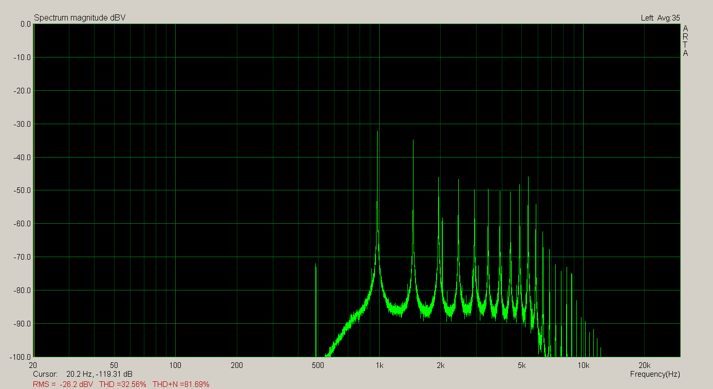

David has reduced the noise and distortion significantly for me to get these new specs from my 725D:
-140dBV THD
-121dBV THD+N
Here is data at monitor port; FS @ 0dBV = -110dBV FS
THx-RNMarsh

Not really. It was a miscalculation.
Actually that's pretty suspicious. The BEF's have like a 1% bandwidth so unless the fundamental was way high reducing it should not make a big difference.
What was it before and after the tuning? Relative to the overall noise floor in 30 KHz band a 6 dB reduction is like halving the input noise from 5 nV to 2.5 nV, which is not going to happen easily.
