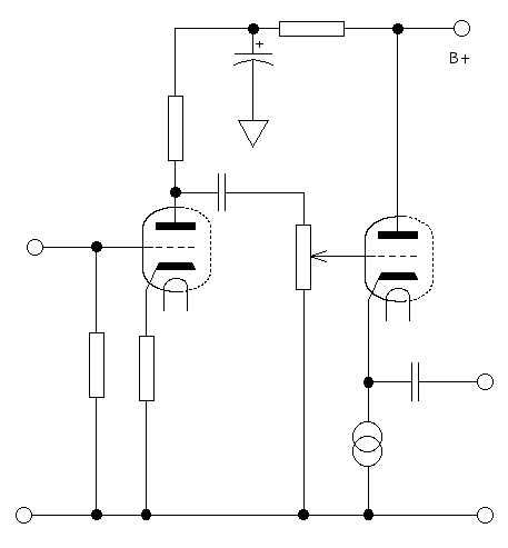

Sounds like a good job for a vacuum tube....
dave

Re: Re: Re: Power DAC for SEWA Dreams
Maybe it would be a perfect tube job.
for those who master tube circuits.
But also good OP-Amp possibly with a couple of transistors for increased output capacity.
But I really, on second thought, question the benefit of this idea.
So where to put volume control?
If you have 10 V RMS output from DAC.
Would you put a pot at DAC output,
and attenuate the voltage level you just have amplified ...
This is never a good idea.
First to amplify, with the distortion that always more or less comes with voltage amplification.
Then to take this signal back to low level.
We should only amplify voltage when we really need it.
The only way around this,
is to make the DAC circuit have a variable gain option,
between 1-10 for example.
The good thing with CD-players DAC output is at 'line-level', max 2.0 V RMS
is that devices, like often headphones, or passive pre amplifiers,
can use this signal directly
without any amplification and further distortion.
lineup

Yes, the resistor at the bottom of the cathode follower should really be a CCS or choke... this dramatically improves the CF (i've updated the drawing). You could also -- to good effect -- add a CCS to the anode of the CC stage.
Also since it is only 2 stages you could leave out the last RC decoupling stage in the supply rail.
dave
dave
Yes I think this are god ideas.🙂You could also -- to good effect -- add a CCS to the anode of the CC stage.Also since it is only 2 stages you could leave out the last RC decoupling stage in the supply rail.
I´ve decided to never again use a anode resitor in a preampstage..😉

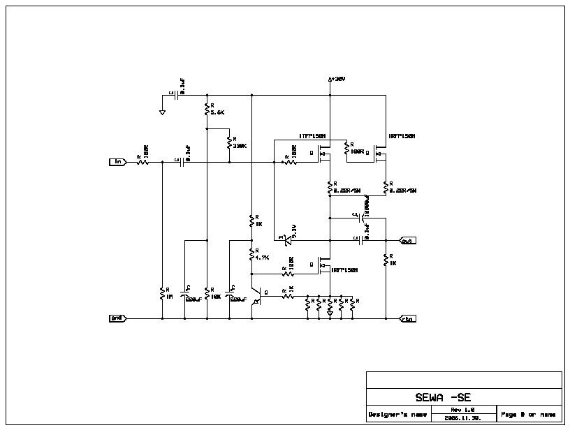

Sewa S.e.
Hi!
Now I have one more perverz idea:
I would like to build a SEWA SE version with ca. 20-25W output power! 😀 Is it possible??????
Could we start with the attached schematic?
Mads? Lineup? Are you happy that I am asking again???😀 😀
Greets:
Tyimo

You could build a 250-300W version too if you can get rid of the heat, 1200-1500W per channel.
I´m waiting for a pair of quite big heatsinks to arrive, I´m planning to use them in a follower operating at 32V 3A.
Should deliver 15W or so.

Re: Sewa S.e.
Tyimo
you said it yourself!
- this is the most perverse idea I heard in several days
wouldn't be SEWA no more
would be:
TWEWA (20watt) or TWE5WA (25watt)
lineup

Hey Lineup!
Yeeeeees! I forewarned you!!!!😀 😎
Ohh man, I like your humour very much!!!! Since I read your answer I can't stop laughing! 😀 😀 😀
But seriously: would it work???
30V-4A??
I need a higher power SEWA to drive not sensitive speakers.
Greets:
Tyimo

I was perhaps a bit sarcastic, but it wasn´t meant as a joke.
A 50W SoZ consumes 1200W per channel, just for reference.
With some kind of forced cooling (water or fans) it wouldn´t be too hard to manage. Reliability would be an issue though, if the fans or the waterpump breaks you will face meltdown within minutes or even seconds.
Not that I can see any point in such a project, if I felt that I needed 250W I´d change the speakers to something more sensitive instead.
A 20-25W SE follower OTOH would be a fully realistic project, the 100-150W of losses per channel wouldn´t be a problem for a pair of good heatsinks. Spreading the heat by using multiple Mosfets would probably be a great idea, same thing with putting a lot of effort into mounting them correctly on the heatsinks.
40V and 3A should be enough for just over 20W into 8 ohms.
Since I´m more interested in current capability than max power into a resistive 8 ohms load I´ll go for 32V rails and still pull 3A through the mosfets.
Another possible explanation to my choice of voltage and current might be that I have some 24VAC transformers and a couple of 3A chokes in the junkbox😀
