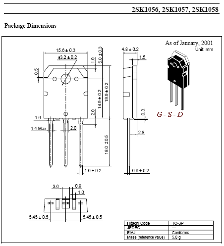

I would like to ask you to redesign your BOZ and SEWA PCB for 2SK mosfets pins. (GSD) Should I?
In your BOZ the Q101 and Q201 and in your SEWA only the Q1.
I know it is an easy modification, but I donn't want to draw into your very nice and elegant PCB artwork!
Lineup has a good idea to try in the SEWA the 2SK1058. What do you think?
If it is possible, I would like also to ask you to modify the circuit to use the 2SK1058's different Vgs(max 1.4V) Should I?

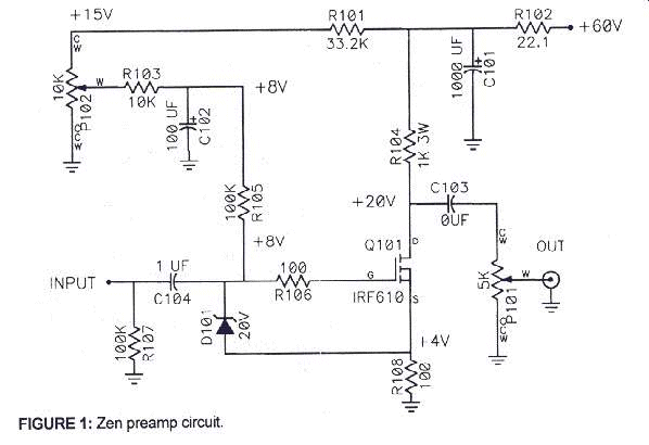

BOZ Bride Of Zen 2SK216 IRF610 Aren van Waarde
I found a BOZ project on web, that used 30 Volt at Drain.
And this was found to give better performance (symmetrical clipping).
The original, for only use of BOZ as normal preamp, with only low Volt RMS output (1-2 Vrms)
used 20 Volt at drain.
For SEWA, BOZ is used as a voltage amplifier.
The output can be maybe as high as 8-10 Volt RMS max.
Mad_K. suggested 25 Volt DC at Drain (=output) for this.
It might for some, be an improvement to use even 30 Volt DC.
It depends a bit of how high max output your SEWA would use.
Regardless if using IRF610 or 2SK216
I think 30 Volt at FET Drain could be better, at least in combination with SEWA.

Hi JC!
Yes, but don't forget I am using Mads PCB and PSU!!!
3.46Vdc on Source/ R108-100R= 34.6mA
Nothing, 7x9.1V Zeners.
The 4.7uF is not enough! You have to use 10uF!
Greets:
Tyimo
Are you repacing TIP29C in PSU to IRF630?
What Q101/Q201 bias current (V across R108) are you setting for?
Any mod on zenners stack?
Coupling caps will be 1.0 and 4.7u Black Gate N.
