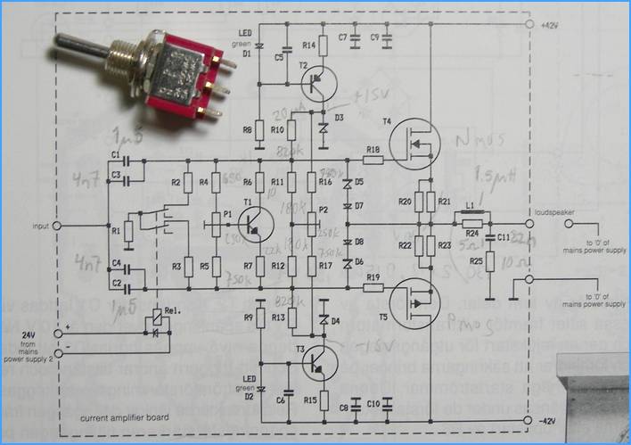

See my attachment, Tyimo!
I have a couple of these 2-pole, 2-way switches.
These switches I bought has got the switch function: 1-on (off) 2-on
which means in middle position nothing is connected.
And in position 1 or 2, two poles of channel 1 or 2 are connected.
But for this case will be best to try to find switch:
2-poles, 2-way; with function: on - on
which is only two switch positions.

Either you would have to use 2 such switches ( 2-pole, 2-ways )
or use one switch ( 4-pole, 2-ways ), like I think Mad_K mentioned.
For me it would be okay, to use two switches,
one for left channel input and one for right channel.
It is more flexible.
Besides, to find a good quality 4-pole switch is not always easy.
Yes,
it is the ElektorHybrid MOSFET follower Current Amplifier.
Using Complementary Lateral MOSFET: 2SK176 / 2SJ56.
To put after the Triode Tube Voltage amplifier.
P1 is for set the idle current to 100 mA in MOSFET.
P2 is for adjust for Zero DC-Offset at output.
There is also a relay, at input, maybe for some delay after power switch on.
lineup

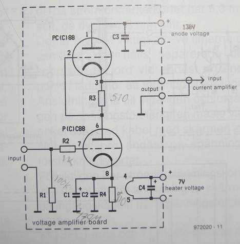

The PCC88 with voltage supply 138V ( should be within 130-140V )
and in SRPP configuration
and with those components as show in attachement here below
has got following performance.
(It should be noticed, that this is with a very light load.
I think the input stage of MOSFET current amplifier, in schematic in post above is very high:
Possibly 200k or more. Notice input coupling caps are 1.5uF only )
PCC88 SRPP.
Tube Input impedance: 100k
Voltage Gain: +25dB ( x 17.8 )
Input 0.900V RMS gives 16V RMS out ( 65W into 4 Ohm )
Frequency: 10 (0dB) - 100 kHz (-1.7dB)
Damping factor: 3.2
Supply Current at 138V: Less than 5mA, maybe this is <2.5mA per Channel
The Tube Input does not need any Input Capacitor, normally.

How much gain E88CC would give, compared to +25dB, I have no idea.
Anyway it has been said, that SEWA needs at least +20dB, = x10.
So I think PCC88 ( x17.8 ) would qualify, even with a bit more load, say 50-100kOhm load.
You better post that PCC88 SRPP circuit in my Tube Topic.
And ask the valve maffiosos!
Tube Pre Amplifier for SEWA 7 Watt ClassA MOSFET
I think tube guys would easily modify that SRPP schematic to fit E88CC.

O.K. I will post the SRPP there.
