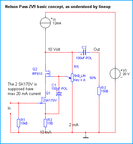

It might be possible to build a
ZV9 Pre Amplifier Clone
using for example 2SK170V ( max current 20 mA version )
and IRF610 or some smaller, TO-92, MOSFET
Of course we should try to find N Channel JFET
with high current for more linear driving of lower load impedances.
It is the same here as with TUBES --- you can not get too much current!
What you say, friends ?
... wonder if somebody else already tried this at home
It can be the most clean basic type, like in my attached image
or a clone of the Negative Feedback ZV9 version.
I have tried to use realistic component values
based on what I know of 2SK170V and IRF610.
But you may have to change values in my schematic.
Regards

Hi Lineup!
I still have some because I didn't want to build the ZV9 after the SEWA - ZV9 tests.....🙂
Greets:
Tyimo
What about to use the original Lovoltec JFets???Of course we should try to find N Channel JFET with high current for more linear driving of lower load impedances.
