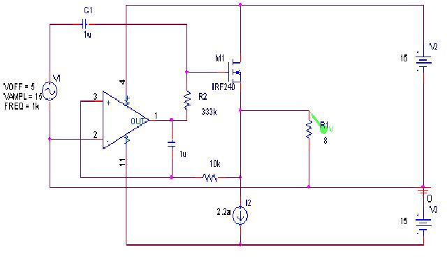

HI
I've been interested in the "power follower" idea for quite a while
I've done a headphone amplifier using that topology and modified it very often. (it use the irf610)
It's reasonable to think that the improvement I made in my headphone amp will translate in the sewa.
2 best upgrade I've done aren't present in the sewa...
1- get rid of the output capacitor. The use of a DC servo with op-amp do easely that job. (of course, you need dual power supply)
Using orcad, I draw the basic schematic of a DC servo.
the op-amp isn't in the signal loop and DC ofset should be less than 3 mV
Sorry, the picture isn't very clear... (I copy/paste using Paint)
2- the current source benefit from some more accurate topology.
the best one imho is done with the tl431.
http://www.fairchildsemi.com/ds/TL/TL431A.pdf
Look on the datasheet on page 6, figure 14 for detail.
