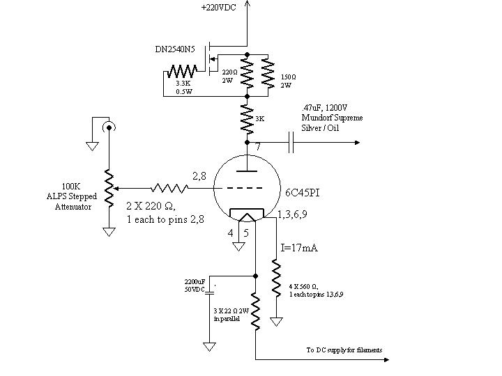

Hi MIKET!
Could you post your CCS loaded 6C45 schematic? I am looking for a good tube pre for my SEWA.

Thanks MIKET!
What do you think, is it not too weak to drive a Mosfet?
Has it +/-20V out put? (on +24V supply)

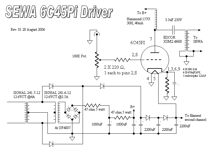

Re: SEWA
http://www.diyaudio.com/forums/attachment.php?s=&postid=912796&stamp=1147286502
Just some resitance to dampen gound loops. It has since moved to the powersupply in form of a thermistor 😉
hifryer said:OK, thanks.
what is the role of the 2R7 in the ground line??
cheers

Tyimo said:Thanks MIKET!
Greets:
Tyimo
The circuit as drawn will have no problem generating enough swing in voltage and will have a gain of about 30. The output resistance should be sufficently low to drive the MOSFET.
