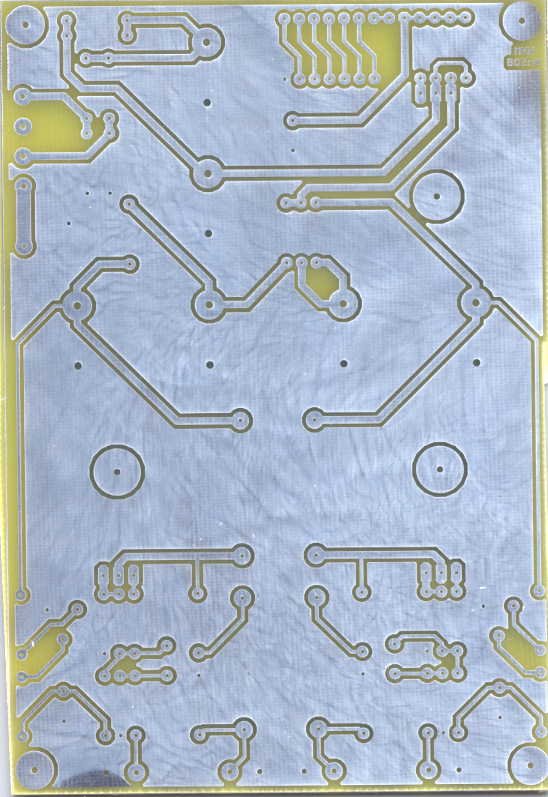

Professional BOZ PCBs?
I'm considering having really professional BOZ boards made. They will be in strong keeping with the original schematic, only with a little improved pre-reg filtering and a MOSFET regulator instead of the original hard-to-get bipolar. The pcb will be laid out for use with the original parts (usual PASS LABS industial quality). For the PCB spec I was thinking 35um, double sided (gndplane on topside), plated through holes and ENIG (Electroless Nicle/Immersion Gold) surface finish, black soldermask on both sides and white silkscreen on topside.
However, boards of this quality don't come cheap in very small quantities, so I am wondering if there are others that also want a board (or two 😉). Price depeds on the total quantity. I've gotten some preliminary prices: 10pcbs:34USD/pcb 20:21USD 50:14 100:11. If I could get at least 10 people interested, I would order 20 boards and expect the rest to be spoken for over time. Attached is the schematic I'm proposing we use and the pcb silkscreen with PTH's. PCB size is 92x135mm. 😉

DIY version of BOZ layout
I have optimized the pads and holes (drill-guides) for a singlesided diy version of this layout. Since all routing is on the solderside, this is enterely possible. The only mod that has to be done is to solder a piece of wire between the "-" terminals of of C1 and C5 to make the ground connection since the groundplane is compromised. Enjoy 😉
Mad_K's single sided PCB
Even a single sided PCB should be sufficent for a decent BOZ, by the way do you have any more SEWA PCB's. I'm planning a SEWA with 6C45 for the voltage amp in front of MOSFET's. The 6C45 will actually work well at 24V, should be a nice combination. I am presently using a CCS loaded 6C45 to drive a 300B and it sounds sweet. 😀

Yes the BOZr0-SS PCB's turned out nice. Very compact. I still wish to get the real boards produced though, som much nicer... When ordering professional PCBs there is not much difference in price with single sided vs double sided though.

If you want mono, you just use 2 boards and mount one channel on each pcb: The PSU takes more than half the board anyways. Input and output pots will not be included on board because this would make parts sourcing around the world difficult; it is best accomplished off-board anyways. If you look closer on my schematic you will notice I have included some extra resistors. I effectively have a voltage divider on the input, and you can scale down the input sensitivity by increasing R109/R209 and/or decreasing R107/207. So, you're up for 2 boards then? 😉
