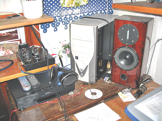

He,he I built that one about 16 years ago..But where I am going to use/test this amp is with my computer-modded audiophile 2496,allright I post a pic so you can se for your self.it has a "Brute force" linestageRyssen, you should try the Swedish REMUS preamp!
maybe it could drive the SEWA direct.But now I decided to make SEWA a hybrid.😀 😉
well if I use a ecc86 as voltamp and ecc88 as CF it might work.orI am afraid that a simple CF with ECC86 or 88 will be not enough to drive the SEWA because the Mosfet's high input capaticantes.
comments, schemas..😀
Computerstereo...

Ofcorse I will try the SEWA whitout any tubes,As I have 2 holes for 9 pin socket in my top,sure would like some glowing tubes there.😉I think the beauty of SEWA lies in its simplicity, and I think you loose it along the way
Maybe try if I can run the SEWA direct from the soundcard wihtout the
"Brute force" simplicity...
How much is needed in RMS?My sound card puts out 2v...maybee just a litlle tub in SEWA..Not much gain really, +/- 15V is 30V P-P which is dozing for a tube

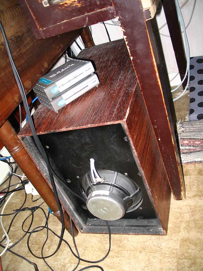

The sub is 2 x CA21REX SEAS,and PX17-LTS and Gamma ribbonspeakers,the sensitiviy is about 90db/w.Deepbass and clear top end.I used to power it with 6B4 SE and it sound fine.🙂

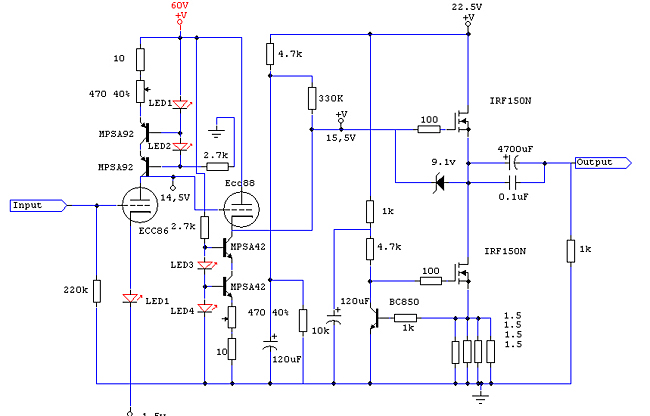

I´ve spent the whole night experimenting with ECC86 and mosfets. I tried BJT CCS loading with and without Jfet buffer, hybrid Mu-stage with Jfet on top, choke loading with and without buffer and nothing seems to be able to push a simple Mosfet power follower past 20kHz!
I guess ECC86 simply isn´t a good candidate for the job, and it´s a shame cause I came up with some really neat direct coupled hybrid amp topologies last night...
Since I have everything set up I´ll try PCC88 in the same circuits, it might or might not work better. I have my doubts though, tubes seems to like voltage and Mosfets require some current in the driver stage.
Fuling said:I´ve spent the whole night experimenting with ECC86 and mosfets. I tried BJT CCS loading with and without Jfet buffer, hybrid Mu-stage with Jfet on top, choke loading with and without buffer and nothing seems to be able to push a simple Mosfet power follower past 20kHz!
88 like current,but you'll not have much of current with this sissy voltage......🙁
I noticed that, yes.
I gave up on the whole thing, but right now I´m prototyping something involving mosfets, Jfets and chokes but no tubes.
tinitus said:All it needs is preamp with gain
But where do you put it? The last one Ryssen posted is a SEWA with a CCS loaded Foreplay-style (CC direct coupled to a CF) preamp in front.
