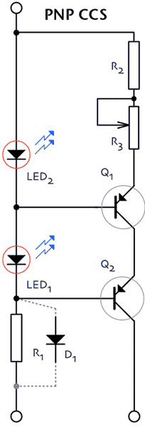

Ryssen said:Another onefor Planet10 to judge if he wants of course..🙂
The CCS is only 1 R away from the Morgan Jones inspired diyAudio Valve amp CCS... we have boards for those
dave
Yes I was inspired by S.Y..😀The CCS is only 1 R away from the Morgan Jones inspired diyAudio Valve amp CCS...
But will it work enough juice to drive the mosfets?
Opps,forgott to add a resistor for the Leds..

Yes, the MOSFETS need a little more current than the CCS or perhaps resistor loaded tube can handle? ECC88 is a good choice, since it likes current at low voltages. Must do some listening tests.

Should I use one?🙄 Thougt I get by without if I used the same voltage as the gate.How much current is nedded?Maybee squeze a little bit more out of Ecc86?😎@ Ryssen - coupling cap?

So 6mA with Ecc86 will do it then?😎 What about the couplingcap,if I use anodvolt of 15,5v as it is on the Sewa schema?5mA through driver stage is enough for this Mistfet application
If you're going 6mA, you've opened up more options - trioded 6EJ7 for example. Gain the same as ECC88 and just as linear, if not more and easier to get 🙂
Sorry, I didn't realize at the time ECC86 was a space-charge tube. I thought 30V was a typo 😉
The folks have mentioned 5mA is adequate for driving those plastic tubes, but the ECC86 specs show 0.9 mA as the average goings. Might fall flat without a CF or something.
Should I use one? Thougt I get by without if I used the same voltage as the gate.How much current is nedded?Maybee squeze a little bit more out of Ecc86?
If i run the ECC86 at 15,5v/5mA will it work to drive the mosfets?That´s 0,08w the limit is 0,6w.And can I paralell the halves of one ECC86 to get 10mA?If this does not work and I use ECC86 as a voltamp and add a CF what tube should that be ECC88?I´d like not to have a to high volt as I have done a box for the amp with to 9 pin sockets not to much room for an extra trafo.Many clues,Geek give me hint..😉but the ECC86 specs show 0.9 mA as the average goings. Might fall flat without a CF or something.
If you can get it that high at that V, great! Let us know 🙂
(I've had many ask about this and I couldn't answer them)
I experimented with many tubes as LV CF's and was disappointed. But I did not try an ECC88, so I say try it.
Miles Prower has had success with another MOSFET as the follower (OK, I said CF... whazza fet-follower called?) to drive a power stage. That way you could keep your DC coupling 🙂
