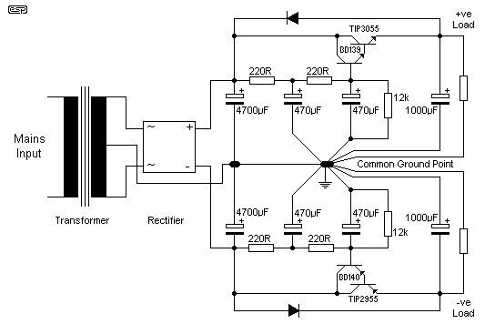

Capacitance Multiplying PSU
Just Ordered a SEWA and starting reading up on Class A stuff 🙂
I came across this article http://sound.westhost.com/project15.htm about this class A power supply option, has anyone any experience with such a design? Are they feasible with SEWA and deliver as it promises?
(Actually, i made up my mind and order the parts from digikey already, the idea that i could leverage capacitance 10X is too appealing to me)
Chuck.
Chuck.

Re: Capacitance Multiplying PSU
Large caps, large transformers and a large chassis/heatsinks is what makes a Class A amp for me 😉
Remember, you will also have to cool the regulator transistors.
25V caps are cheap compared to the increased price you will have to pay for bigger heatsinks when using a regulator. Maybe not so severe with the cap. multiplier you posted, but definately with a mosfet based regulator supply (minimum 8W dissipation per regulator)
Anyways, fans are very helpful in getting trafo/chassis and heatsink temp down from a undersized amp. I just don't like them because of the noise and compromised reliability.
Chuck.

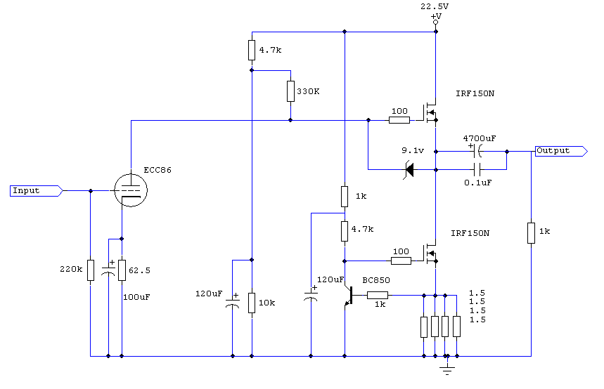

Maybee this has been up before,what is the input sens of SEWA?
It would be possible to make it a hybrid with a tube at the input?🙂
I mean with a tube like ECC86,like an experiment,havent assembled it yet I am finnishing the box.
Ryssen said:Maybee this has been up before,what is the input sens of SEWA?

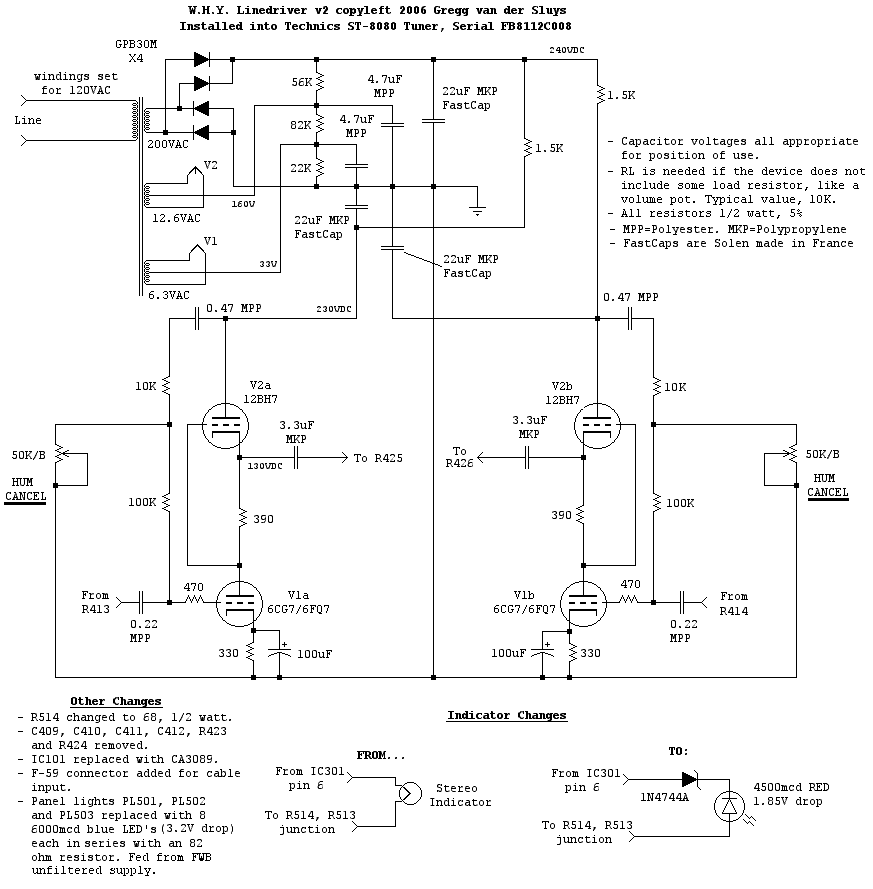

Already working on that... something conceptually like the attached but with a single tube per amp (6H23p/ECC88 probably) since my available trafos dictate mono-blocs
The circuit shown is the modified output stage -- the tubification of -- my Technics ST-8080 tuner.
dave
How are planning to do connect the tube, anode at C2 or direct coupling?I was thinking of ECC86 that can run on about 25v.🙂
Probably cap-coupled... this front-end has more utility than just the SEWA, and we have lots of the ECC88 family tubes lying around (and no ecc86).
dave
dave
