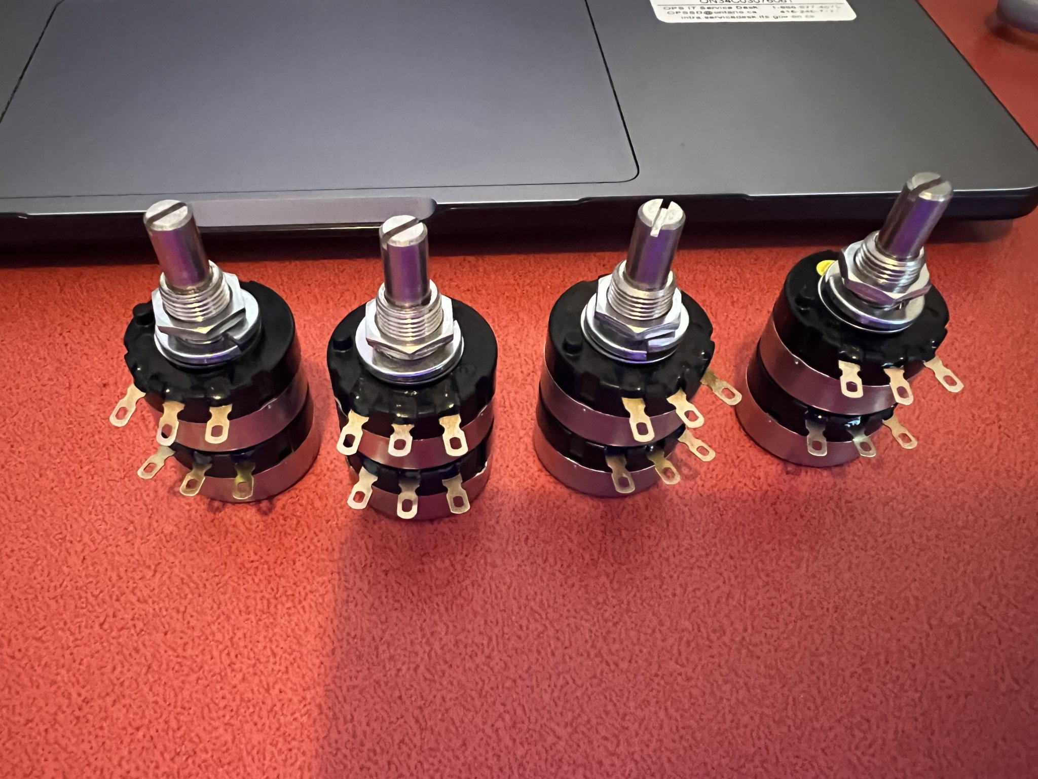

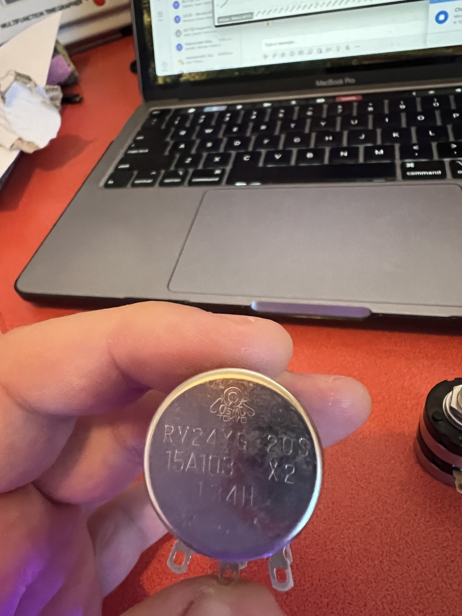

I received the Tocos Cosmos RV24 potentiometers today. I ordered from hificollective in the UK. They shipped from Germany. I ordered mono but received stereo. The site said they weren’t making stereo any longer due to the difference in db between left and right channel. But I received stereo anyway. I will wire them mono.
Super smooth operation and nice and firm

You have four Cosmos stereo pots - should measure them to see if they track both channels correctly - maybe they do.

I tested one of them. On a 10k pot, they are several hundred ohms out between the two channels. Percentage wise that one was about 3.5%, so if there is 40db of control, I guess that is about 1.5db. I know I can detect 1 db increments on my DAC volume which goes in 1db increments.You have four Cosmos stereo pots - should measure them to see if they track both channels correctly - maybe they do.
