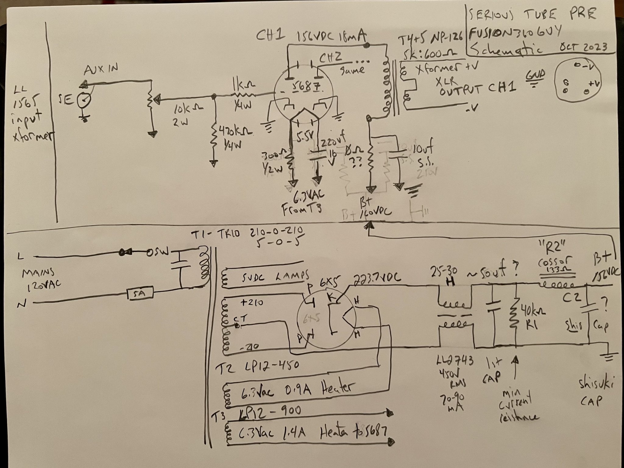

I think I'm closer on the schematic after working for more on it and getting advice. Also here is a screen shot of the PSUD I am trying to model. I get close to proper voltage. I am guessing at impedance of the used TRIO power transformer and stuff. Also on the schematic removed the 5k resistor at the input to the output transformer as we dropped the voltage on the PSU side before that I think. I drew it in as a resistor with 0 ohms to remind me it used to be there in the Japanese circuit we started with. Tried to draw in the black magic choke stuff based on some emails from the power guru.

You should check how much current draws R1 shunt resistor ( first after the choke ) and see how much power it burns to size it in Watts properly.
PSUD - change the rectifier configuration to full wave - on the picture is half wave ( assuming You are using transformer with Center Tap - also 6X5 rectifier tube is for full wave rectification - as drawn in Your schematic ).

Thank you @krca45 . Now I know full wave vs half wave means centre tap. But i can't make PSUD insert a dual coil input choke as I have drawn in my circuit. Today I'm going to start reading the building valve amp books. The power stuff is mind boggling to me.

What is the point of a 0 Ohm resistor?
Do not guess at the resistance of the primary or secondaries of the transformer. Measure them with an ohm meter. Same for the choke.
You do not need to be able to insert a resistor onto the 0V or "ground" rail of the PSU. If you want a resistor on the "+" rail and the "0V" rail, these can be considered as in series and can be represented with one resistor in PSUD.
E.g., two resistors, each 50ohm, equals one 100 ohm resistor.
Look at DHT Rob's guidance on how to use PSUD. (Google that name and PSUD.)
Your primary checks will be voltages at capacitors, not the transformer.
What is a dual coil choke? Can it not be modeled as a single choke with a definite inductance and DC resistance?
You should know the total current draw of your preamp circuit. Use that (current source) as the load on the PSU in PSUD instead of a resistance.
