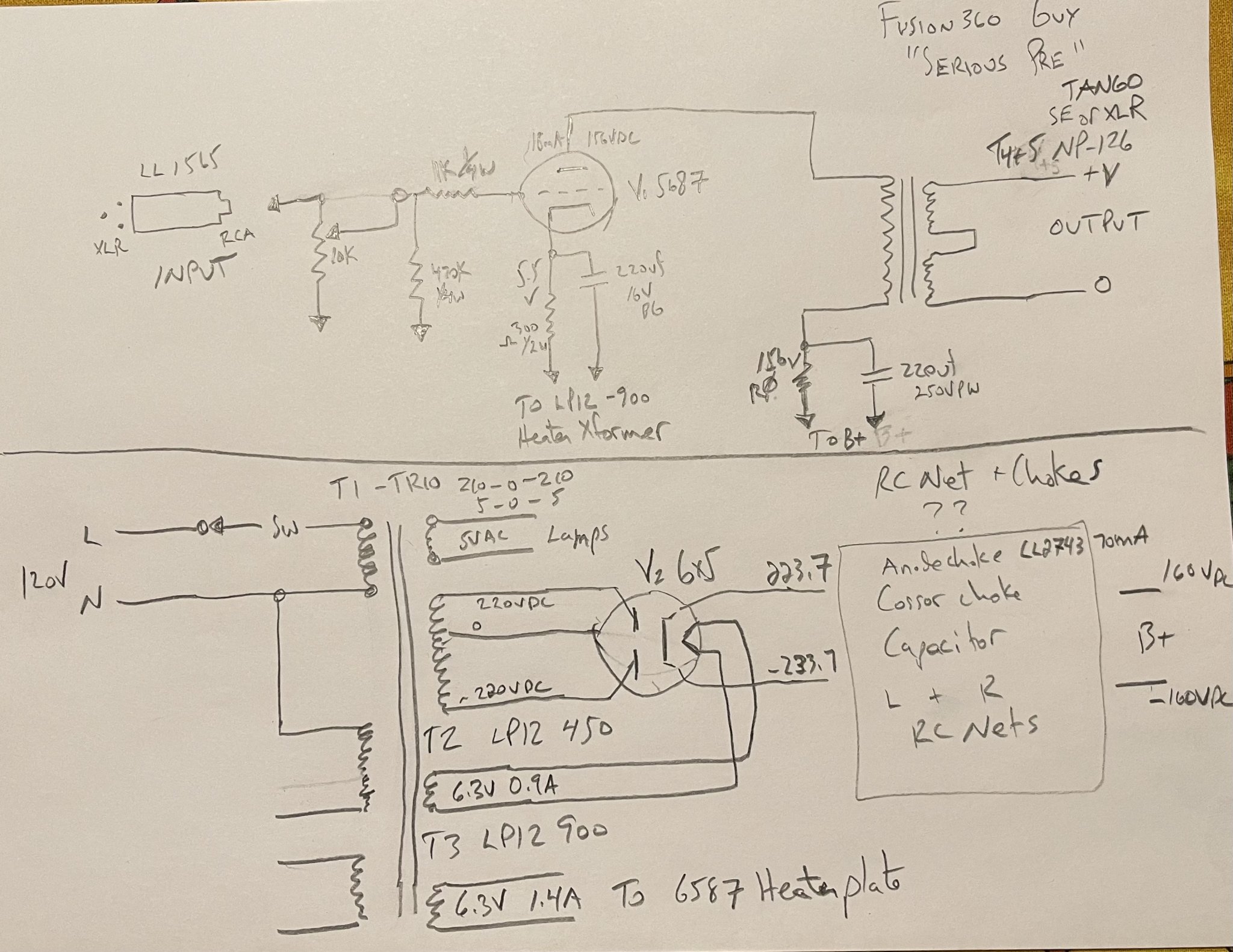

Hey all, Don't build it like this or you will hurt yourself. It is incorrectly drawn. I asked moderator to delete but they said just to flag it like this.....Here is a very crude schematic. The 5687 is a dual triode and can support two channels if wired correctly. That is my plan. The chokes and RC Net is a black box to me, but I'm working on figuring it out. I've put in the black box the components that will go in there. There is also rectified wiring to support two lit up Voltage and Amperage meters. I haven't shown that wiring - just the secondary tap for it.
DO NOT BUILD LIKE THIS. The original japanese circuit is good. I am just trying to draw in the modifications I am making to it, but don't yet understand how tube schematics work.
Thanks.
I'm not seeing what will cause the explosion, unless they're referring to the negative power supply rail? (That should just be marked "0V").
My only other advice is that you likely won't need a 200V secondary on that transformer. 200 * 1.44 - 22 = 268 V. That formula is just a rough guess at the voltage you'd have coming out of the 6X4. If you want ~160V for the 5687, you'll have to drop ~100V. That's way more than you want to deal with, as you will just have to burn all that voltage off as heat for no purpose whatsoever.
@Thekak re your first comment, I believe yes this is the big error. i should have joined at centre tap and indicated zero on the bottom rail instead of minus B.
Re second comment, I think that is the "choke input filter" that will go onto the PS to reduce that voltage as it's more than needed. I am still working on how that black magic works. As I understand it there will be a resistor across a lundahl LL2743 choke configured as a choke input to reduce that voltage and current.
Does that make sense to you? I'm about to draw it out from what I understand the parts I will have soon will be wired.

Choke input gives 0.9 x Vac, so 200Vac becomes 180Vdc less the rectifier drop and RC filter and voila, 160V.

That transformer should work fine. You have enough B+ to use a regulator. The heater winding is probably 6.3 VAC. Your voltages will be a bit high at 120 VAC, and I have measured over 125 VAC at times from our mains.
See if a program called PSUD is still available, it's good for figuring things out and "what-ifs".

That all makes sense. I've never tried a choke input power supply but have always wanted to. The resistor across the choke ensures minimum current draw for the choke at all times. I believe the term is "critical inductance." The resistor is there to provide a load so that the LC circuit always stays in regulation.@Thekak re your first comment, I believe yes this is the big error. i should have joined at centre tap and indicated zero on the bottom rail instead of minus B.

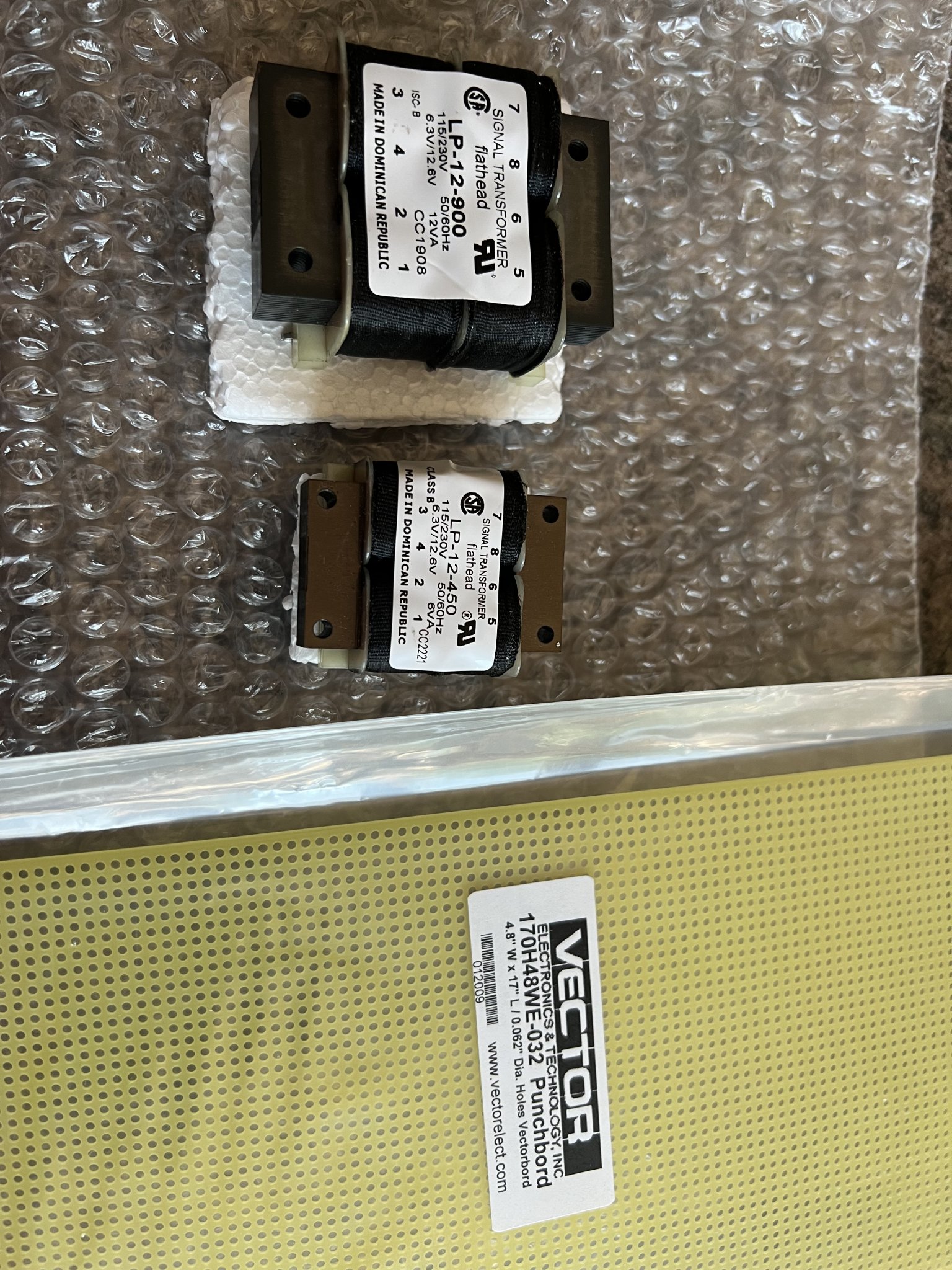

Yes. My heater windings are here from mouser....LP12-450 for the 6x5 rectifier tube and LP12-900 for the 5687 signal tube.That transformer should work fine. You have enough B+ to use a regulator. The heater winding is probably 6.3 VAC. Your voltages will be a bit high at 120 VAC, and I have measured over 125 VAC at times from our mains.

The resistor isn't "across the choke" but after the choke to ground. I think that's what you meant.The resistor across the choke ensures minimum current draw for the choke at all times. I believe the term is "critical inductance." The resistor is there to provide a load so that the LC circuit always stays in regulation.
Hello,Also use PSUD2 to design the power supply. Highly recommended. For manual calculation, you can find guidance at https://a-direct-heating-triode.blogspot.com/2018/06/lcr-phono-preamp-part-3.html
I'm seeing signs of over-fetishization of specific types/physical "sizes" of capacitors and transformers even before you understand where you are going. Maybe you and your friend have a lot of money. If so, you are free to spend as much as you want. But IMO there is no reason to go nuts about capacitors or the output transformers.
I don't know where the 10uF caps you are intending to place on top of the chassis are supposed to be in the schematic. Highly recommend that you don't go crazy and over-fetishize specific capacitors and aim for something which will fit inside the chassis and simplify your life.
Also, are you drawing a + 160V supply with a -160V supply? Why do you need a +/- supply here?
