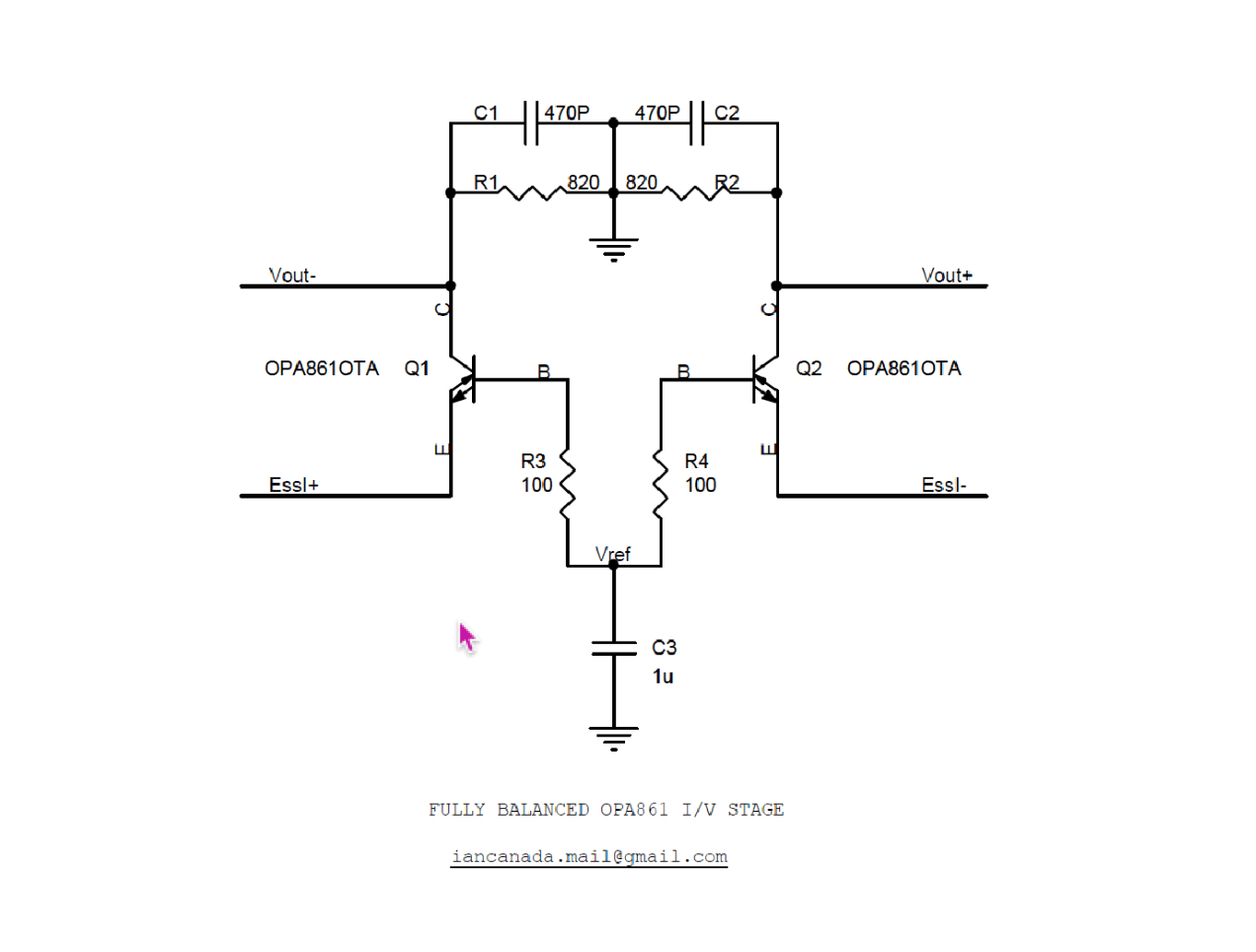

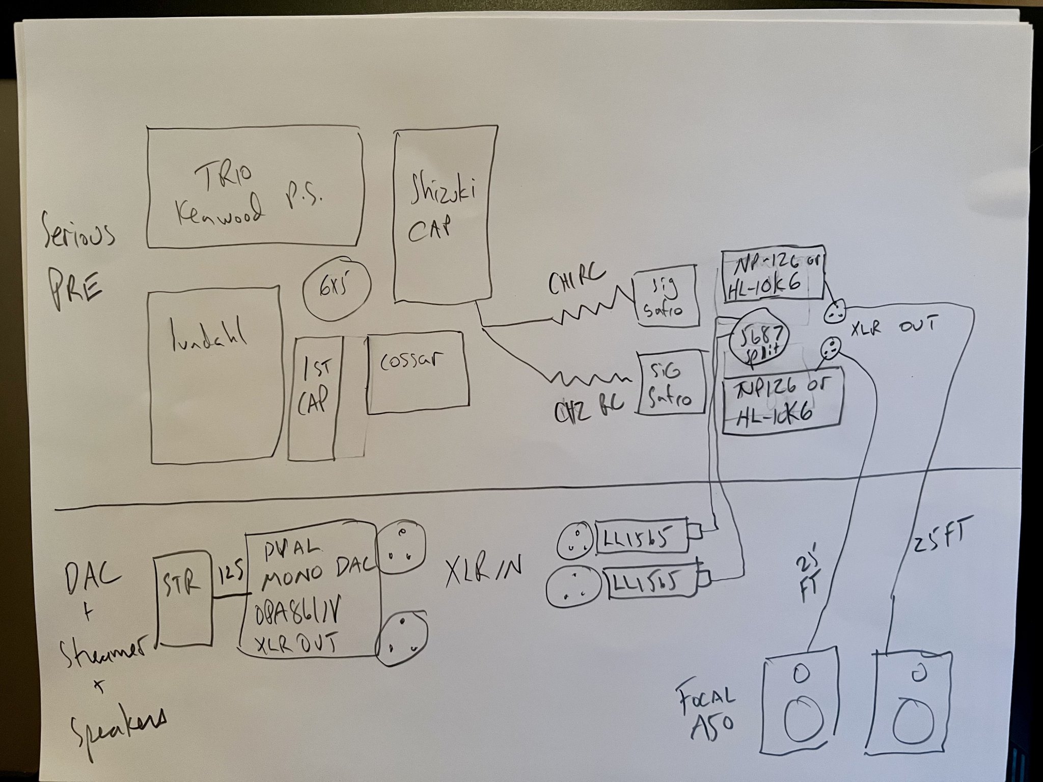

Here is my stage IV output board that is attached to the DAC I built. It is powered by a dual linear power supply to provide the differential voltage +5,0,-5 for the outputs.
Currently this is plugged straight into my Focal Audio A50 powered studio monitors via 20ft XLR cables. It can pretty much "blow out a match" now without any pre-amp. There is zero noise on it. I can play a silent test track at 0db full output from the Dual mono DACs and there is absolute silence with your ear right at the speaker. It's the best sound I've heard in my short life. I've got the DAC clocks powered by ultra capacitors. I've spent about $2500 on the DAC and Streamer half of it on power side of things and hi quality clocks. Every step of the way, I could hear the sound quality improve bu adding better power, better clocks, FIFO, etc.
The idea is to put the tube pre in between i) because I can and ii) because everyone says I am still missing something, and III) because it's an awesome project and I will learn a lot. it's the most "analogue" DAC i have had over past ten years (others were commercial Cambridge Audio units), but I still find some ever so slight harshness sometimes.......thus go tube for the final stage even if it is unity gain from the Output board below.

- Zero feedback
- OPA861 transconductance amplifiers work in two channels fully balanced configuration
- True current input mode with impedance less than10 ohms
- 80Mhz high bandwidth and 900V/us slew rate. This ultra-high speed performance would be great for an ESS DAC running by high frequency MCLK from 20MHz to 100MHz.
- Power supply: External +-5V power supplies
- Balanced output levels: 4VRMS @ 0dB
- Current input DC offset voltage: 1.65V
- High precision low noise thin film metal resistors

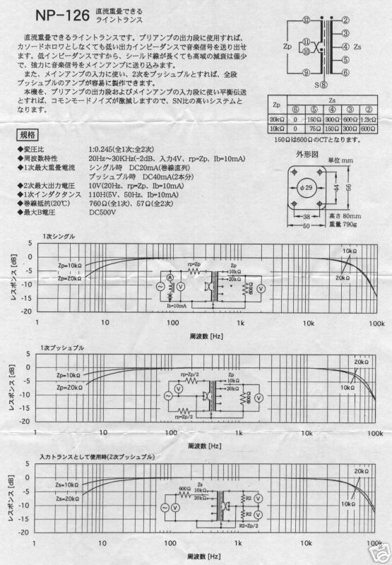

Would I need the HL-10k-6 to get 5k/600ohms wired parallel primary?
Look at link. If I order outside EU from acoustic D, price is in yen (24800), which converts cheaper in USD than the $250USD from tubeusa site. I am in Canada!
But I would probably be hit with import tax in either case actually. Even when I order from USA I get zapped with 13% tax. Such is "free trade".

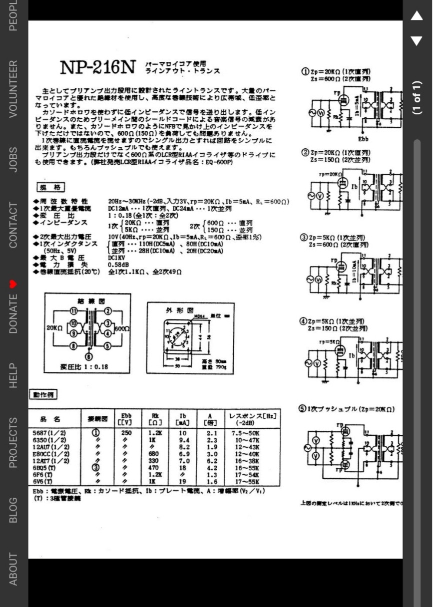

Read what it says below diagrams - primary impendance 20K ( primary in series ).... and this is what the first diagram shows - the dots are imporatant for phasing and therfore for wiring in parallel or series depending on what You need. Lower diagram is parallel wiring if Yoy look closely.
Hello,
He will need 5kohm so the lower diagram will fit. So 20K in series and 5k in parallel.
But Iso/ Tango datasheet np126 is mentioning 20K and 10K
And Tango np216 is talking about 20k or 5K
So we need the knowledge base on this website or someone with better eyes than an average Japanese technician.

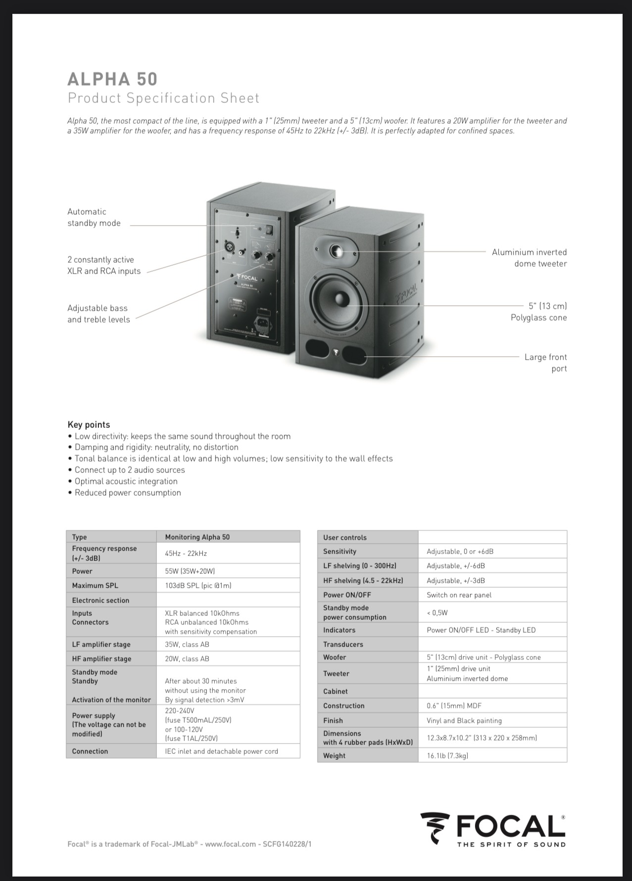

I looked up your powered speakers and don't see a published sensitivity spec. The 5687 will likely provide way too much gain at full blast. Something to consider will then be the quality and type of potentiometer in use for the preamp. You'll want something good so that you can have it turned down fairly low but not be impacted by balance/noise issues that are more common with cheaper pots.Here is my stage IV output board that is attached to the DAC I built. It is powered by a dual linear power supply to provide the differential voltage +5,0,-5 for the outputs.

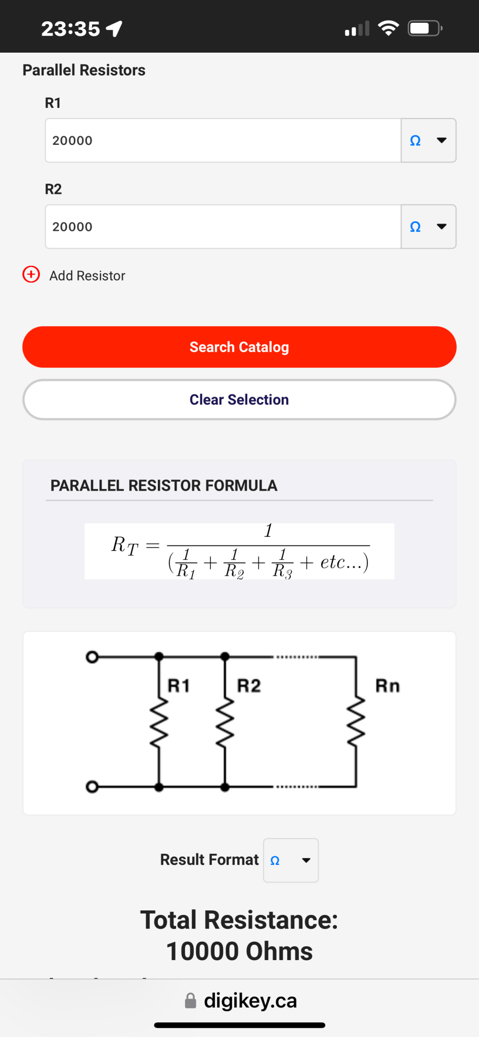

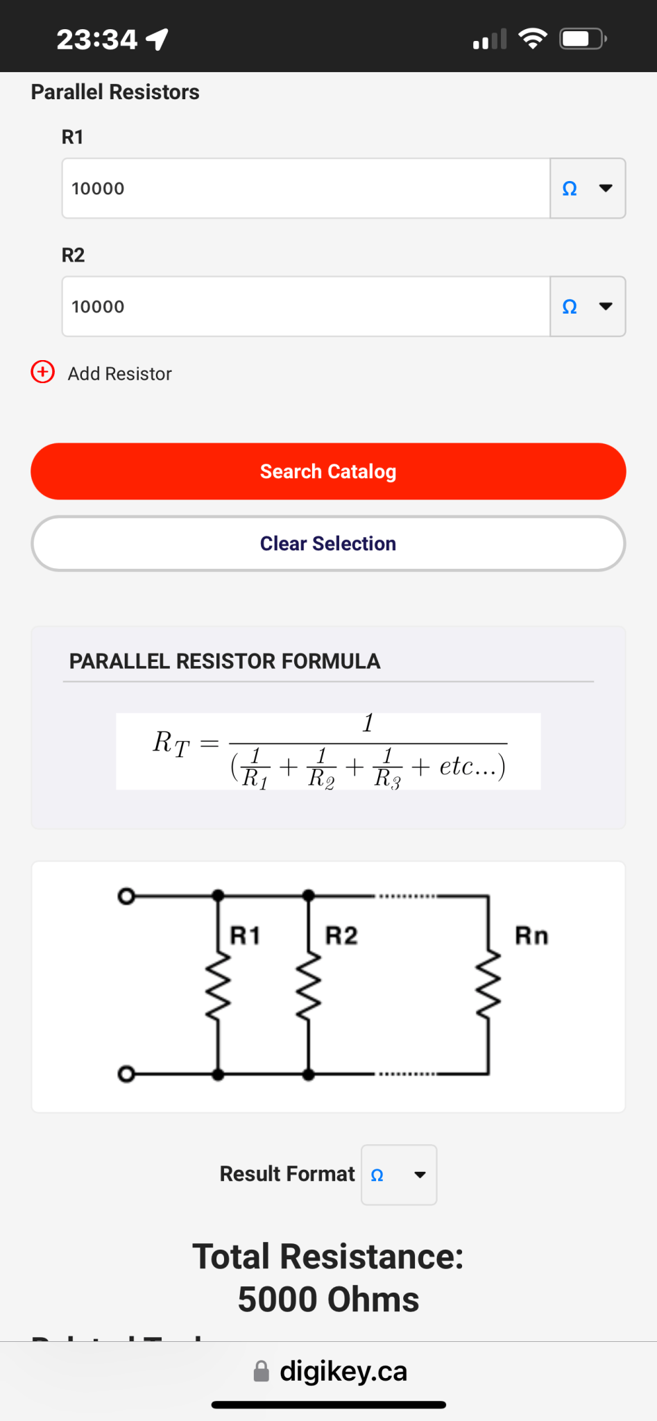

Hmm. I thought this formulation would apply but maybe not. Two resistances in parallel??Hello,
Greetings,Eduard
I think this is the only thing I have left to add to the discussion:
Building a preamp gives you the ability, at a later date, to replace your powered speakers with a pair of passive speakers and an amplifier. That amp could be solid state, it could be vacuum tube.
If you never make the leap to passive speakers + amp, however, I think it makes more sense to build a line stage. Obviously that's a pretty big curve ball at this point but it's true. You don't need gain; you just want some vacuum tube character introduced to the equation. Your powered speakers give you +6dB gain and I think that's a common range for a line stage, too.
If you intend to add headphone out, though, that is a strong argument for the project, all that said.
Hello to the city of Belgrado,Read what it says below diagrams - primary impendance 20K ( primary in series ).... and this is what the first diagram shows - the dots are imporatant for phasing and therfore for wiring in parallel or series depending on what You need. Lower diagram is parallel wiring if Yoy look closely.
Indeed in series 20k and parallel 5K at Hashimoto and Tangp np216 datasheet.
But at np126 they write 20 and 10 K .
I know that just like putting two 20H chokes in parallel will not give you ten but five H so it must be an error on the Np126 sheet.
Greetings,Eduard
