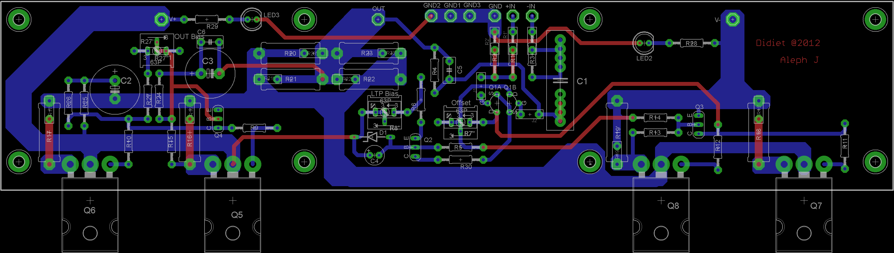

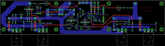

Questions: What is the reason for the parallel resistors r5/r6?
That is R5 4K75 in original scheme. I read in Aleph J thread that this poor resistor dissipates 380mW. In my simplified ltspice CCS experiment (which could have errors) it dissipates 318.5mW. Still a lot. When I start my first layout ever last year, ZM suggest to make it two 10K resistors. They will form 5K in parallel. Board could fit resitors like Dale RN60 /CMF60. Togeter they will dissipate the heat no problem.
To make a 1/2W 5K resistor, it appears...
:yes:
Ok that make sens. Maybe I should build a simulation and observe a little bit more, still a newbie at understanding circuit..
Another question 😀 What about c5 c6? I know they were not in the original design and I have read somewhere that if they were to update the store board they would delete those. What have convince you to put them in ?
Me too. 🙂
In short. Better sleep. 😀

If I understand it correctly (and I am not 100% sure) those 0.1uF film caps could help trap HF current on amplifier board.
5p is most likely necessary, so called Lag Cap, anti-oscillation thingie
without that one, most amps are becoming anti-social thingies, itself
other one is bypass cap for Aleph CCS modulation, in my book also necessary one

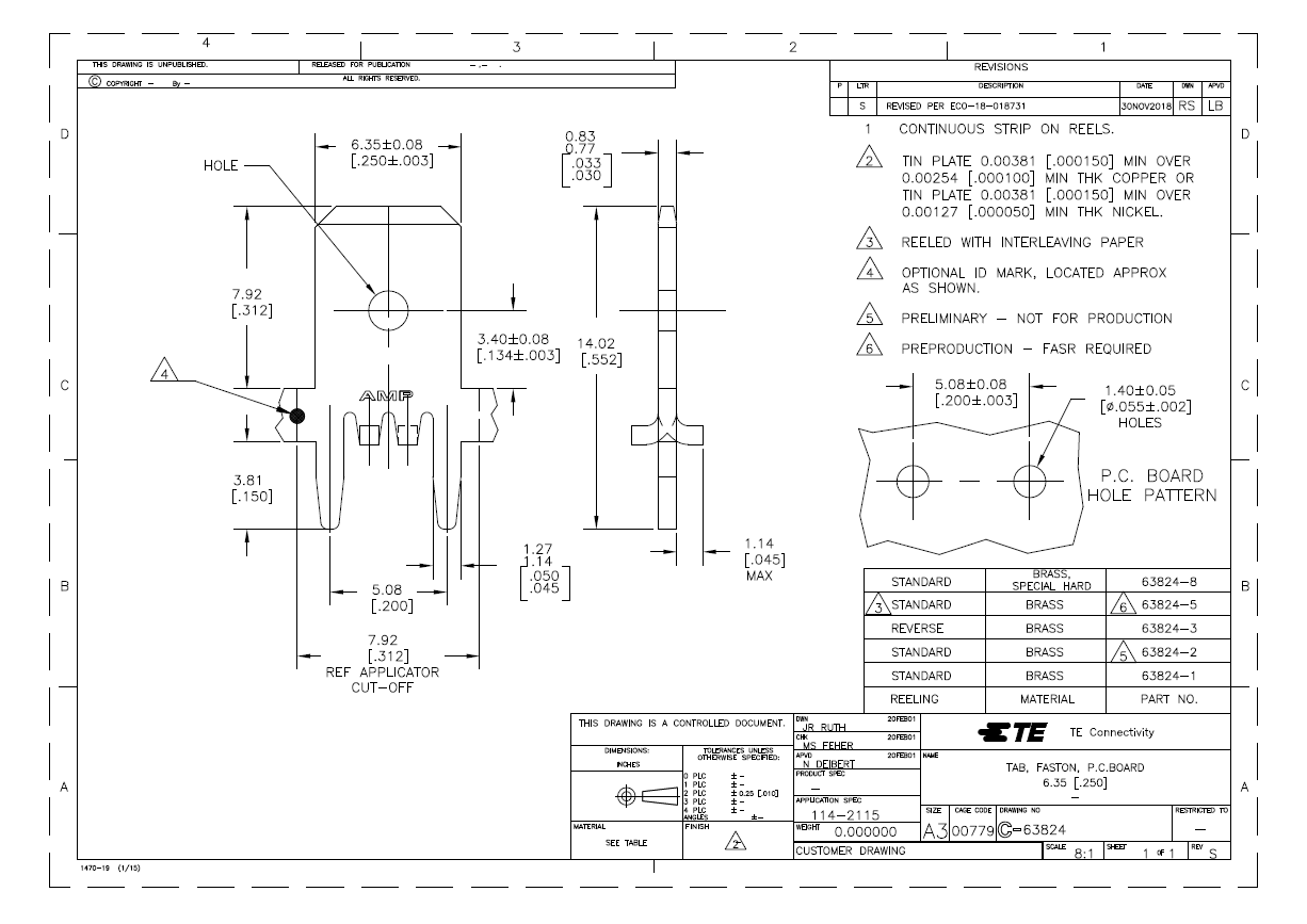

I have a question about Voltage/Speaker inputs/outputs.
Right now those pads have hole pattern for Fast-On blades.
1.4mm holes dimension and 5.08mm between holes.
Should I add a hole in between for say AWG 16 cable?
What are the max conductor dimensions of a stranded AWG 16 cable?
Fast-On blade still would have better overall contact place.

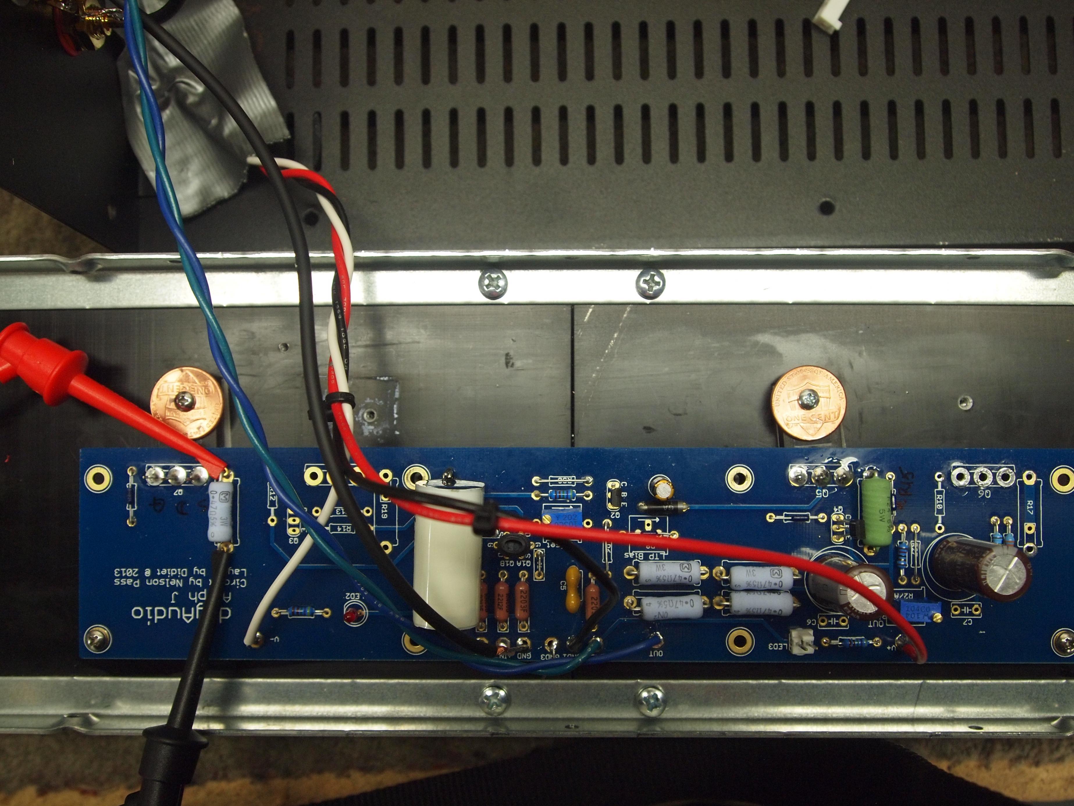

OK, I have something screwed up and would appreciate another set of eyes taking a look.
I'm attempting to build Aleph J with the SemiSouth devices generously donated by Mr. Pass.
I'm using the DIYAudio store boards. Populated as per original schematic except deleted Q6, R17, Q8, R12 and Q3, R13, R14.
R16 is .24/5W Q5 is IRFP240. Q7 is E120R100
Using J74 as LTP. Q2 is ZTX550 and Q4 ZTX450. I've re-checked the pinouts.
Voltage across R8 is 8.3V across R7 is 1.4V and across R9-Q5-R16 is 4.7V
Bias across R18 is .35V
The problem is that the offset is 19 V (not mV). I can adjust using R7 but the bias voltage rapidly increases. R27 seems to have no effect on bias.
I'm sure this must be something obvious and I've looked several times but can't find it. I've read hundreds of the pages of the Aleph J thread and all the pages of this thread(Aleph J with Semisouth). The answer may be in there but I can't find it.
So it will be helpful to have another set of eyes.
Schematic and photo attached.
Thank you for your time and assistance.

looking what you crossed in schm, everything done fine
though, if you have positive offset, that means lower mosfet ( SS) is still closed, insufficient positive voltage at gate, ref. to source
with smaller source resistor in Aleph CCS , R27 value need to be substantially smaller than in case with original 0R47 in place of source resistors (Q4 asking that it's base is at ~0V65 more positive than it's emiter, for its duty)
first solve that, limiting current there ( say 10-15K) , then go further
you'll most likely need little more than 1V4 across R7 too, so if there is 1V4 with trimpot maxed, put 330R in series, or use next value of trimpot
Relative to the suggestion about jumpering R11 to R12: On my board, R11 is connected to R12 and that is connected to drain of Q1A of the LTP. I think this trace is hidden in the photo shown by Rainfallsky

Excellent. That gives me some more options to try. Thank you.
