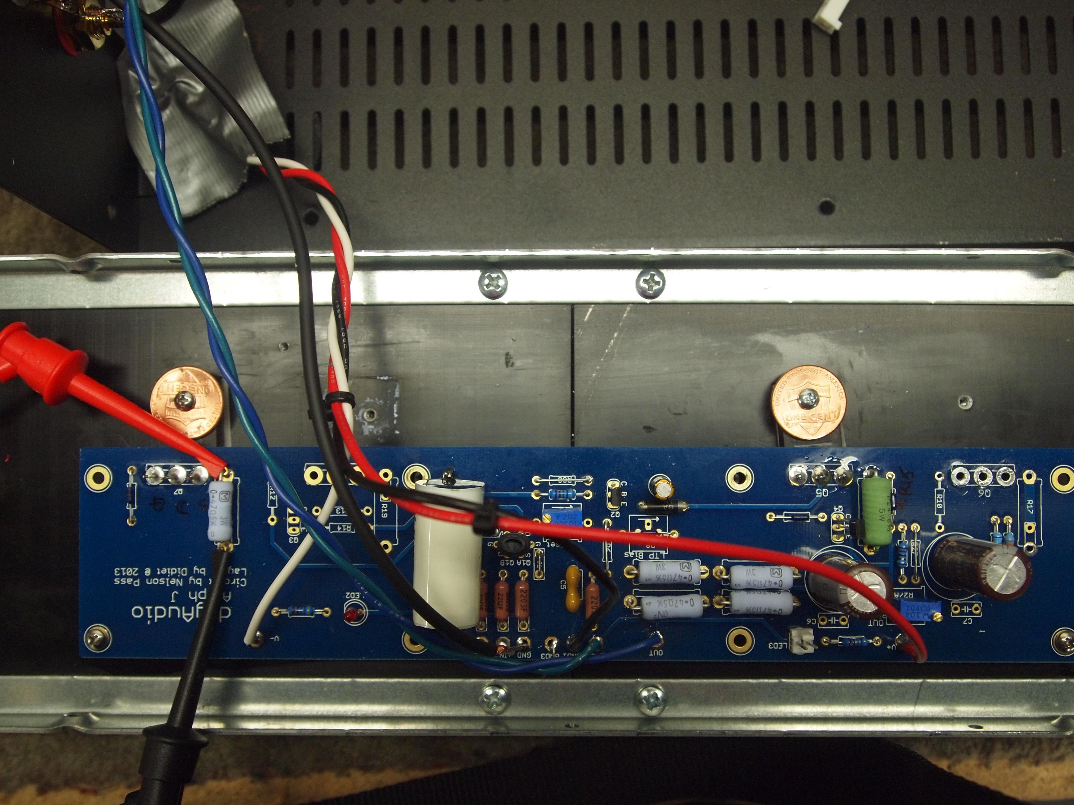

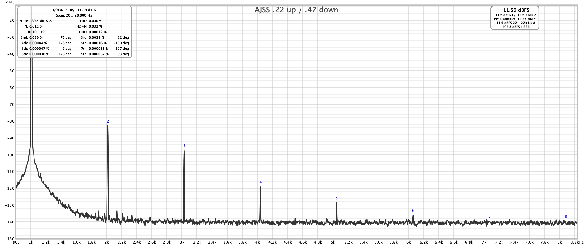

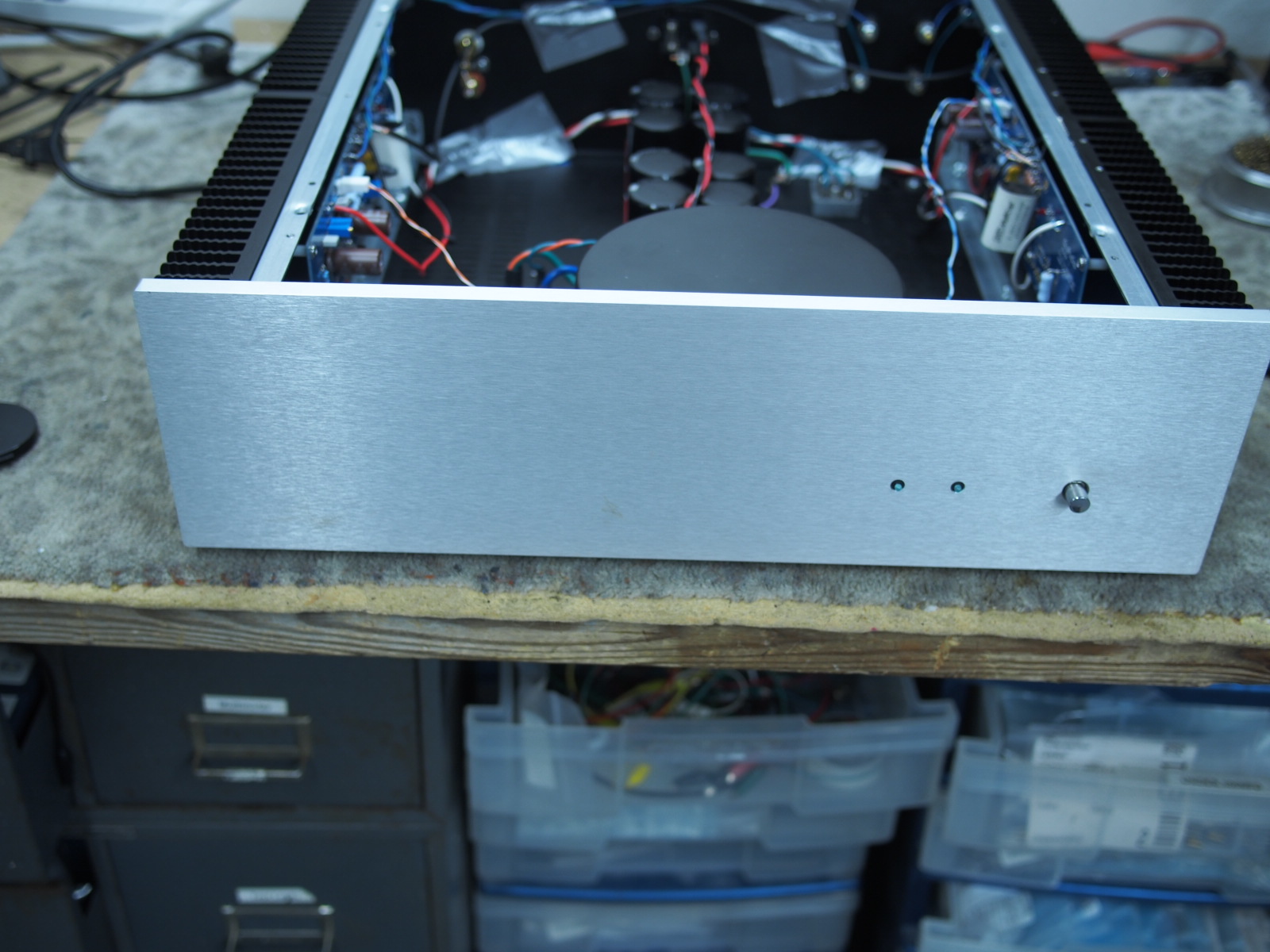

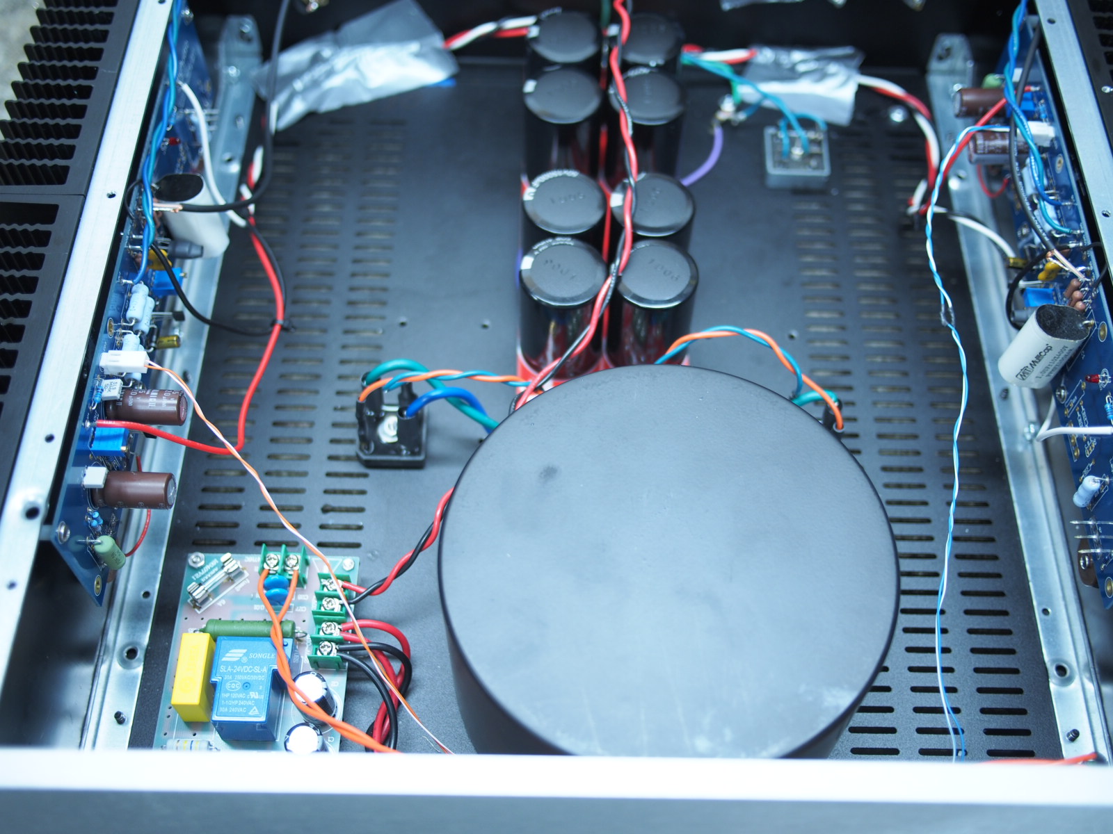

All done. Installed in a system and sounds great. Thanks to Mr. Pass for the SemiSouths and Cody for the distribution. To ZM for getting me over the finish line.
I put this into a system with a newly completed Stasis 2020 amp. Some differences in sound. The most interesting difference being that the bass is a bit more pronounced. Bordering on too much emphasis. But it's very enjoyable listening. Now I think I'll have to buy/build some switches so I can easily swap in/out my growing collection of Pass amps... and more on the way.
Here's a couple photos. Notice my 2 cents worth with regards to securing the transistors to the heatsink...
Congratulations on getting it up and running! Thank you for your observations about the sound, it seems to reflect Cody’s observation as well. I wonder if the balance of the frequency response/sound will even out after a break-in period? I distinctly remember that my Aleph J build was a little bright sounding for the first month or so while it broke in, then mellowed out and is by far my favourite of the amps I have.
Yeah, that sounds accurate with my observations. For me, I hear a bit more clarity (less distortion, most likely) and more cojones, bite, speed, grip (whatever you want to call it) throughout the bandwidth. Definitely noticeable in the bass, but I've not found it overwhelming – in part because I use smaller speakers and rely on a powered sub for the lower frequencies and tune to taste.
