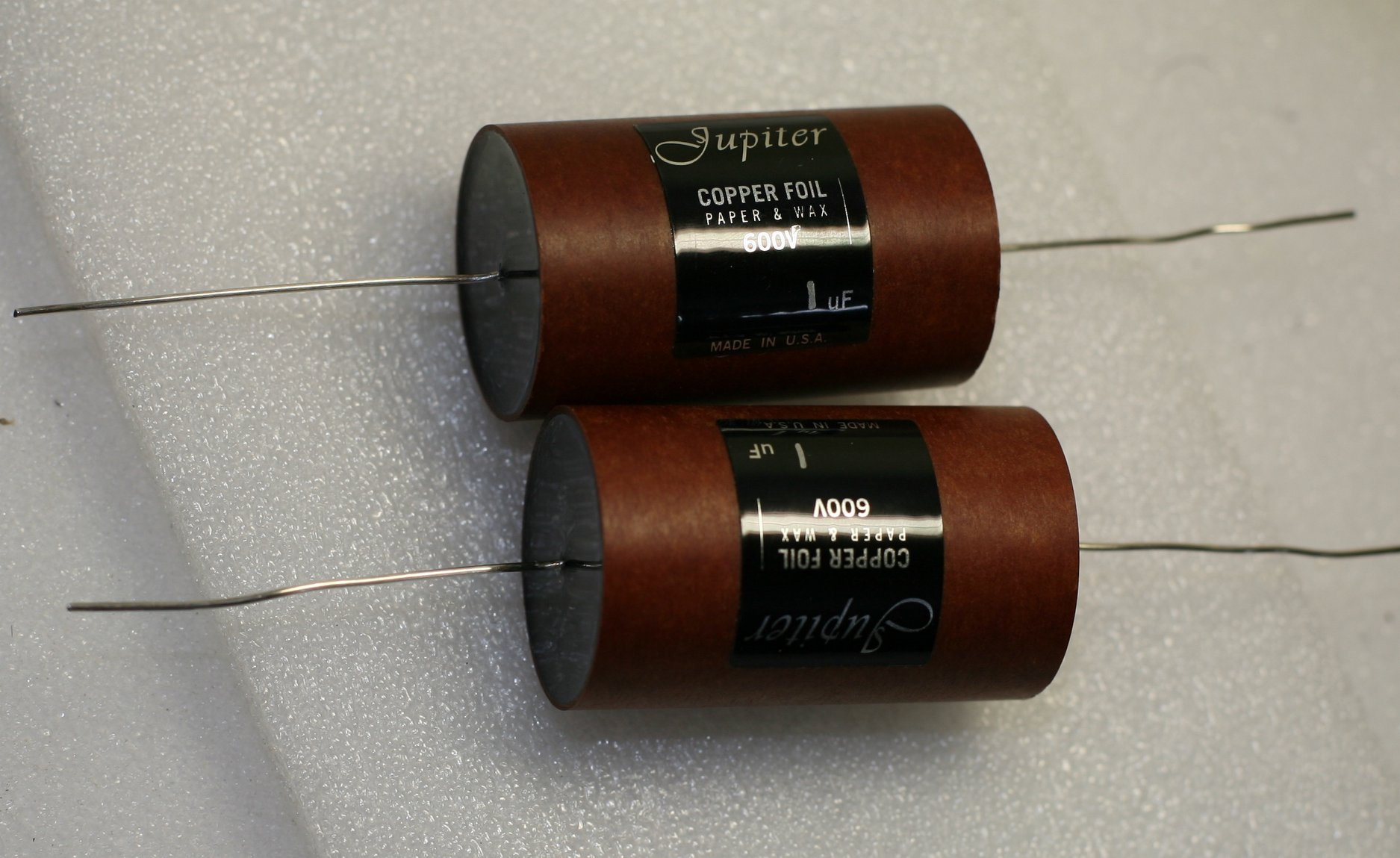

Semisouth Aleph J?
Aleph Jupiter sounds good (or god) 😀
There is a place for big axial capacitor on the right side.
Dimensions exactly for this one.

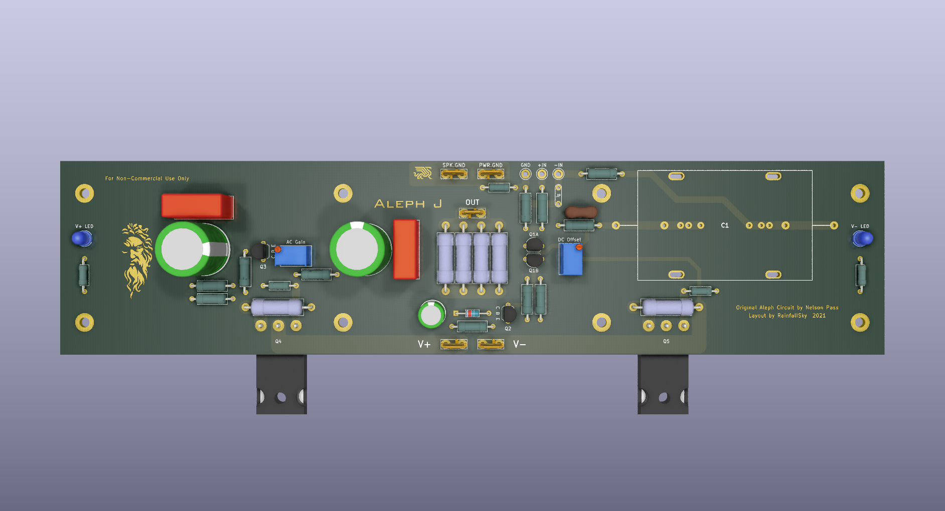

I read this guidelines from another thread and got nervous my V inputs are too far from each other.
So here is a new udates in attempt to improve layout.
V+ and V- input distance reduced from 160mm to 11.42mm
High current wires now can be less scattered across the amplifier case.
High current grounds now marked SPK GND (Speaker Return) and PWR GND (PSU Power Ground).
Maybe I should rename SPK GND to SPK RET, SPKR or somethin like that.
I can't find myself big flaws.
Other than small polishing I think layout more or less settled.

Looks really nice. Is the AC gain pot controlling bias? Or is it for tweaking the ‘ac gain’ of the Aleph CSS?
I saved this quote of 6L6 in my notes about this pot: "Aleph CCS current gain, but also will set the output stage bias".
But he also have a fresh comment about this pot in another thread.
Remember that playing with the “bias” pot in an Aleph is actually changing the AC current gain of the Aleph Constant Current Source... in English, that means the adjustments are doing more than just changing the Iq (quiescent current, ‘bias’) of the output devices... it also changes how the CCS reacts to the load.
I.E., experiment with it, yes, but go in knowing that more Iq may not be “better”, and that the recommended starting value is the AC current gain that is the sweet spot in terms of most listener’s preference.

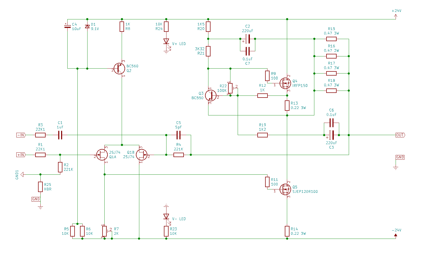

I understand. Its the pot labelled as 'bias' on the store boards. I asked because I have some boards that use a pot in place of R24, which is another way of impacting the gain of the Aleph CCS. The one labelled 'Aleph Gain' in the attached snippet.

Scheme of this board from KiCad in attach.
Pot is R22 in the scheme.
