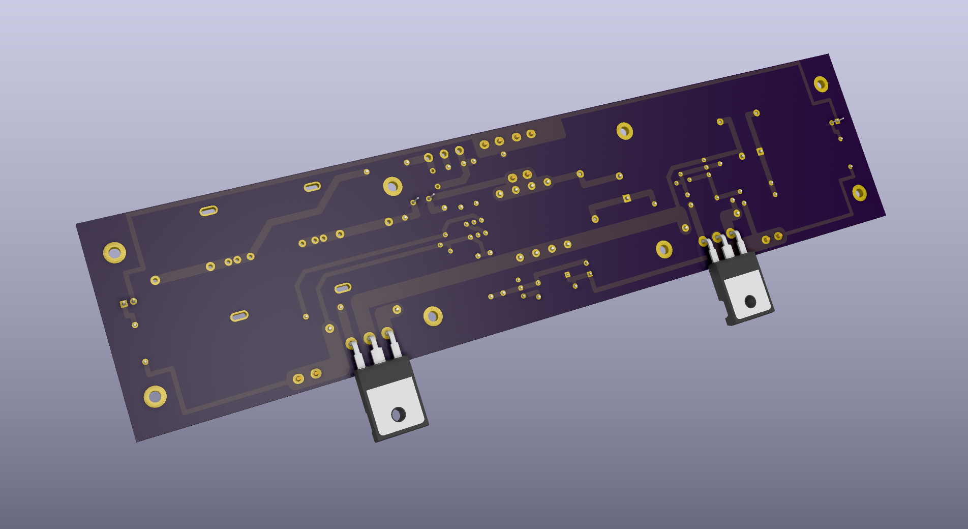

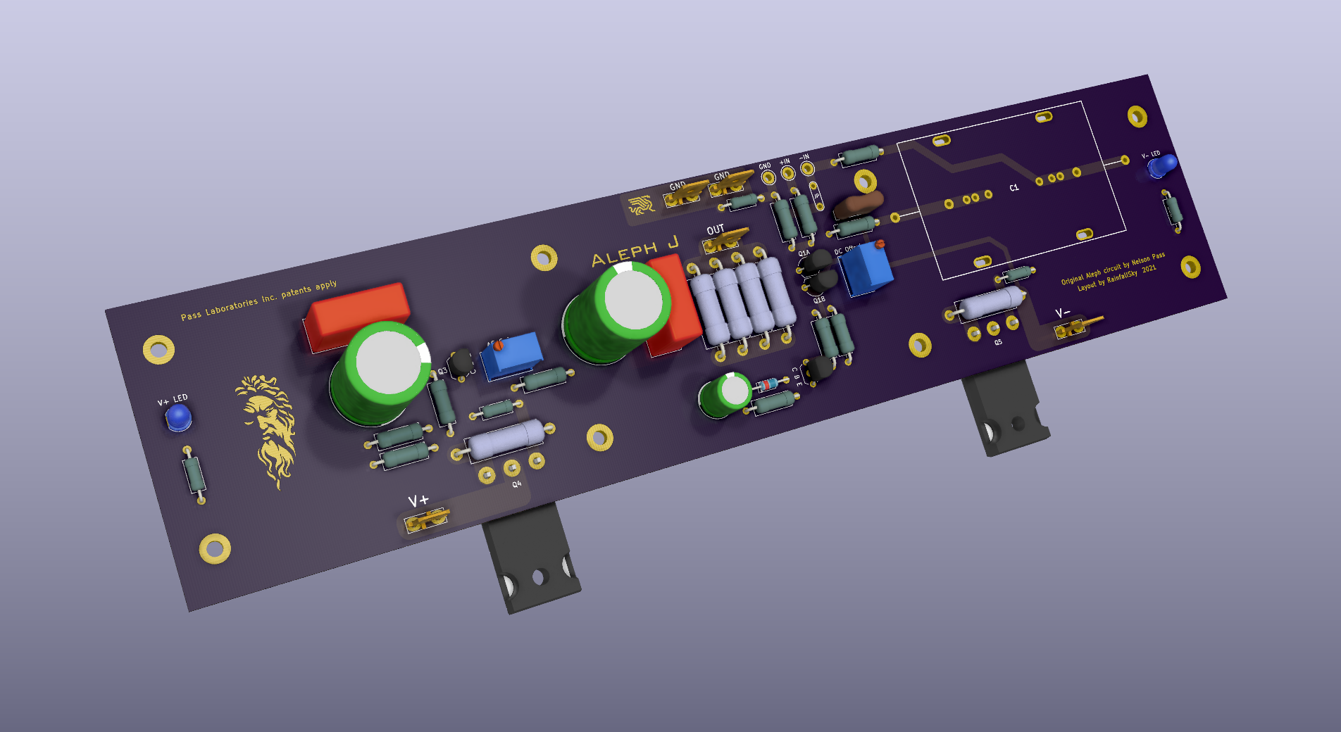

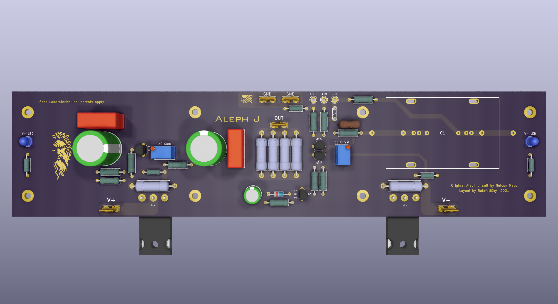

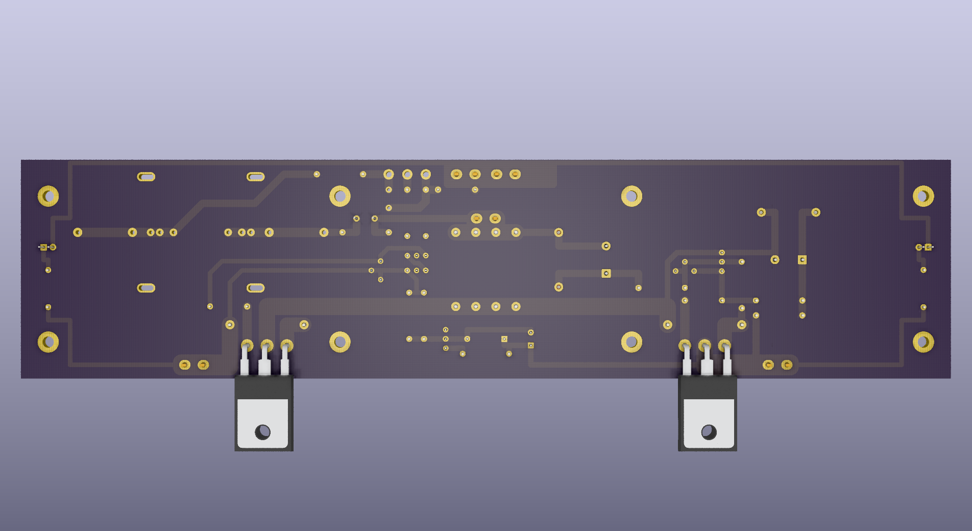

Layout so far. DIYAudio UMS heatsink compatible, 3U or bigger.
Same layout as befor but with a few changes and added Hum Breaking Resistor sugested in another thread.
Overcurrent protection removed. (It was also removed in previous layout too)
Zen Mod suggested double power traces on both sides.
Some are doubled now.

Looks good! Is that ‘Nelson, the God of Class A’ depicted on there? 😀
Naaa... too short hair
Thanks for the info, Codyt!
It's Zeus. And he is there for no particular reason. 🙂
You could also call him Jupiter or grumpy hairy bearded old man. 😀
