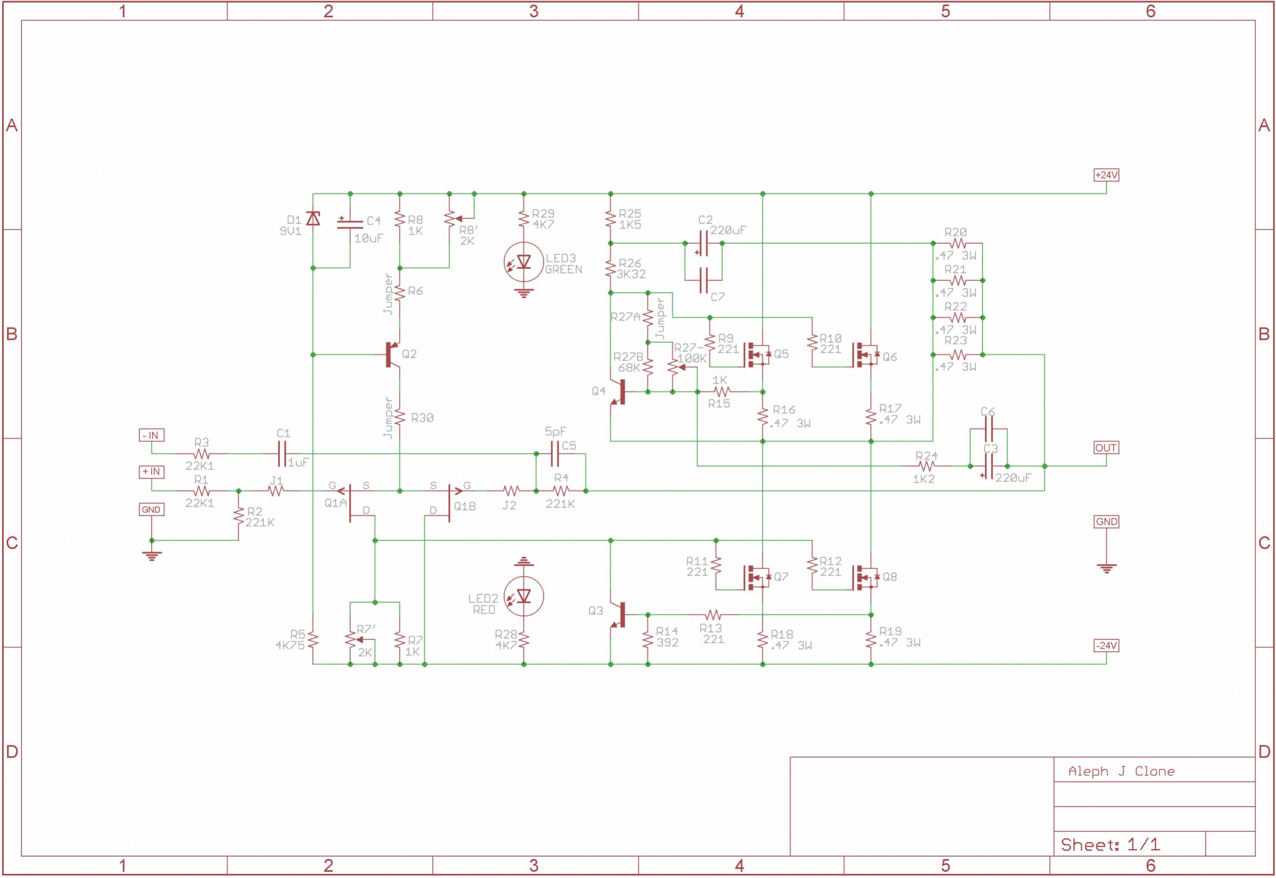

Hi Cody,

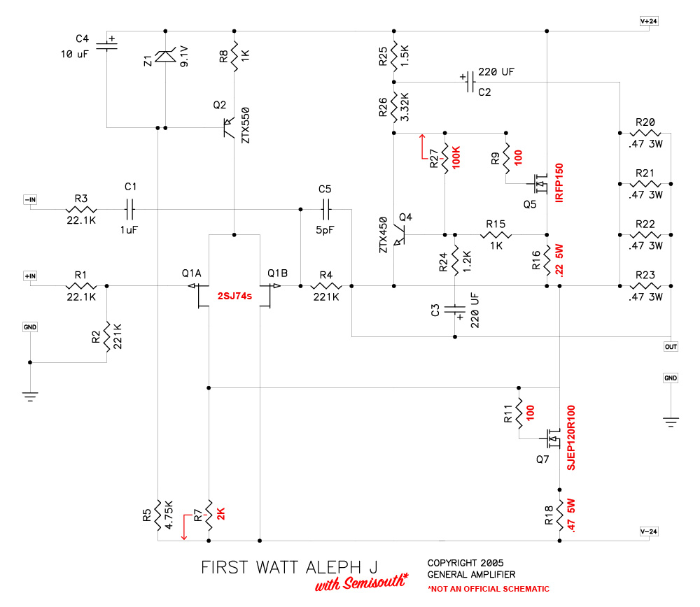

As I mentioned a few posts back, I'm planning to duplicate this with the Semisouths. I've been looking over your schematic and comparing to the Aleph J boards I have from the store. My first blush was that you just eliminated Q3, Q6, and Q8 and associated resistors, but that doesn't seem to be correct assumption.
Is it fair to assume that you had to do some jumpering to make your schematic from Post 81 work with the boards? For example, no connection between R16 and R4, nor from R11 to Q7 drain. I haven't done a complete check of the schematic to see if there are more changes. Any traces cut? Other jumpers?
I've attached the schematic for the original and your final revised schematic.
Thanks.

So, there are some discrepancies between Nelson’s schematic and the schematic used to create the store boards. I used the FW schematic to mark-up, but the actual circuit I used would be the first schematic you attached. I believe the published FW schematic that I used has a couple of errors (which you caught.)
Regarding the removal of Q3 and associated resistors - that is completely optional, and something I did mainly to allow for experimentation. That said, this is the current limiting portion of the circuit and - depending on the source resistance and Iq you use - could activate prematurely. ZM should correct me if I’m wrong, but it’s activation depends on sensing the voltage drop across the output source resistor. I recall the standard bias recommendation saw a 400mV drop across the .47 resistor. If one keeps the same source resistance and goes down to a single device (as opposed to dissipating across parallel devices), you’d be looking at a 800mV drop - enough to activate the current limiter. For instance, I started out with .33R ohm source resistors and saw current limiting take effect (not that I could hear it).
For me it came down to two options (as I wanted to keep the Iq around 1A7):
- remove limiting circuitry
- alter source resistance so limiting circuit doesn’t trigger
Honestly, I don’t mind rolling the dice and removing the limiter parts. Others may prefer to leave it. No right answer IMO
Thanks for the fast response. If I understand, you removed the following:
Q6; R10; R17
Q8; R12; R19
and current limiting Q3; R13; R14
Several values changed and they are clearly marked on the revised schematic. But no jumpers added and no traces cut. If this is correct it makes more sense to me and very easy to make work. I followed the discussion of removing R18 and adjusting R24.
Thanks.
Q6; R10; R17
Q8; R12; R19
Thanks.
Yes, those are the exact changes I made. Other values I specified (mainly the source resistors) were more a representation of what I was aiming for, and what sounded good to me. I certainly can’t guarantee they weren’t detrimental to some other measurable aspect of the amp’s performance. After all, I’m a complete novice with a sound card, REW, and too much spare time - my words on these matters should carry no real weight
