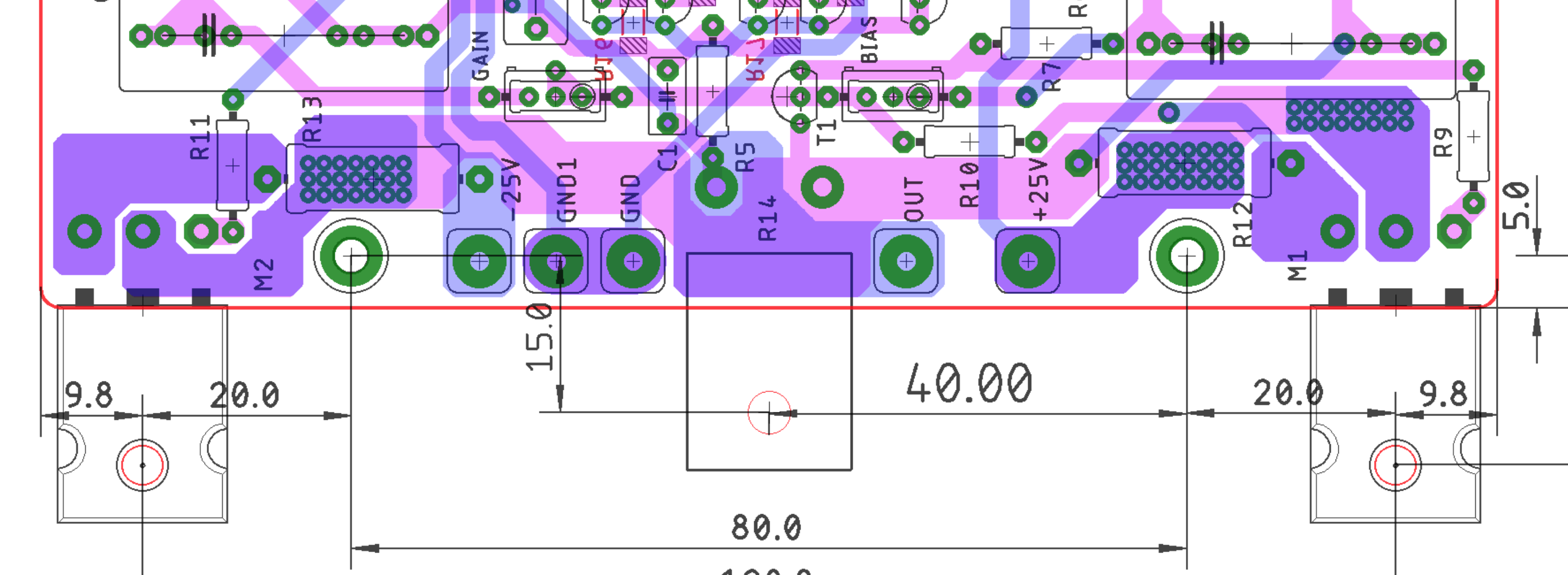

Atempt was made to move JFET pair closer to C1 and different tracing to speaker output suggested by Extreme_Boky.
Higher density of components near C1 now.
But I am not ready to make mirror boards yet. Sorry.
What do you think guys?
It looks like a simple change but it took a lot of time.
I tryed various layouts I was not happy with.
Stayed with this one.
Looking really nice! Did you consider duplicating your higher current traces on the second layer?
Cannot do that because the connection from Q1 to Q2 is in the way ... but you can actually remove that entire section out from the middle bottom of the board and shove it over by C1 ...
Then you would be able duplicate the high current trace on the other layer (possibly)
Cody, сan you please scpecify what exact traces you think need doubling?
I expect biggest current flow in the + and - rails. They are already doubled and also GND doubled too.
Or you meant trace between SJEP120R100 gate and R13 resistor to output resistors?
Q2 collector to Q1 trace is in a way for that.
But it is possible to compomise with added jumper for that trace.
Would that be better or not I am not realy sure.
Or I coud make sliiiiiiiim widening of SJEP120R100 gate trace.
I was just thinking the connections to the source and gate of the output devices. I recently worked up an Aleph J/SS -ish board with Prasi. and I noticed he made those traces fairly big, and doubled up when possible.
Take all this with a grain of salt. I think you have a fine layout, and I don't think any of these things are essential – more just ideas if you're looking to tweak further.

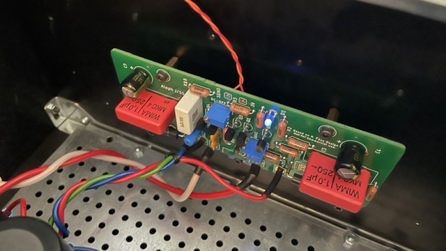

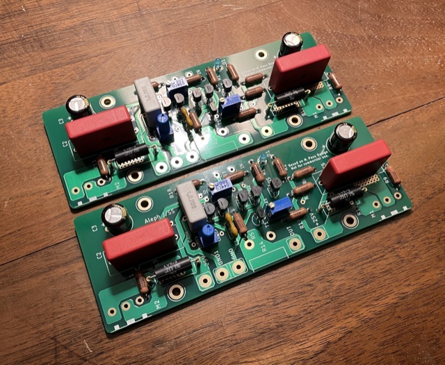

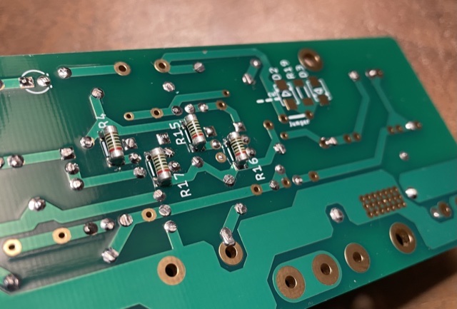

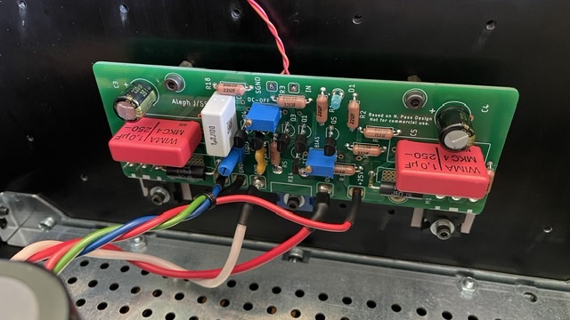

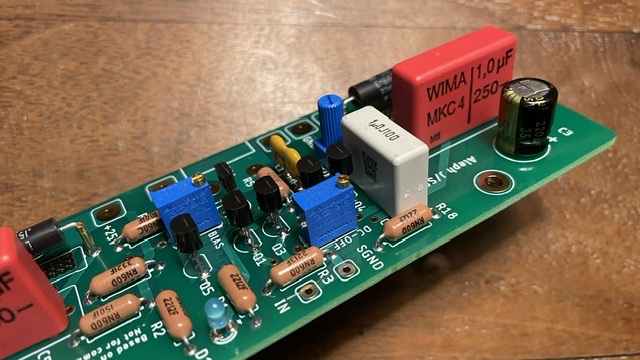

Got my boards finished up today. I’ll post some more details in the next day or two, but here are a few pics in meantime.

Hello again Cody, sorry but I'm a bit confused... tought you already had a J with one SS. Is this another one or a rebuilt version?
This is just a different layout and slightly tweaked Aleph J/SS. Completely unnecessary 🙂
Once you have built a NP designed/inspired amp the rest are unnecessary, but we build more.
sweet! are you gonna be able to give us a direct comparison or did you have to steal the AJ chassis for these boards?
Yeah, I unfortunately have one chassis and many amp boards, so it’s always a game of swapping out channels. I will be able to compare measurements, and will share soon. To be honest, there’s really nothing different about it though, so not expecting huge changes. Just a tweak to the front end, and some other little changes here and there.
So you are using 2 parallel SJ74 per leg of the differential pair and reduced its drainresistor? What is the tailcurrent you are running?
With transistors, it is supposed to be beneficial to implement the same resistor in both legs of a differential pair to improve the matching... even if you don't need the second resistor. It also balances the power in the semiconductors of both legs. Don't know if that is significant though...
