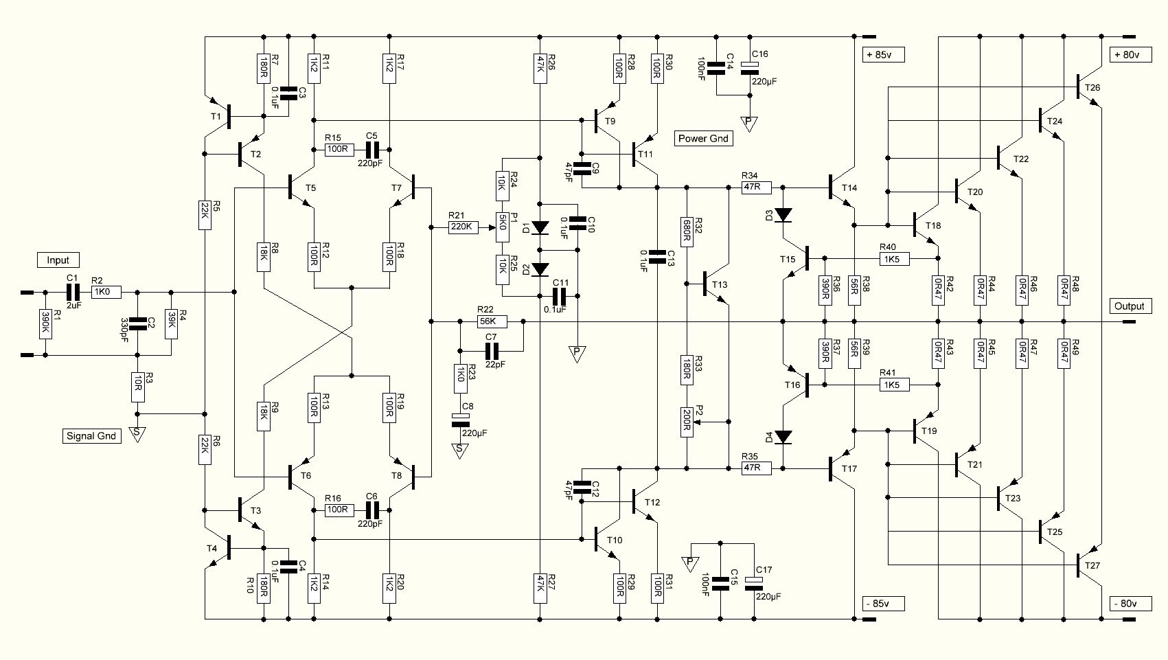

Hi folks,
I'm working on another amp and have some decisions to make around the second stage. I could go the MJE340/350 (stand alone or darlington/ compound / cascode) but I like the idea of faster & more linear devices. Finding one that will take a bit of heat is difficult, hence my question; Is it ok to parallel them. In this example it is T9-T12 and I'm thinking 2 each of 2SA1381 & 2SC3503.
Naturally I will match them so I feel it's ok, but have I missed something?
Cheers
Q

Hi Quasi,
Looking at your circuit, your target is about 30mA as VAS bias current. I don't know what the rail voltages are, but suppose they are 50V; this means a power dissipation of 1,5W. This will remain offcourse, also with 2 devices in parallel.
Looking at the datasheet of the 1381/3503; Ft is max and you are in the lineair region of the transfer curve (Vbe/IC).
I would use 1 device with sufficiënt heatsinking.
But in using 2 pairs, I don't see a problem. IIRC the Titan 2000 from elektor uses parallel devices in the VAS, you should look it up.
BTW: have a look here, I think you can have problems with stable VAS currents.
HEEEELLLPPP : M. Randy Slone Mirror Image Topology Construction - Troubles

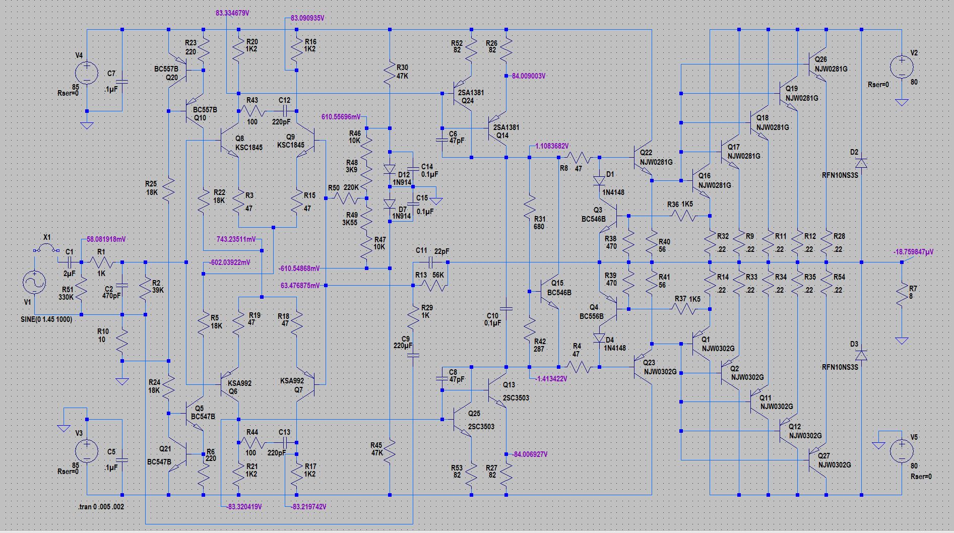

Now had a look at LTSpice but can not see how you would arrive at a nice schematic drawing like in post 1.

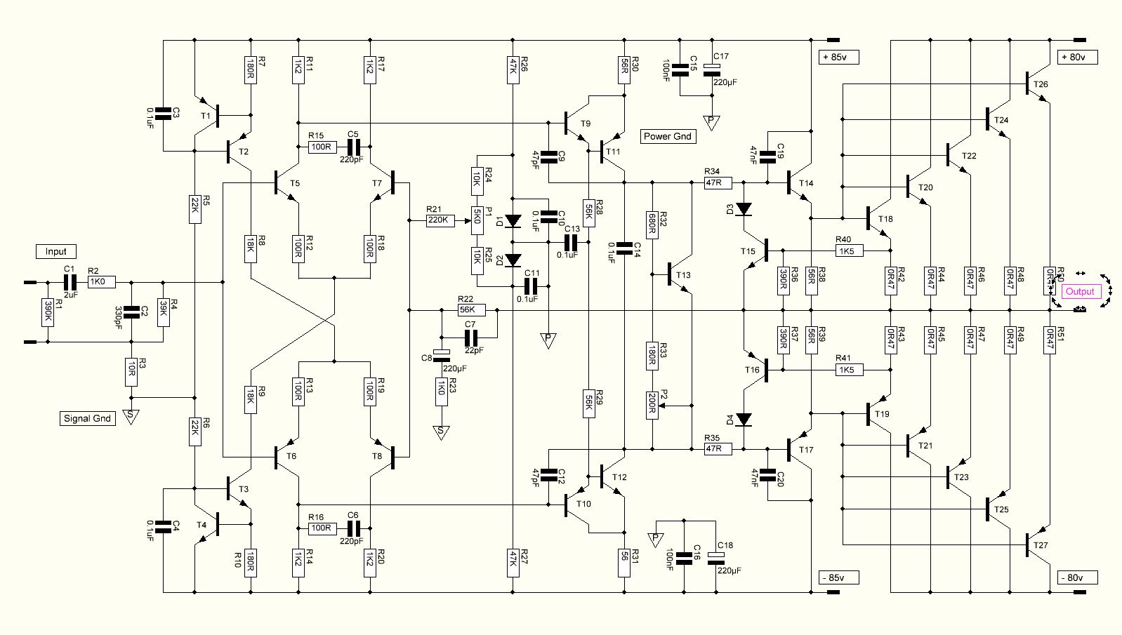

Hi as_audio
I hadn't finished the "nice" drawings when I replied earlier. Here they are comparing two different 2nd stage configs. Note; some of the component values are not finalised.
Cheers
Q

Other members now post the LT Spice .asc file of their schematic. This can be zipped with any special parts models used and downloaded by readers and examined in their own LT Spice program, just like other files they may generate. A really amazing and useful time-saver.
Hi Q,
Nice to see you here....... it's been a long time, and we are all a few years older!
Good circuit, although not a quasi!
Questions:
1. Have you done the sims with and without the two CCSs for the input LTPs? Using a resistor there will decrease PSRR; but will it ruin the performance?
2. You'd put two transistors in series for the VAS. What do you think is the advantage, and which transistor will you choose?
