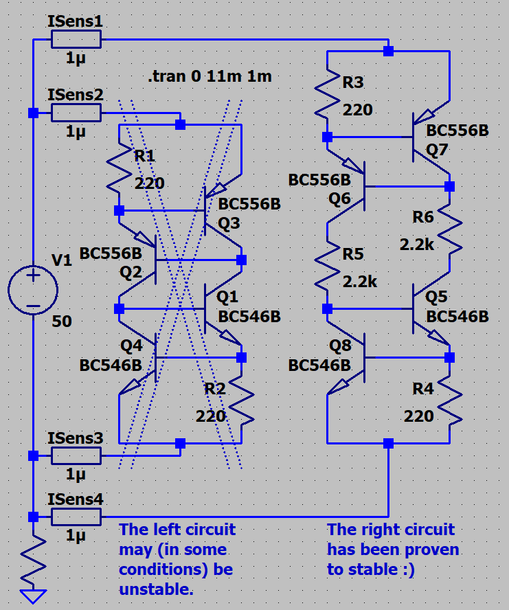

Some references and observations about the 4 BJT CCS as used in the 'Nobrainer' amplifier thread.
The historical origin of the circuit is not known to me (FdW)
First showing [in the Nobrainer thread] 🙂 (circuit on left side)
https://www.diyaudio.com/forums/ana...rainer-nobrainer-discrete-32.html#post3814466
Post# 312
Using: 2SA970 and 2SC2240
https://www.diyaudio.com/forums/ana...rainer-nobrainer-discrete-33.html#post3814605
Post# 323
https://www.diyaudio.com/forums/ana...rainer-nobrainer-discrete-33.html#post3815110
Post# 328
Problems in paradise
Post# 356
Investigations
https://www.diyaudio.com/forums/ana...rainer-nobrainer-discrete-37.html#post3840886
Post# 362 and up
Solved (circuit on right side)
https://www.diyaudio.com/forums/ana...rainer-nobrainer-discrete-37.html#post3840956
Post# 366 The circuit shows a strange mix of transistors, this is no problem but unintended (not noted at the time)
The circuit works problem free in most, if not all, situations and configurations. Using transistors with a higher hfe will produce a better current regulation. Note that Vce(max) must at the least equal the power supply differential (from V+ to V- of the circuit, if not the circuit may have startup problems due to some form of thyristor behavior of the circuit.
Footnote
https://www.diyaudio.com/forums/ana...rainer-nobrainer-discrete-37.html#post3842898
Post# 370

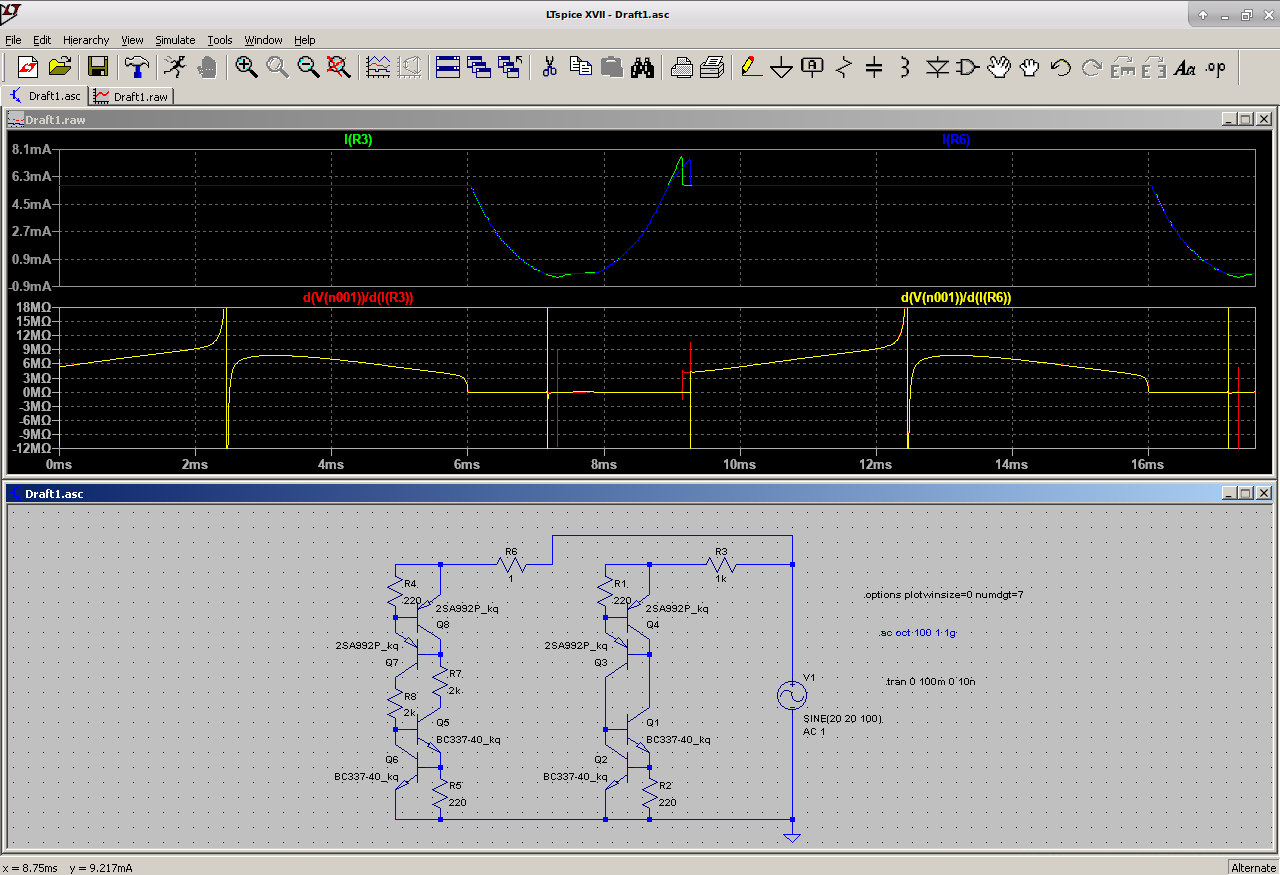

I think I saw this somewhere at the time. You don't need the 2 2.2k resistors, you only need one 1k resistor. You yourself discovered it was stable with 1k resistance in series. The behavior is nearly exactly the same. I don't think splitting the resistor between the two paths actually has any benefit.
Lower plots are dynamic resistance across 40V swing. The spikes are due to out of phase capacitive currents which disrupt the differentiation.

In my amp I found the middle resistors needed to avoid oscillations....
Only one resistor ?
In what side of the circuit ?
Well, I don't know much about the theory behind it and have never taken the time to learn LTspice , so all I know about the circuit is from what I've built.
I tried the one resistor on top and also one at the output (capacitance buffer) but still got the self extinguishing "thyristor mode" or got oscillation and device failure.
I built the circuit with SMD BJTs and also with DIP14 array with tight layout (tried stoppers as well) and had the same problems. With the two Rs separating PNP and NPN it was stable and is still running in a phono stage four years later. (Knock wood!)
I suppose with Keantoken's input I'm going to have to go back to the drawing board and try the single 1KΩ again. I bet it will work this time. (mumble grumble : )
