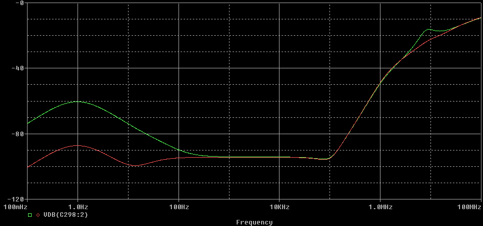

Ah yes, the ccs will be used to feed an input-LTP. In detail, i am trying to build a symasym with optimzed psrr to check the sonic advantages.
Attached is negative psrr of a symasym6, green uses standard 2-bjt-ccs, red cascoded jfet. As you can see, psrr degrades heavily below 100hz, also the normal ccs shows a resonance at 9mhz.
The peak at 13hz down shows that there is an additional problem...
As i want to publish schematic, i should avoid use of exotic parts, they would be substituted anyway.

MikeB said:I made more sims, also adding the "self cascoding" jfet ccs. (see attachment)
The self cascoding shows an impressive -114db...
Than i ran a transient analysis to check stability of these circuits.
I quickly rejected the "self cascoding", it has ringing like hell, asking for problems. Also i rejected all circuits showing any ringing or beeing ugly slow, this left over 3 circuits, the zener referenced ones and the cascoded jfet.
Number 7 (the cascoded jfet) seems to be best option regarding psrr AND stability. (the most stable one)
2nd choice would be Number 3, simple but efficient and stable. Better than my favourite (until today), the No1....
Mike
