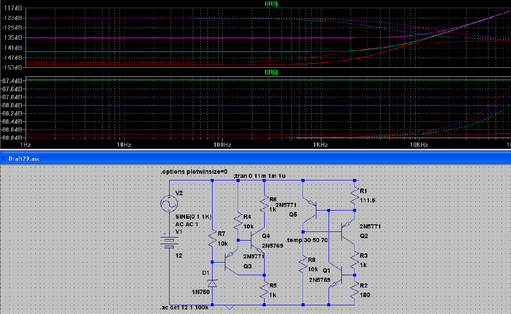

Hellooo. I'm sure everyone is still sorta interested in a good CCS.
Below is a comparison. On the left is a CCS from the thread below. Sure it's old, but WHO CARES. IT WORKS WELL. It does better than MikeB's favorite (no. 7).
http://www.diyaudio.com/forums/showthread.php?threadid=4123&highlight=
On the right is a design of my own. Yes, it has the same temperature defects as usual, but it has excellent characteristics. READ: YOU MUST MUST MUST MUST MUST TUNE R1 TO THE RIGHT VALUE OR IT WILL NOT WORK RIGHT. IF YOU POST THAT IT DOESN'T WORK I WILL POST SAYING THAT IT DOES WORK AND THAT YOU TUNED IT WRONG.
Please read the uppercase sentences in the above paragraph before critiquing my design.
Now, my circuit has the drawback that it doesn't have as good frequency characteristics as most others because the tuning goes off at higher frequencies. This might could be fixed by adding a filter somewhere.
The transistors used here have low beta and low Cjo. I believe this is fair. In my experience, some have shunned designs not knowing that if you used different transistors, it actually works quite well. This is the difference between selecting different transistors for different tasks, and selecting the first one that pops up in the sim menu!
At any rate, circuit and simulation below.

I am looking for an "ideal" ccs, i attached a small collection of 9 different ccs circuits, all rated with a psrr. This db value is the voltage ripple visible at the 1k resistor with the power supply contaminated with 1v AC, all ccs giving ~3ma. The LED style is missing because i have no model...
Did i forget other / better circuits ? Right now the cascoded jfet-ccs seems to be the candidate. Number 9 is also very interesting as it is floating style like a single jfet-ccs.
What i want is a ccs with high psrr, but not too complicated.
Mike

The option number 10 (post # 1) does not work in reality, this option only works in simulations (similar to the famous case of Randy Slone).
regards
Diego
