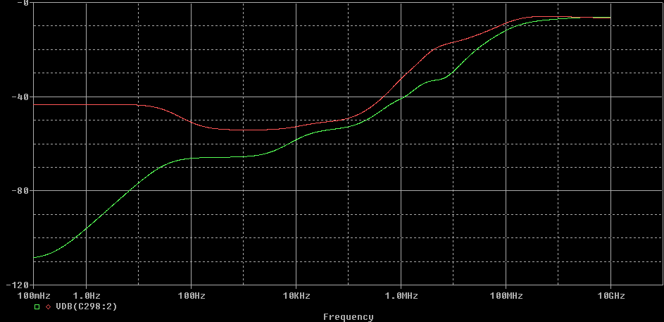

Tim, principally you are right. Things look a bit different for symasym...
Attached is psrr for symasym with inputstage removed. (openloop) (green = positive, red = negative)
psrr is already >40db, plus symasym's feedback of nearly 60db the psrr would easily be >100db. There are enough amps that would be happy to have 40db closed loop... 😀
But any psrr artefact outside feedbackloop can't be compensated. Simming symasym with a virtual spice-ccs gives psrr >80db down to dc.
The negative psrr is here dominated by the ccs to the ltp, the positive can be fixed to the same level by cascoding the input devices.
Mike

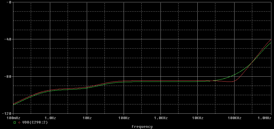

peufeu, you are absolutely right, and i run my symasym frontend from RC filtered supplies. But, these filters degrade for low frequencies...
Anyway, i "solved" the problem, the question was as you pointed out, why the bias change was visible at the output. It shouldn't, as symasym runs perfectly balanced.
The solution: I replaced the input devices with jfets... :cannotbe: Needs investigation...
Attached is actual psrr, green = +psrr, red = -psrr, nicely symetrical... 🙂
Mike

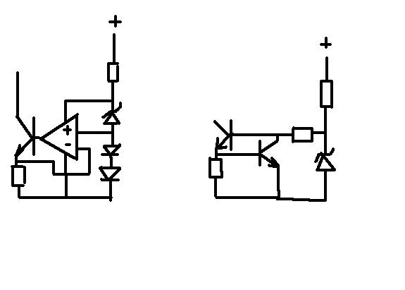

To my experience, incestuous CCS's like MikeB's #5 and #10 are very prone to oscillations and disappointing.
The circuit at the right of Darkfenriz's picture is one of the most dependable I know. It has a large bandwidth PSRR. For a temperature elevation of 50°C, the current will decrease about 20%. Using an LED instead of the current sensing transistor gives a better thermal compensation. Supplying the zener current with an other CCS is a quite unnecessary complication.
PSSR is not all. Rejection of the voltage variations at the CCS output may matter. A common base bipolar in a cascode configuration can be used to enhance it. However, once again, too much sophistication may give oscillations. My prefered scheme is to include a 1 Kohm resistor in series above the reference voltage and to connect the base of the common base ouput transistor to its other side. The 1 Kohm resistor has the double benefit of providing a sufficient voltage above the voltage reference and acting somewhat as a base stopper. Sometimes after I concluded that this simple scheme was really good, I found that Morgan Jones uses it in its valve amplifers.
More sophisticated circuits may give marginally better results but are less reliable.
:nod:
Did you know that its output impedance is just as high as that of a cascode current source? 😎
This is a ''good thing'', for it enhances reliability.
