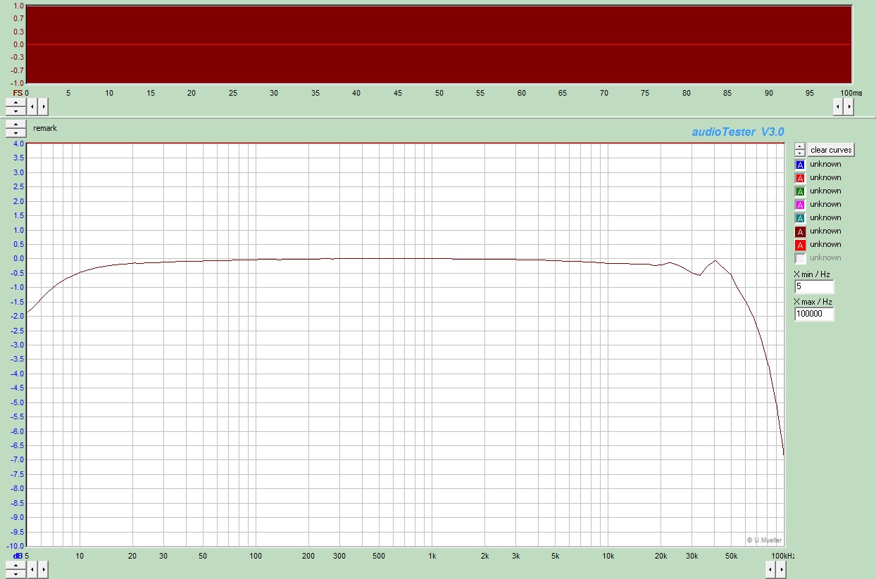

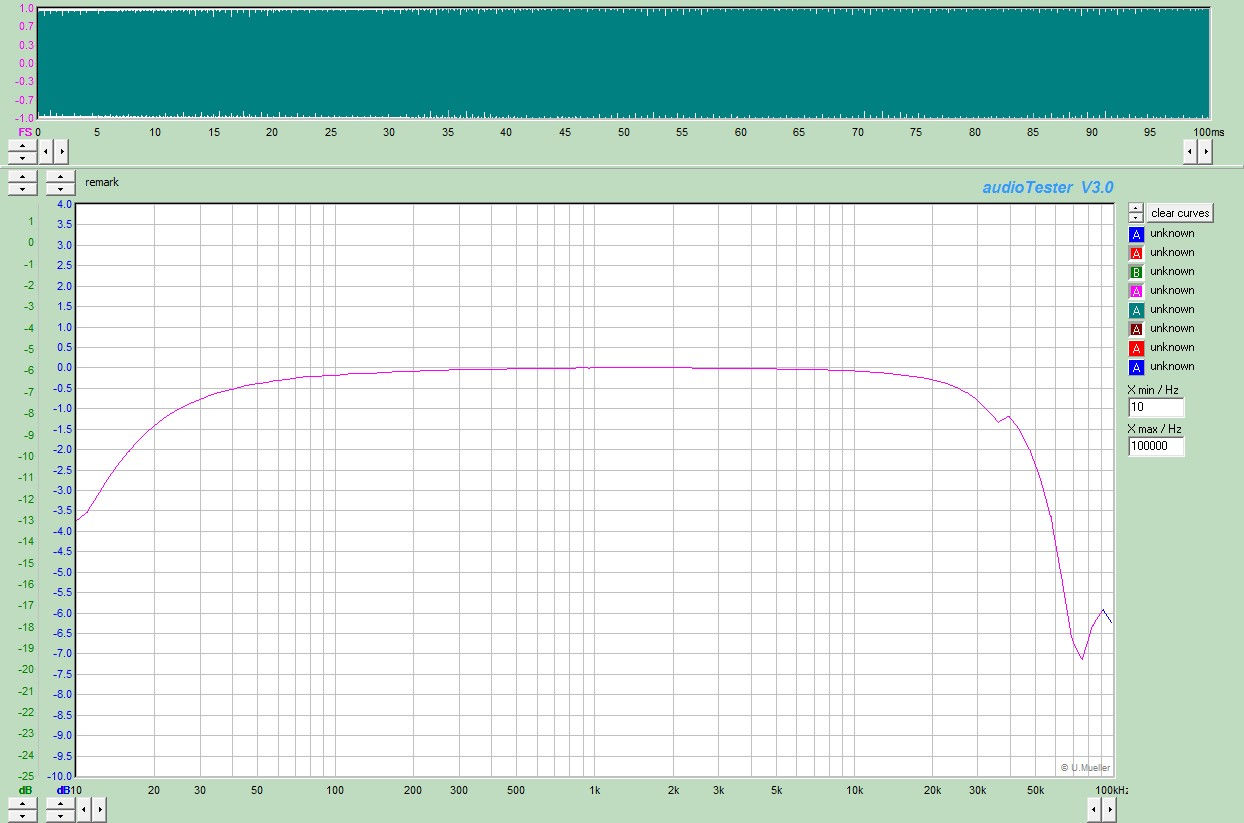

5k Transcendar is decent OPT for not so high power amplifier, due to it's small core and a little high primary DCR.
Some years ago I built a 300B SE for my friend with 10W 5k Transcendar (43H, 380R DCR).
This amplifier (gyrator loaded C3g, capacitor coupling to FET source follower, direct drive fix biased 300B) has very likeable tone, but not so "thundering" bass, because OPT's higher copper loss and core's limited headroom at lower frequencies.

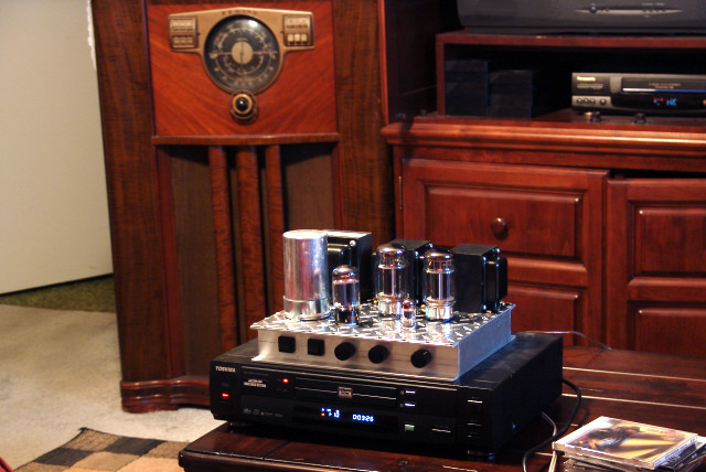

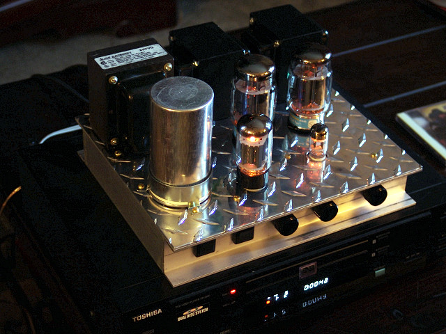

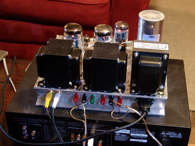

My favorite SSE runs Transcendar OPT's that were designed for 300B's. I put my 8 ohm speakers on the 4 ohm tap to reflect a 6000 ohm load on the output tubes. I used EL34's in triode mode for most music on my Yamaha NS-10's.
When it's time to rattle the neighbors walls with some Pink Floyd, in go the KT88's with the current cranked up near 100 mA per tube, and the amp was connected to my 15 inch open baffle speakers which met the WAF by being concealed inside a matching pair of 1941 vintage Zenith console radios. I goth these OPT's about 15 years ago for $50 each so I bought 11 pair. If OPT's like these are still available, I would have no problem using them again. Now if they cost as much as an Edcor, it would depend on how much power I was going to squeeze through them.
The Transcendars in that SSE could make the walls vibrate in the house across the street through those speakers. With KT88's in UL with the CFB turned on. I got about 12 WPC in that amp with the 6000 ohm load, and about 16 WPC at 3000 ohms. To me the amp sounded better at 6000 ohms so that's where it stayed.
Sadly this amp was dropped when we were moving. It still works without it's motor run cap, but looks pretty ugly now.....again rebuild or part out?????
What output power level was used for those plots?

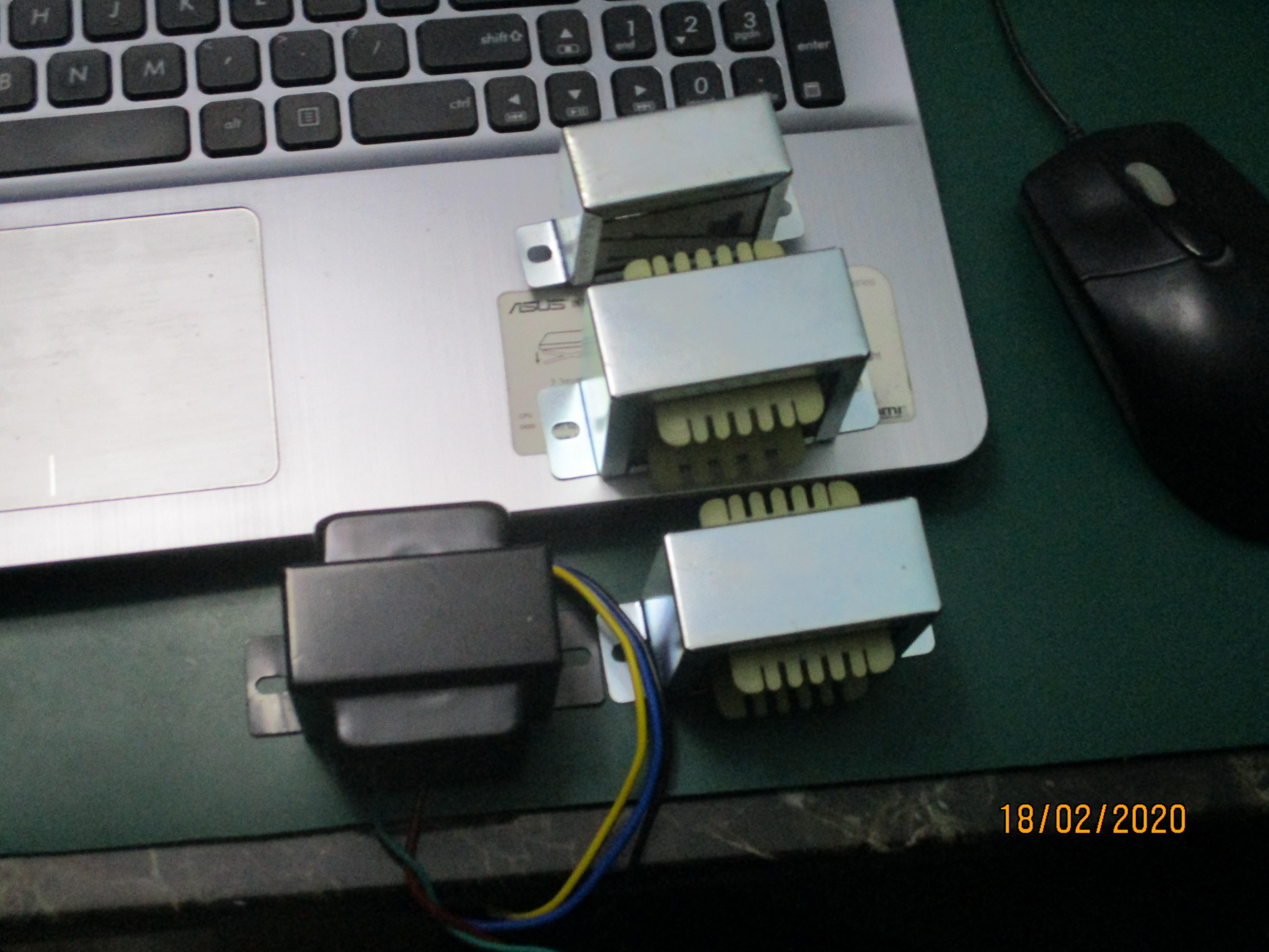

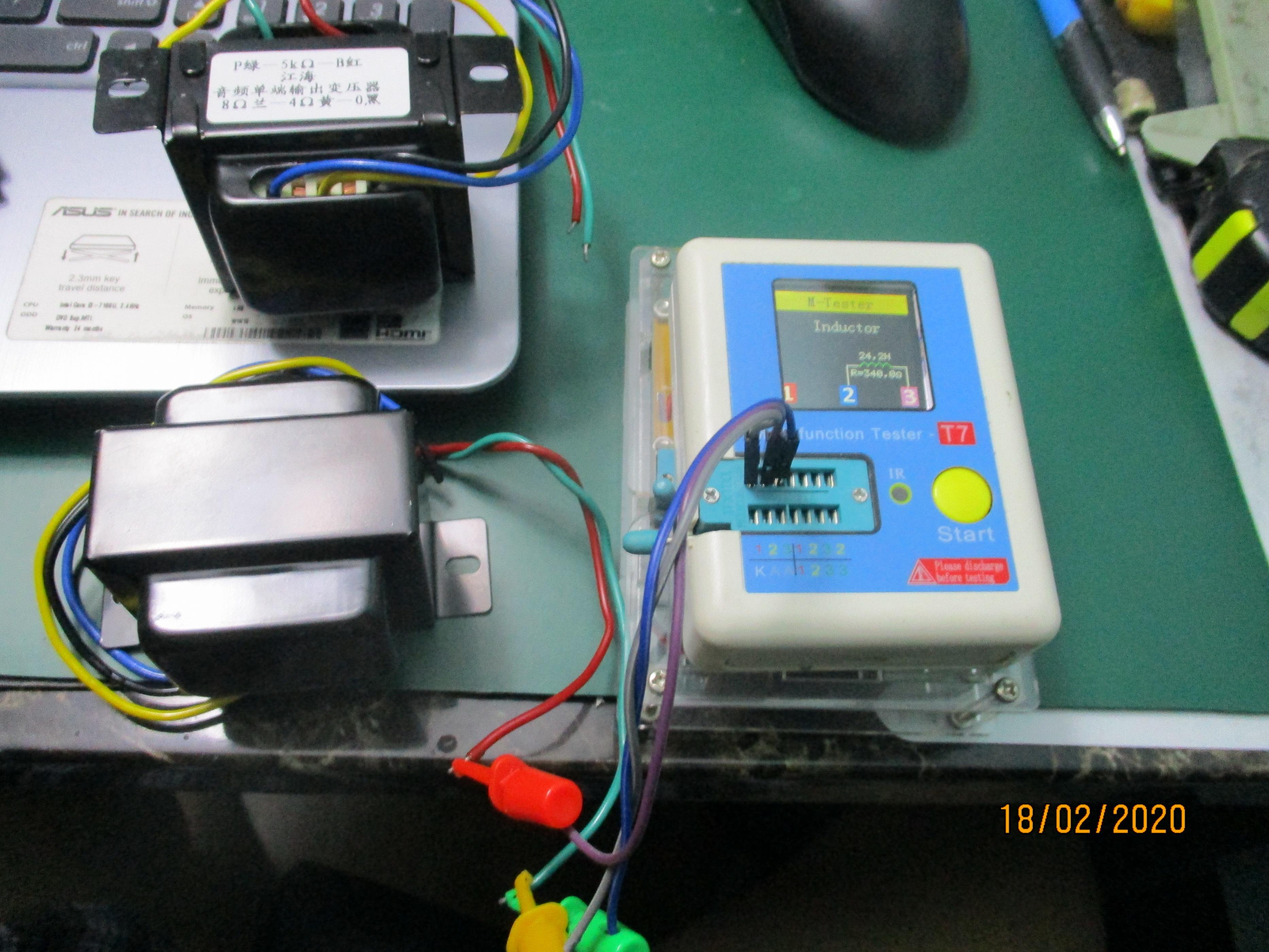

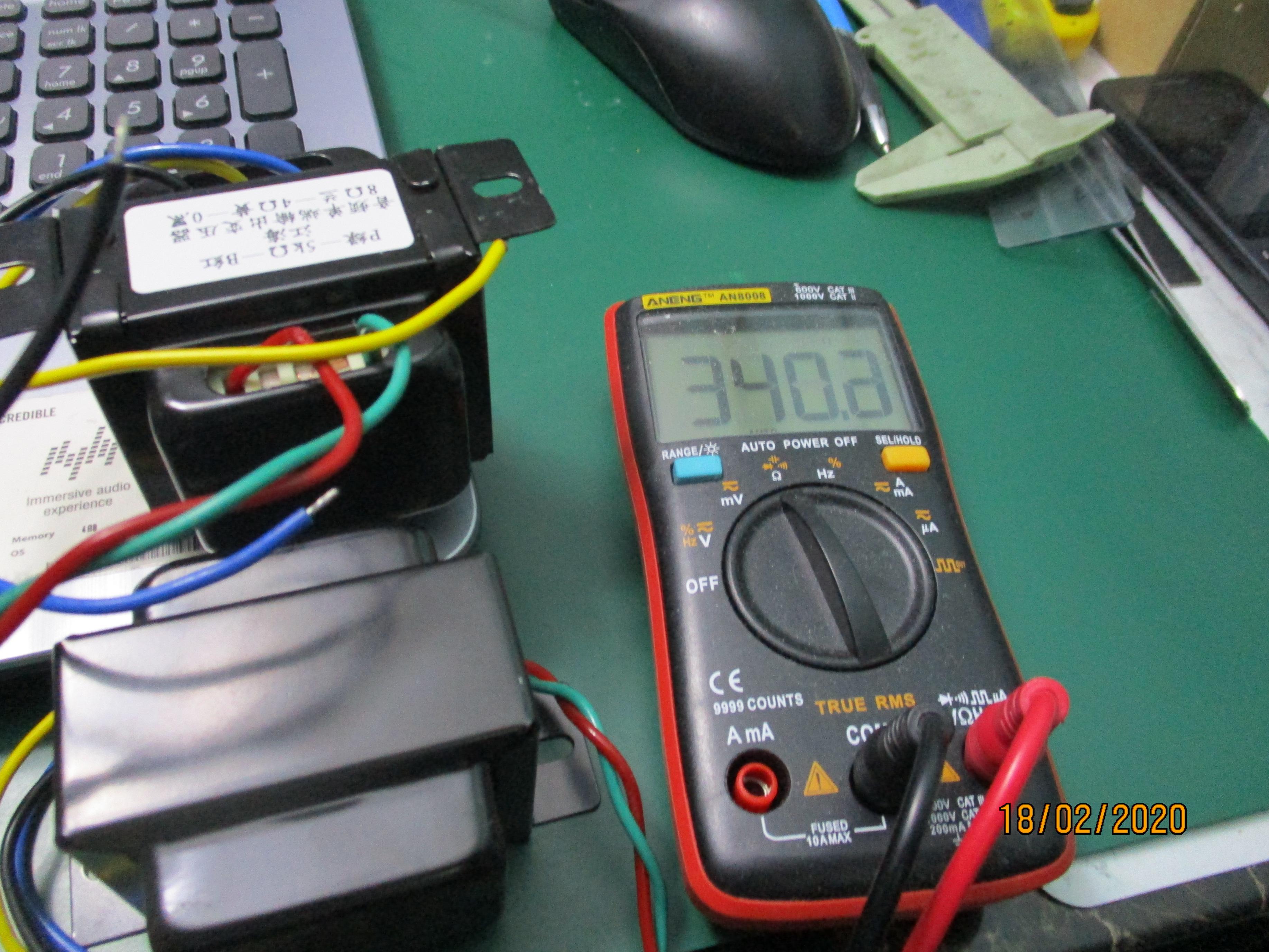

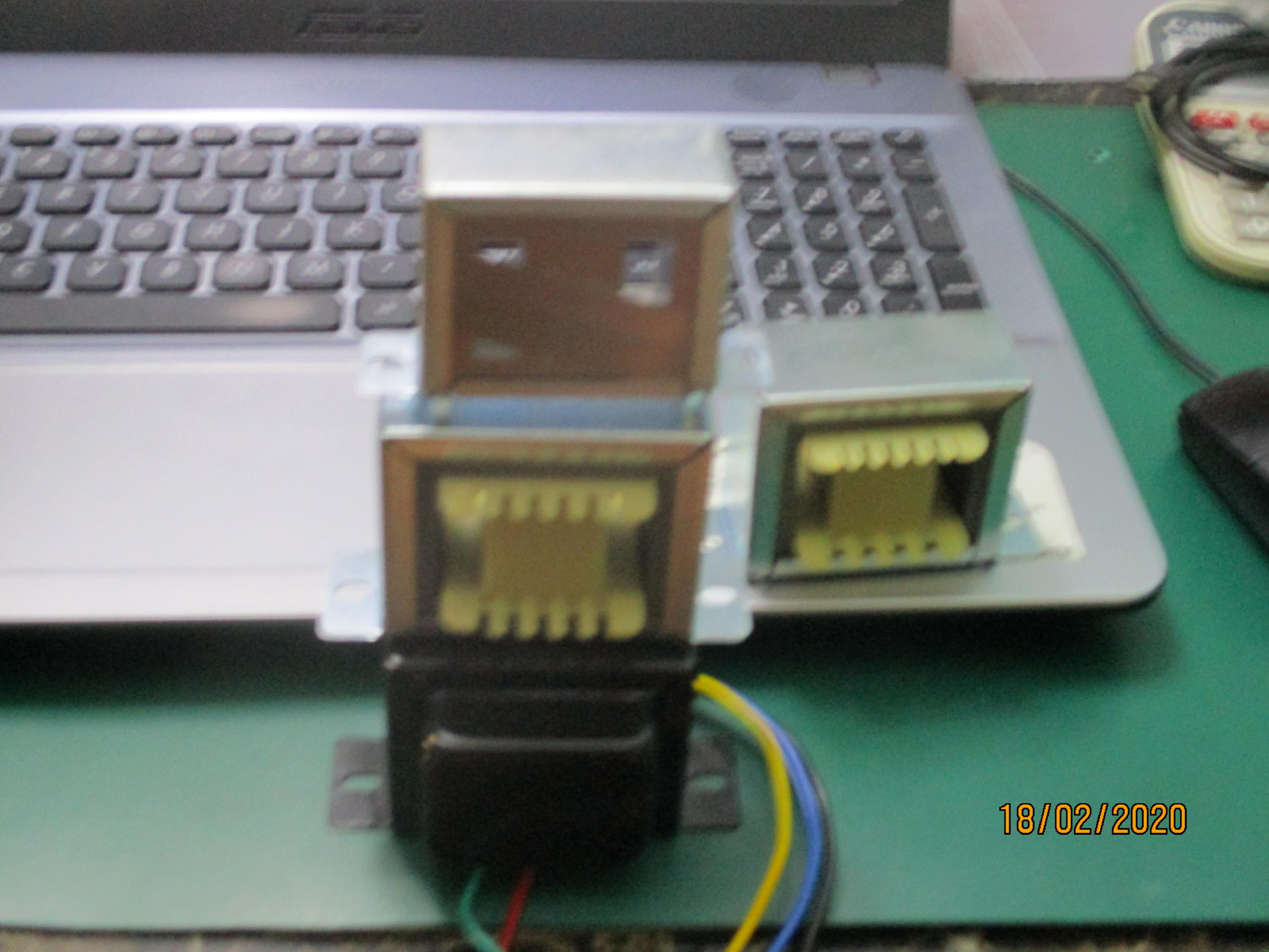

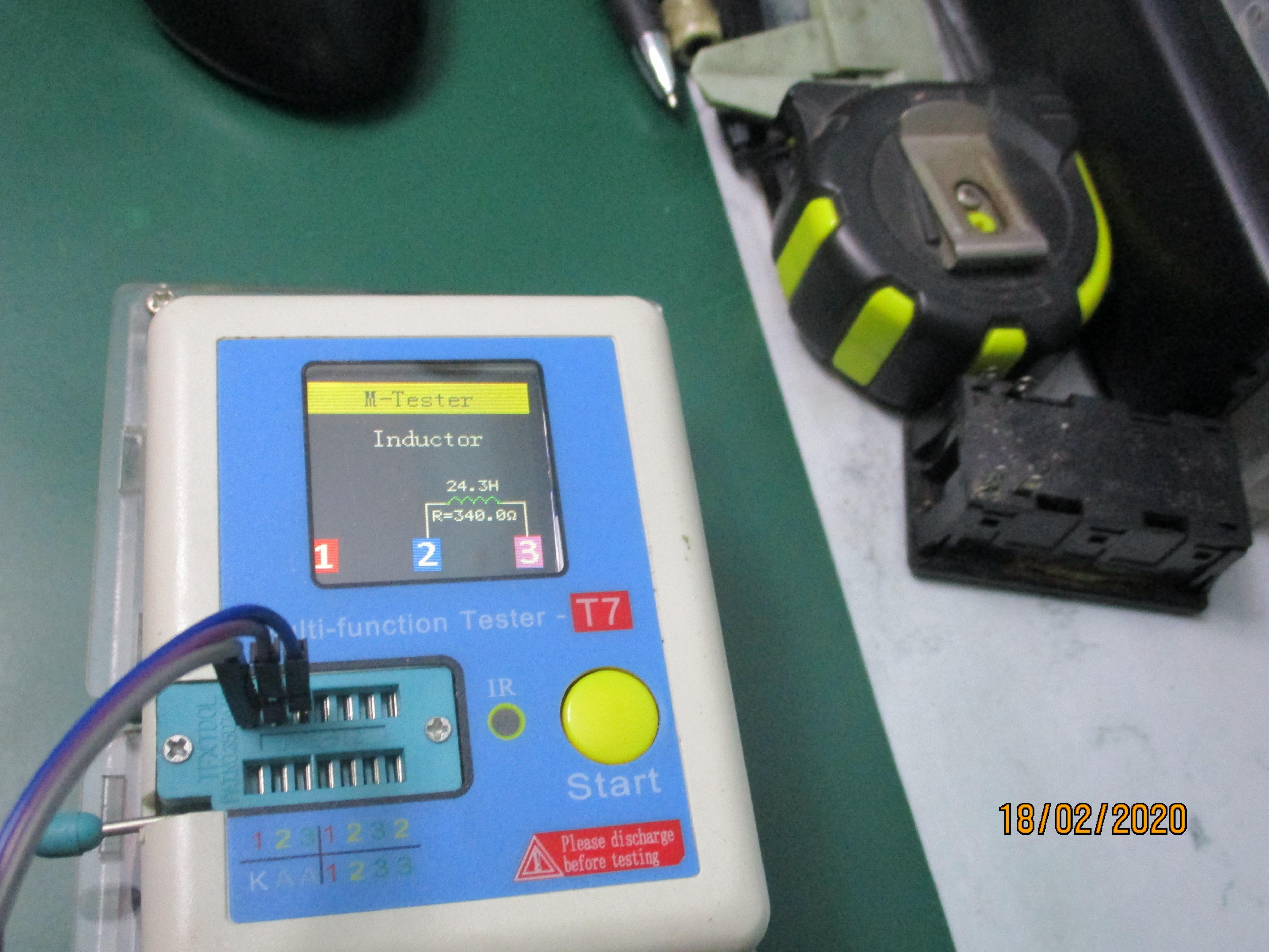

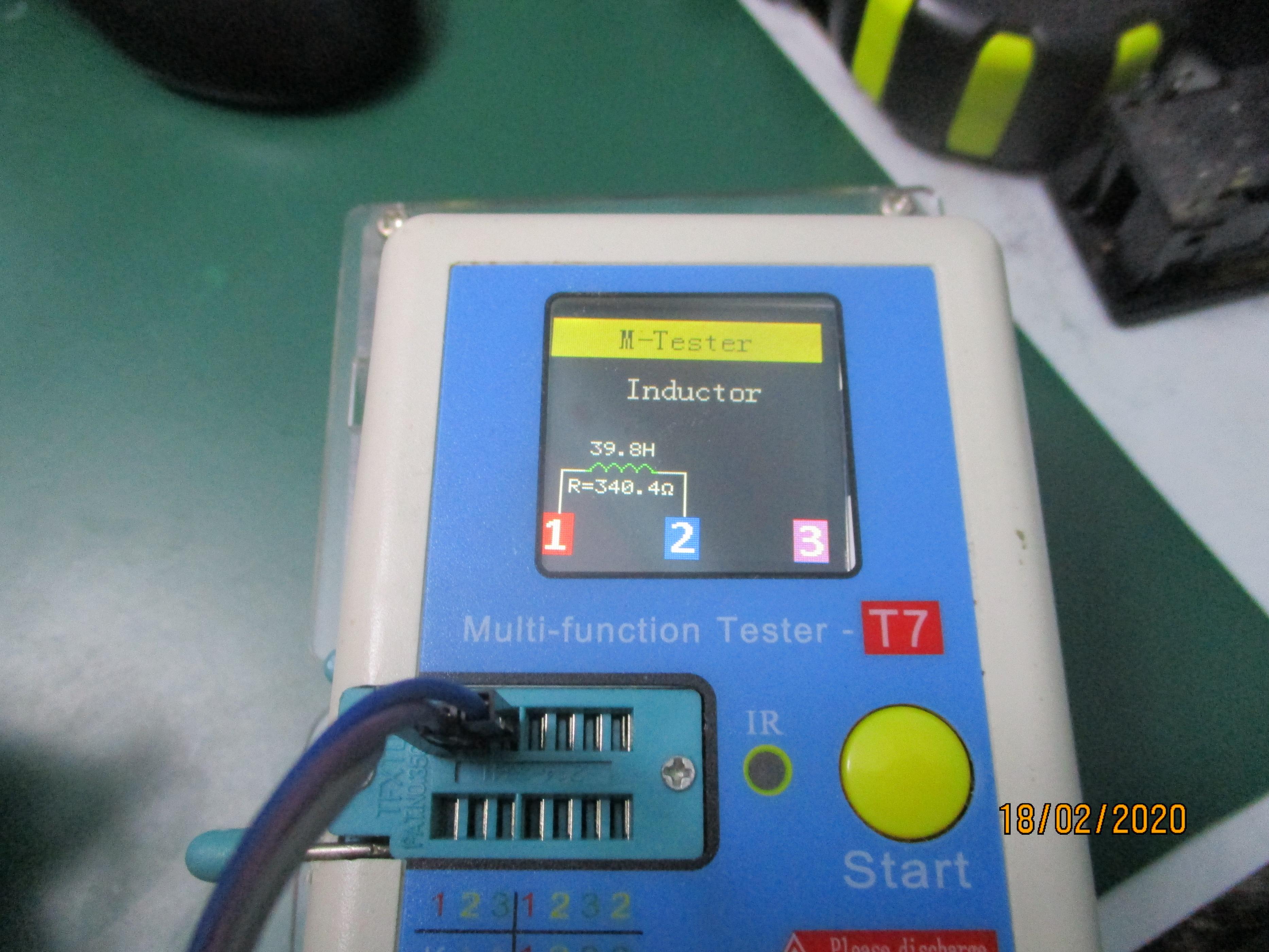

i have the OPT's with me, that same ones coming your way...
i am not a bit worried that one measured 24H and the other 39H, they are all about the gapping...

Those aren't the ones I bought. The ones I have coming are twice the size/weight, AFAIK.
EI66 you posted is a 3/4 inch core, 66 being 66mm divided by 3 is 22 mm or 3/4 inches...that is the spec you posted..
i make my own traffos and uses the same material as your vendor from china, materials i used were imported from Taiwan...
there are two kits in the pictures, one is 5/8 and the other is 3/4...
