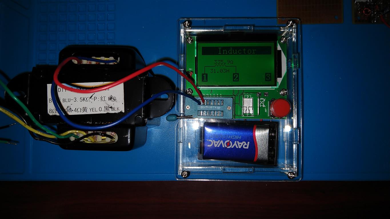

As luck would have it, here at the office, I happen to have not just a cheap Mega328 tester, but a cheap Chinese 3.5K SE OPT, of the type supplied with these $150 ish 6L6GC amplifier "kits". It has about the heft and dimensions of an XSE-15.
31 Henries and 335 ohms according to the Mega328. If I get some time, I can probably measure the frequency response, but it would be at a low level so maybe not much more useful than this inductance "measurement".
I have tested Hammond 125ESE, Edcor XSE15, and a couple of flavors of Transcendars with my Mega328, and got results about what I expected. I have tested line OPT's with it, and got some real head scratching results.
I have read that some of the cheap Chinese SE OPT's lack an air gap, so it will be interesting to see how the bile fever parts measure out.

Indeed those readings seem to be useless. The XSE15-5k is rated as 3 Hy and the CXSE25-5k is rated as 50 Hy, for example.

i do not take the reading from these testers seriously, why? because no dc currents were used, i believe the real inductance will read a lot lower with dc impressed on the windings..
these cheap china testers have another use, that is to check for adjacent turns shorts on transformers and chokes...
any good winding on a choke or a traffo will register both inductance and resistance values, a bad one will only show resistance that is way lower than a good one...

Thank you. I have one, too, but I always take it's reading for inductors with a "grain of salt" per se. The one I bought (T4?) states (paraphrasing) it's rubbish for BIG inductors like 10+ Henrys... Still, It does give a reading
When I test the primary inductance of a series feed transformer, I use a handheld LCR meter with some big bipolar electrolytic caps between the probes and the primary winding of the output transformer. At the same time, I setup my bench DC supply and an IXYS chip as an adjustable current source to send some current through the primary winding.
From my experience, some transformers give an inductance rating with no standing DC current, which I don't like, some are dead nuts on at their given operating current (for example any Triad/Hammond choke is usually bang on), and some are hopelessly far off no matter what I do.
with small testers..measuring inductance is wrong..number means nothing..first there is Dc through the coil in operation which change it..second, inductance is voltage phenomena..with small tester measuring with own battery produced small voltage, what you can read?
agreed, but to have a number that we know would become low with dc in the coils is better than not knowing at all....

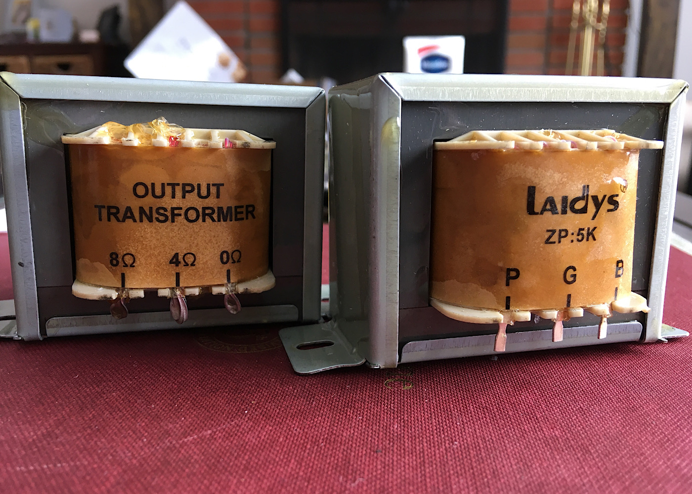

I'm happy to report that the Chinese Cheepies have arrived.
- They have a U/L tap (nice surprise!)
- They weigh 996g and 991g respectively (~2.2 lbs)
- Primary resistance is 370ohms (both the same)
- Secondary resistance between 0 and 8ohm is 1.8ohms (both the same)
- I have no way to test inductance but the claim is 25Hy, which seems entirely appropriate for this size of OPT
- I'm calling it a 6 watt OPT
Note: they are the same size, despite the perspective distortion in the photo:

Size of the transformer depends a lot on what steel has been used - if modern steels are used then the transformer can end up half the weight of what they were in "the good old days". This is where a lot of trust in the manufacturer comes in - I've known "output transformers" in Chinese amplifier to consist of recycled mains transformer steel.
In the translations of Chinese into English they may also have skipped that a transformer is either for HiFi or for guitar use - the latter can be a lot smaller.
What of more concern to me is the measured output resistance - if that resistance value is correct then around 20% is being lost there (1.8 Ohm in transformer with an 8 Ohm load).

i need to say, that transformers for 5W are minimum double size of that one..i'm not sure about getting bass below 40,50 Hz with this one...this can be cca 2W OPT .. need to put DC through in real circuit and see
Transcendar sells 7 watt OPTs that are about this size/weight, and by all accounts they are great OPTs.
