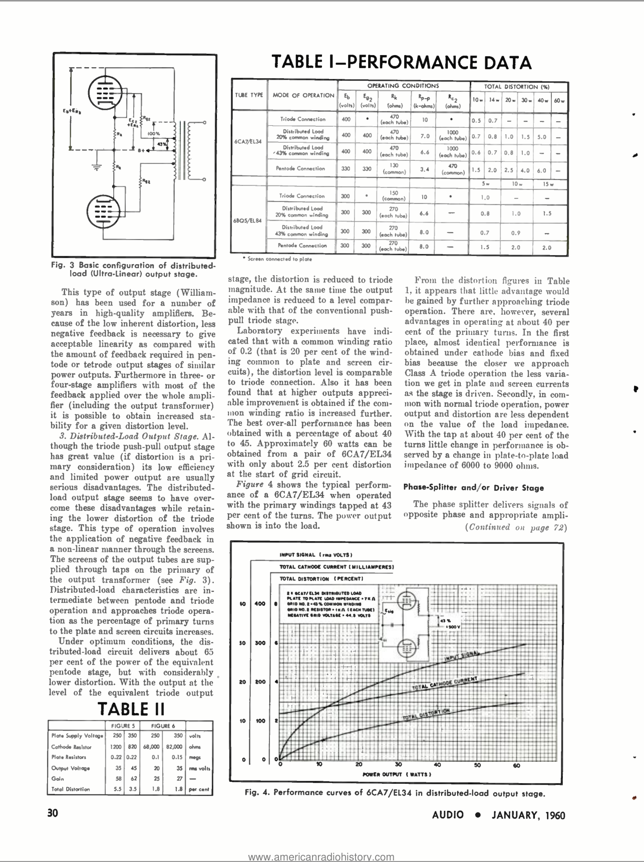

And while we are on this whole OPT business: I have selected a 20% tap for my next SE UL transformer as it is close to the triode behavior and modelling suggest that it is close to what was described in David Saslaw's article (65% of pure pentode output). After I decided on the 20% tap I had a hard look at what I could come up with as a driver and I selected the 5670. (my thanks the the El Cheapo design that gave me the inspiration to look at this tube and thanks to Triode / Pentode Loadline Simulator v.1.0 (20161216 www.trioda.com) for some fatastic software to model behaviour and lay to rest some accepted design conventions ). (The often used 12AX7 has one triode slightly noisier than the other inside the same bulb, cannot remember which side, plus the two are not shielded from each other. In other words you should not use one side for one channel and the other side for the other channel and you have to know which one to use first in the signal path). It helps that the 5670 is still very cheap.

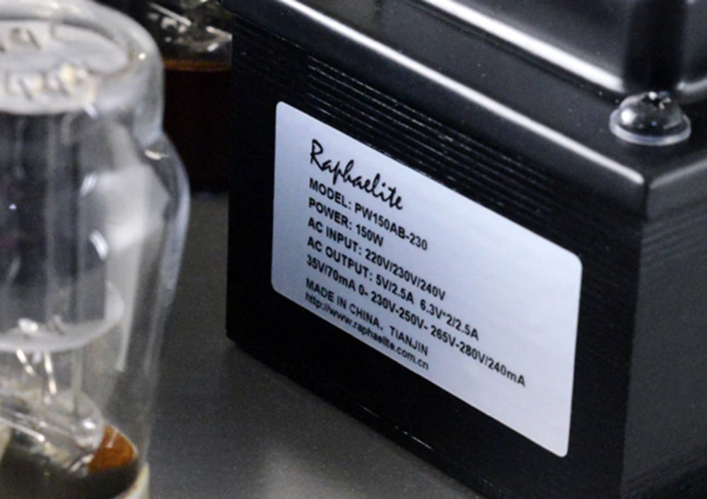

Today I had a I look on eBay and that it appears that matters have not hanged much, e.g. the labeling on this transformer states numbers that do not compute.

How so does your transformer numbers do not compute?
Because adding the secondary powers does not match 150W?
It does not say a thing...
What does make sense is measuring the EI dimensions and stack, and it's lamination thickness, and check the power that a transformer with this core is able to deliver.
Checking the dimensions it seems to be an EI96.
Even with mediocre iron quality of 0.5 mm lamination thickness, a 50 mm stack could deliver 150 W.
When the transformer is wound with a lower T, and therefore "does" some 100 W secondary power, you even might have a very neat transformer.
