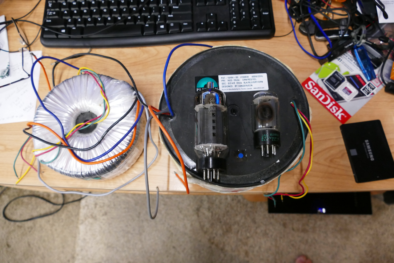

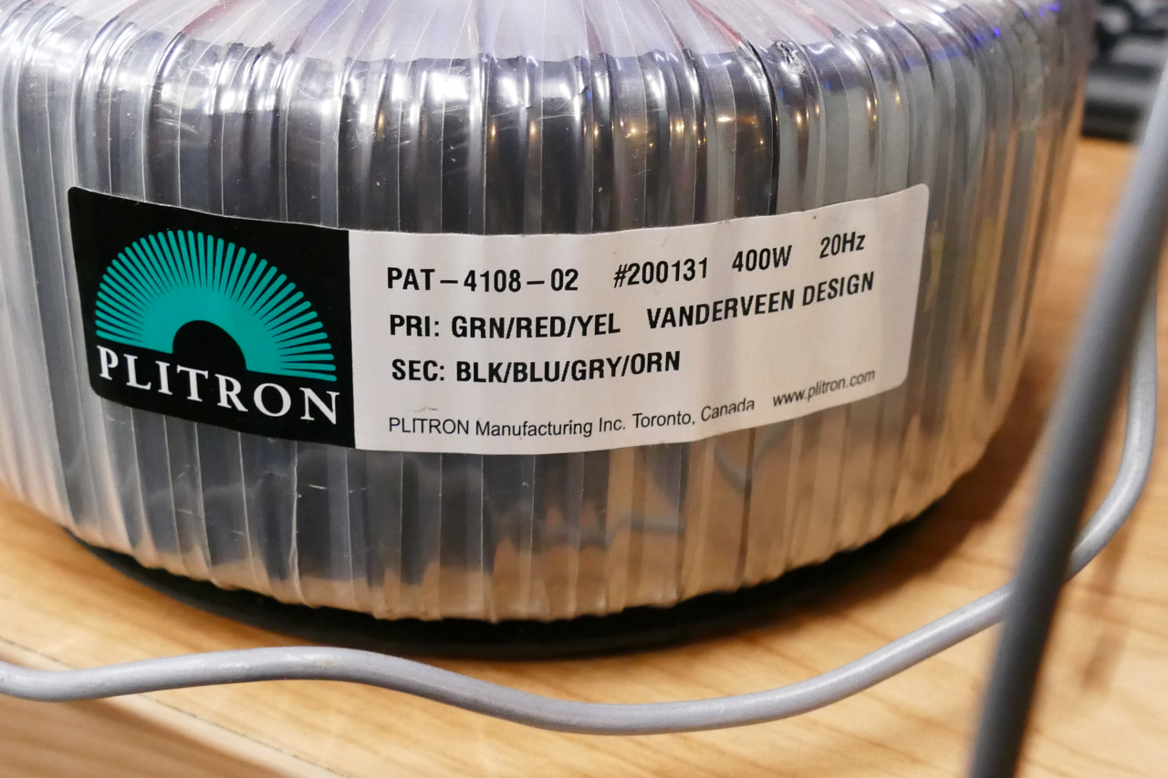

I have not tried any of the SE stuff. Plitron has ceased manufacturing them so the North American source is gone. Over 10 years ago Plitron had a clearance page where they unloaded unsold stock for cheap. I bought the unpotted pair seen here for about $135 each. Another forum member bought the potted pair and sold them to me a few years ago. The unpotted pair have been my test mules for BIG push pull amps.....How big? see post #438 in this thread:
Posted new P-P power amp design
The power meter is reading 504 watts at 5% THD. Just the ticket for really annoying the neighbors.

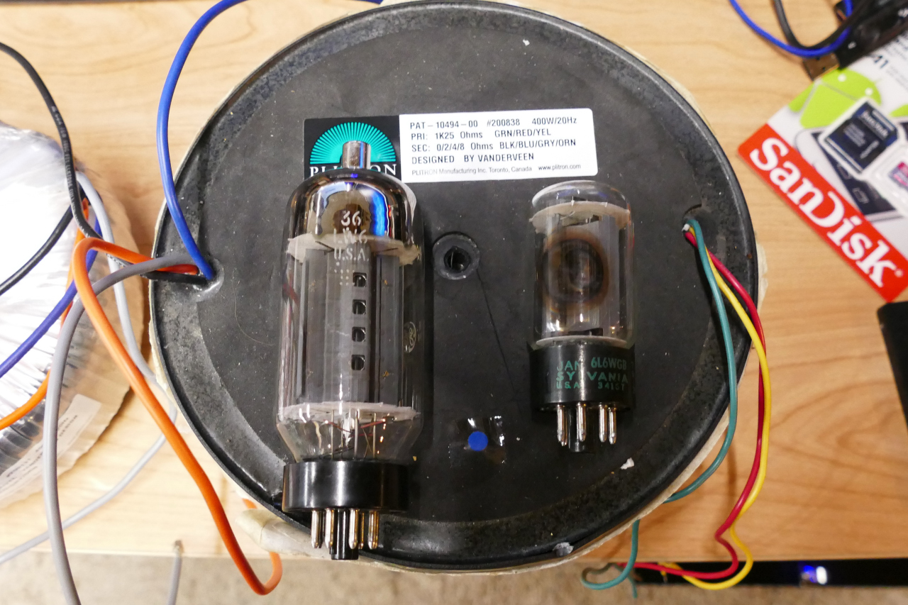

I have been looking for the proper method to get 500+ WPC (1KW total) from a pair of these guys, with two serious constraints. I need to be able to lift and move the completed amp, and It should be capable of operating from a standard US spec power outlet which can pass 1800 watts continuously, quite a bit more for short times.
The small tube on top of the potted OPT is a Sylvania 6L6WGB (5881) the big boy is a 36LW6. I think 4 to 6 of them will make 500 Watts from these OPT's.
