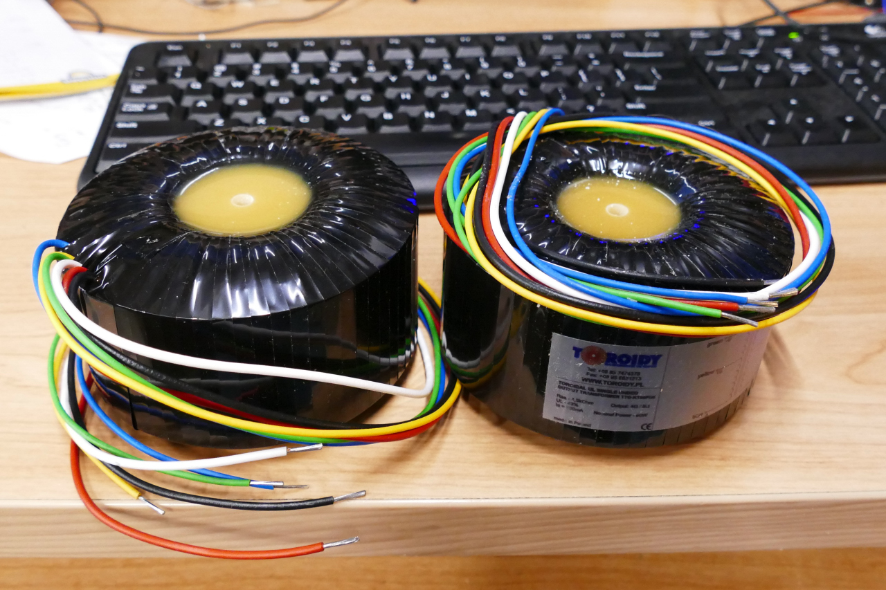

Yeah, I thought of that as soon as I got the invoice with $32 shipping. They are now in the hands of UPS, but still in Poland. Still, a pair of SE OPT's that do 30 to 50 watts each for $208 shipped is a deal...if they work out.

They're here......

Ward de Ceuninck is a professor at Hasselt University and knows his stuff so you get an amazing transformer, but well that quality comes at a price.

I fired up one of the Toroidy OPT's in a prototype UNSET board. I was running it on My Fluke 407D power supply which struggles to power one channel with it's current meter pegged.
I got the amp up and running with a 3K ohm Transcendar OPT feeding a 4 ohm load on it's 8 ohm tap to reflect a 1.5K load, so I stuffed the board with the biggest fattest sweep tube in the box, a 36LW6. Once I was convinced that nothing was going to blow up, I swapped in the Toroidy OPT.
I set the B+ at 450 volts, and the bias at 200 mA and gave the output dial on the audio generator a spin until I hit clipping...The 8903 read 34 watts at 5% THD. Cranking up the current until the Fluke was on the edge of convulsions and turning up the B+ to 500 volts brought 43 watts at 2.4% THD. Turning down the drive to 1 watt brought a red glow from the tube.....UH 500 volts, 300+ mA, yeah that's about 150 watts being burned in a "40 Watt" tube.
I tinkered with B+ and current to find the best compromise, and found that 450 volts and 280 mA will result in 0.22%THD at 100 mW, 0.32% THD at 1 W, and 0.65% at 10W. 35 watts brings 3.3% and 38 watts hits 5%. All testing was at 1KHz. Dialing the generator up to 20 KHz makes a small rise in THD, but dialing it down below 100 Hz makes UGLY.
The most power I could get at 20 Hz was 2 watts, and I had to reduce the current below 200 mA to get there, which kills the power at other frequencies. I could get about 10 watts at 40 Hz but the THD was in the 5% range and it looked like saturation. This may not be a problem with real speakers since their impedance tends to rise in the 40 to 100 Hz region.
The poor LF could be related to the old Fluke, and I did not try my usual big fat cap across it's output.
The single tube breadboard is not up to driving a 1.5K load, so I need to make one with 2 or 3 tubes per channel. I am reluctant to test this with my BIG power supply since it has demonstrated its ability to really blow stuff up.
