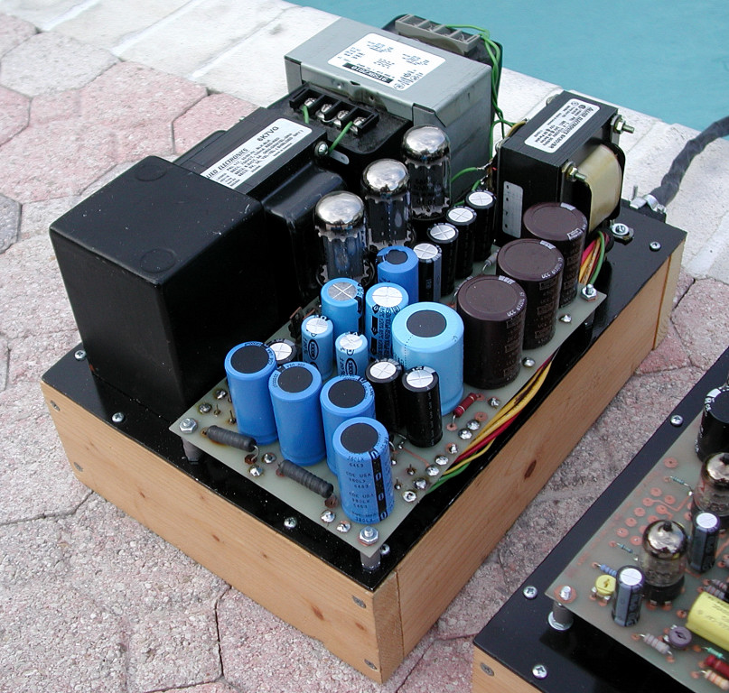

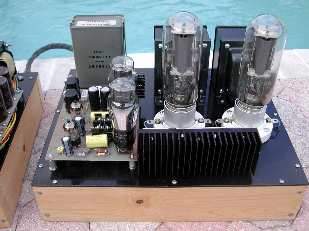

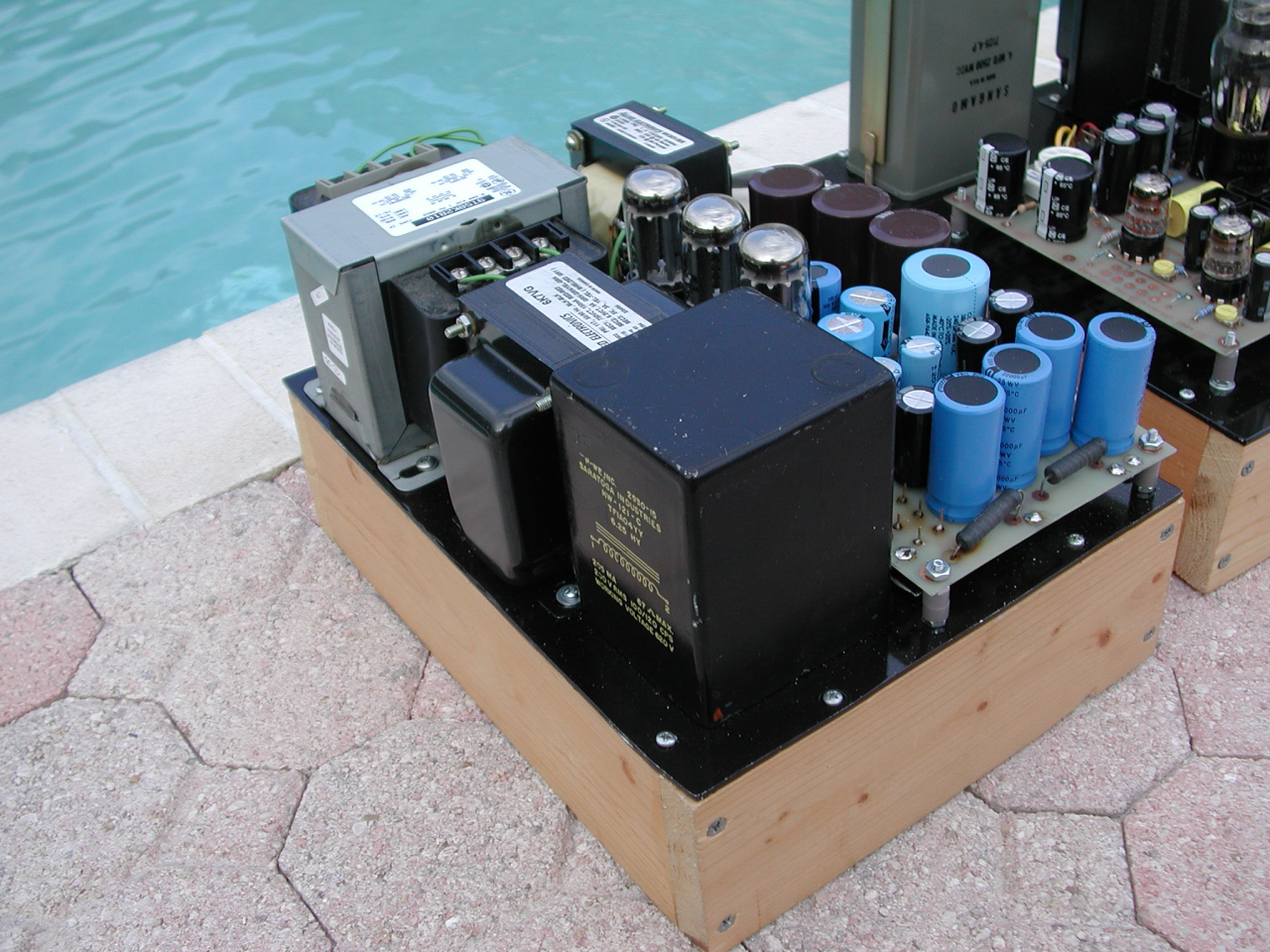

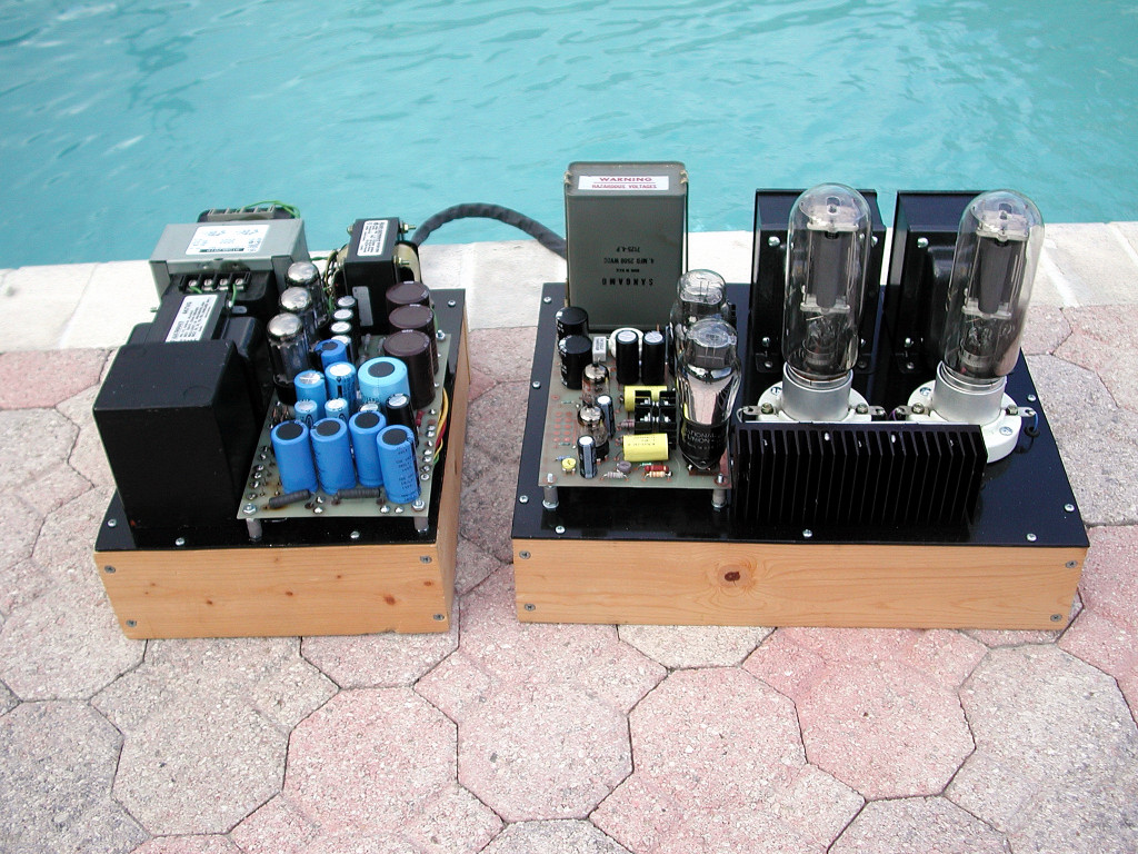

I pulled chokes and transformers and other parts out of military and industrial scrap for years. The choke seen here in the power supply my 845 SE amp came from some scrap, as did the large oil filled cap with a 1971 date code on the power amp chassis. The choke says "Saratoga Industries" but the cap is a Sangamo, a popular capacitor brand from days gone by. The choke was ripped out of another amp I made, the 300Beast It ate a lightning strike one day that resulted in some dead diodes and caps....it is still waiting for me to rebuild it.
The driver board on the amp chassis was one of the very first two TSE amp prototypes ever made, from before Tubelab Inc. even existed.
