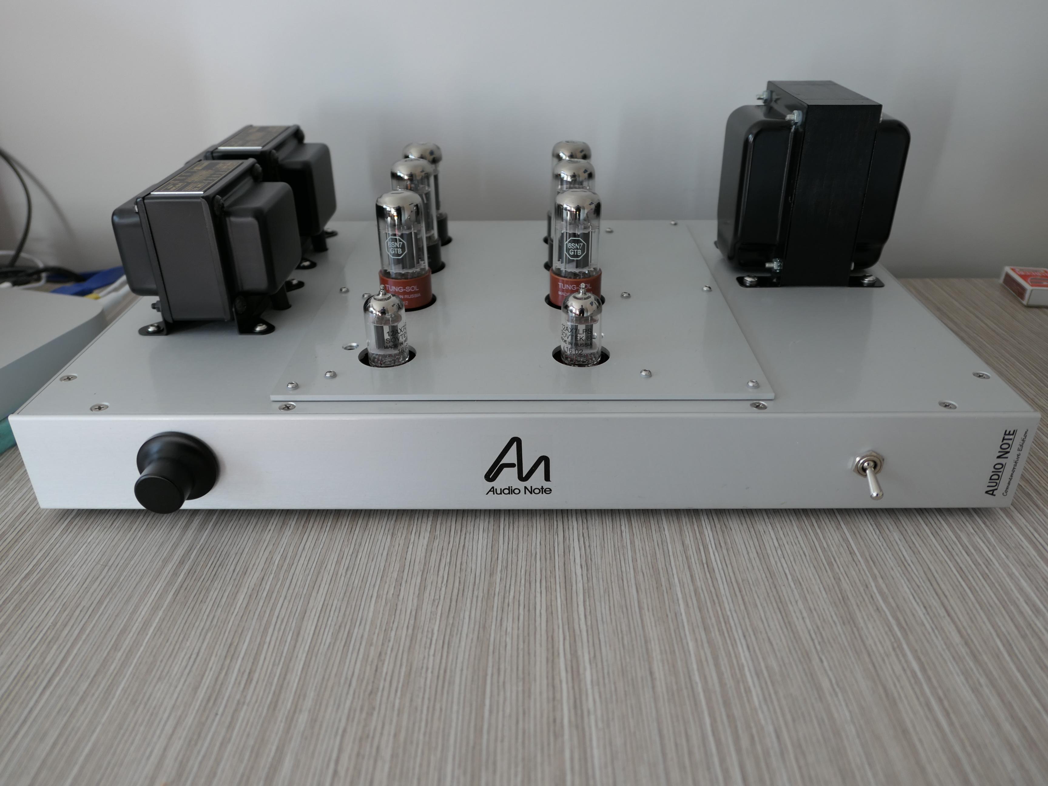

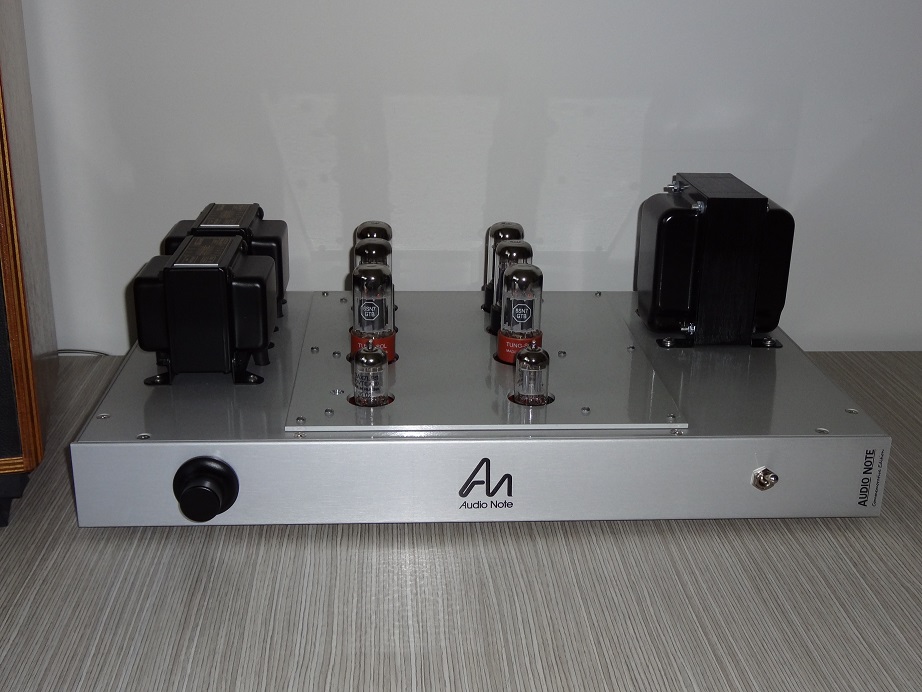

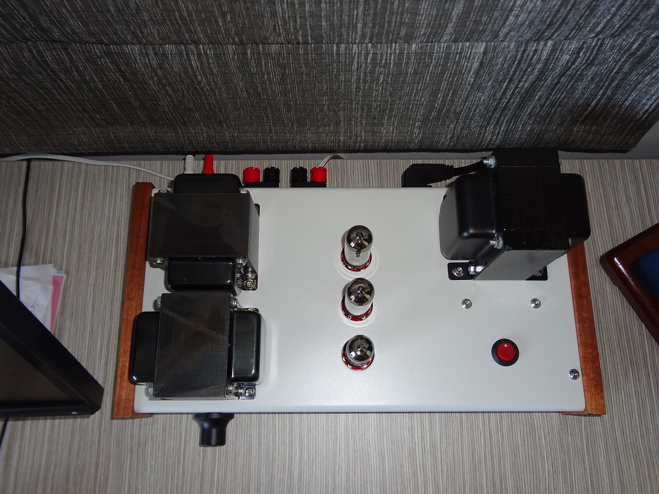

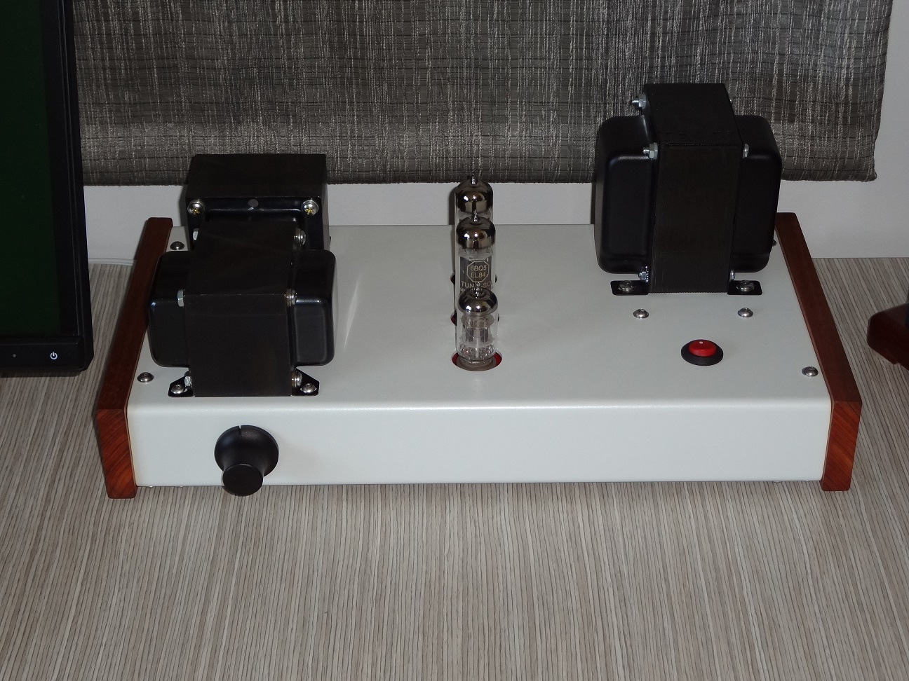

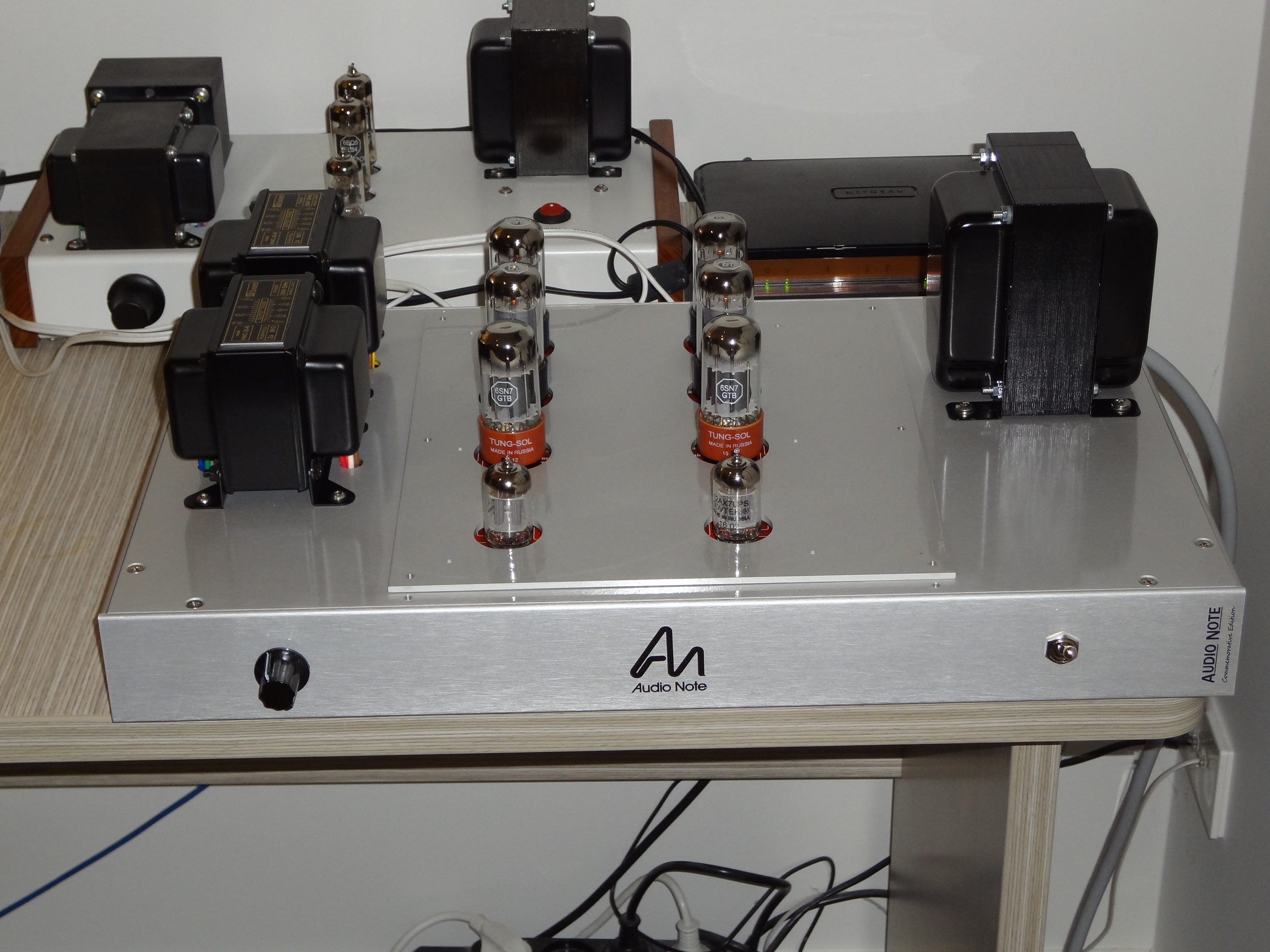

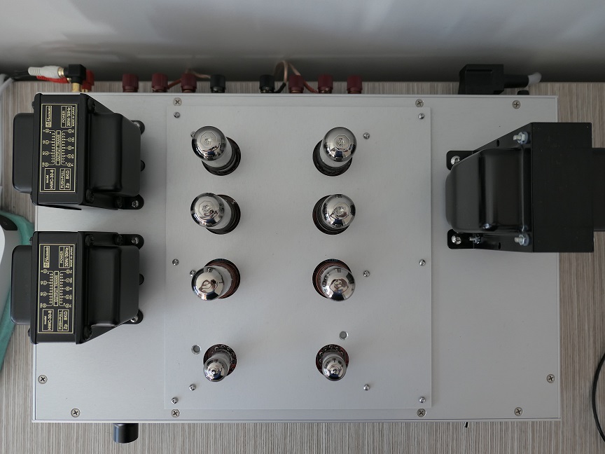

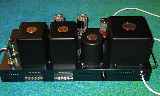

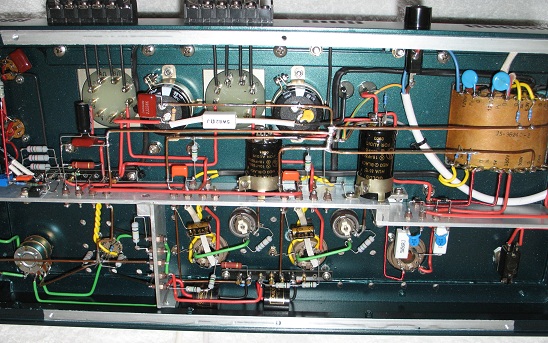

Just in case that someone may have doubts about what I made I have attached pictures.
A SE 6L6GC build with James 15W UL OPT and mains transformers plus James choke (green chassis - build in 2010).
In 2013 I build a small 6BQ5 SE with Transcendar 10W UL OPT and Hammond PT. (arctic white)
3 years ago I build an Audio Note kit 4 clone with Hashimoto HWC-30-8 OPT and Hammond TP (blank aluminum chassis).
The James transformers kept on giving off a synthetic smell that eventually caused me to sell it. Although the choke was oversized it ran very hot - could not touch it for more than 1 second. The James transformers were presented as being build by someone who made transformers for Tango.
The small SE 6BQ5 - I sold it because of a mistaken belief that I needed a larger amplifier.
The Audio Note - there was a measurable difference in the performance of the two OPT, both in frequency, resistance and output. Most noticeable one would expect with CT that the resistance in both legs was the same however this is not the case, this meant it was not bifilar would. Was disappointed in the quality.
The 6BQ5 has gone to an audiophile who has an assortment of amplifiers and it is his most favortie above a Leak20.
To my ears (and I do not regard myself as an audiophile) I liked the little 6BQ5 the best and am going back to something similar:
I will be using a 5670W (6N3P-E) input tube and using 7W UL Transcendars with a 22.5% UL tap (!) OPT's and a Transcendar Mains PT.
