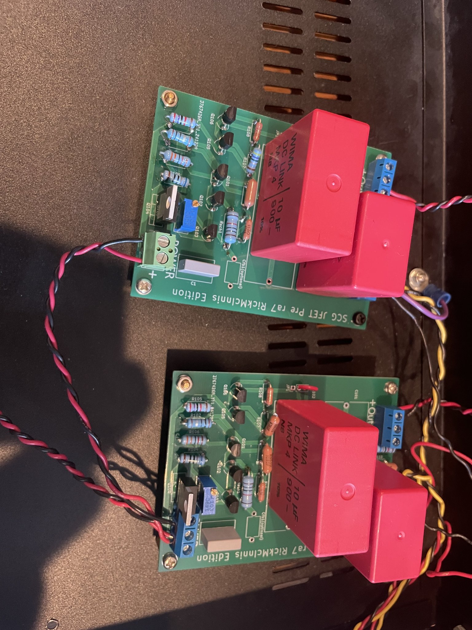

Here is a pic as promised. It is the RMIE version with Wima DC link cap for C102 and Wima FKP-4 for C101. Both channels powered by the same supply. I am very pleased with the new supply and regulator. Will post that soon.
I used parts at hand, and I was running out of some of them. The most sensitive parts are the coupling caps. I found the differences were huge.
Note the orientation of Q101 🪽

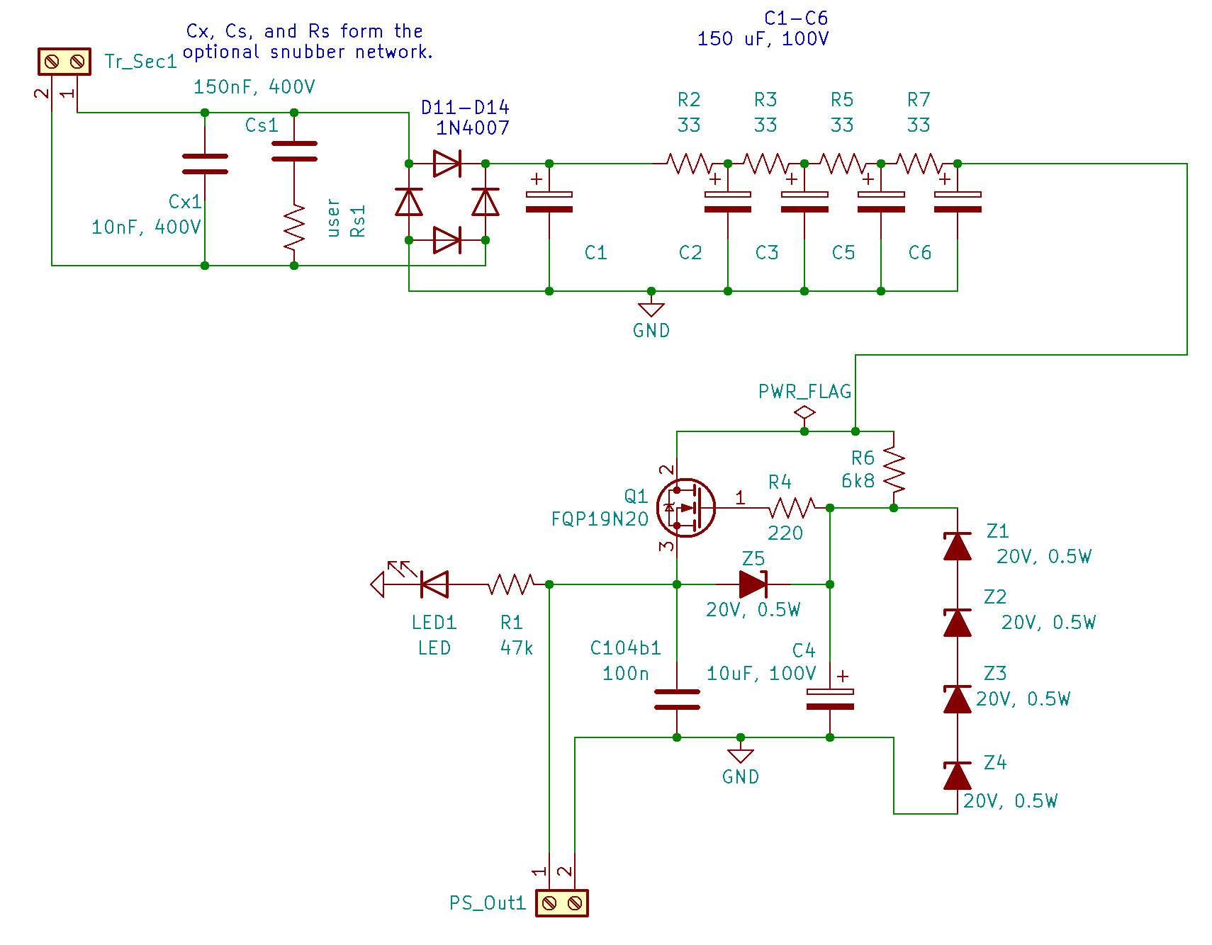

Here is the PS PCB. I wanted to make a few changes to the original, like making Vout adjustable, but such is life that I just cannot seem to find the time to do it. This one works and works great and most importantly, sounds great. So, here it is.
The neat thing in this one is the improved filter before the regulator FET. The combination of R+C filters and the number of filters gives us a very deep reduction in ripple. You don't need big caps either. This technique was given in Morgan Jones's book. I am very convinced of its effectiveness.
The FET is any ordinary N-Channel MOSFET that can do at least 100V drain-source. I am using the plastic STF3LN80K5, the plastic case requiring no isolator between the FET and the heatsink.
The transformer secondary should be about 50-65Vac depending on the target Vout. If shooting for 50V to the preamp, then feed 50-55Vac to the PS PCB. For higher voltages (SCG JFET pre max is 70V), use higher secondary voltages. The rectifier, filter, and regulator are all on the PCB. There is space for a snubber network that follows the Quasimodo technique explained expertly by our very own Mark J.
The output voltage is set by the zener string Z1-Z4. The output voltage Vout will be sum of zener string minus 4V. So, for a 50V output, you'd shoot for 54V with the zeners. For example, using three 18V zeners and shorting the fourth one. Zener voltages on the PCB are shown only as an example.
The input rectifier network uses the footprint of a TO-220 device. So, fancier ones are possible. C104b1 is optional. The 33 ohm resistors are 1/2W.
I think that's it. Schematic, BOM, and gerbers attached. Don't change the resistor/capacitor filter values--they go together.
