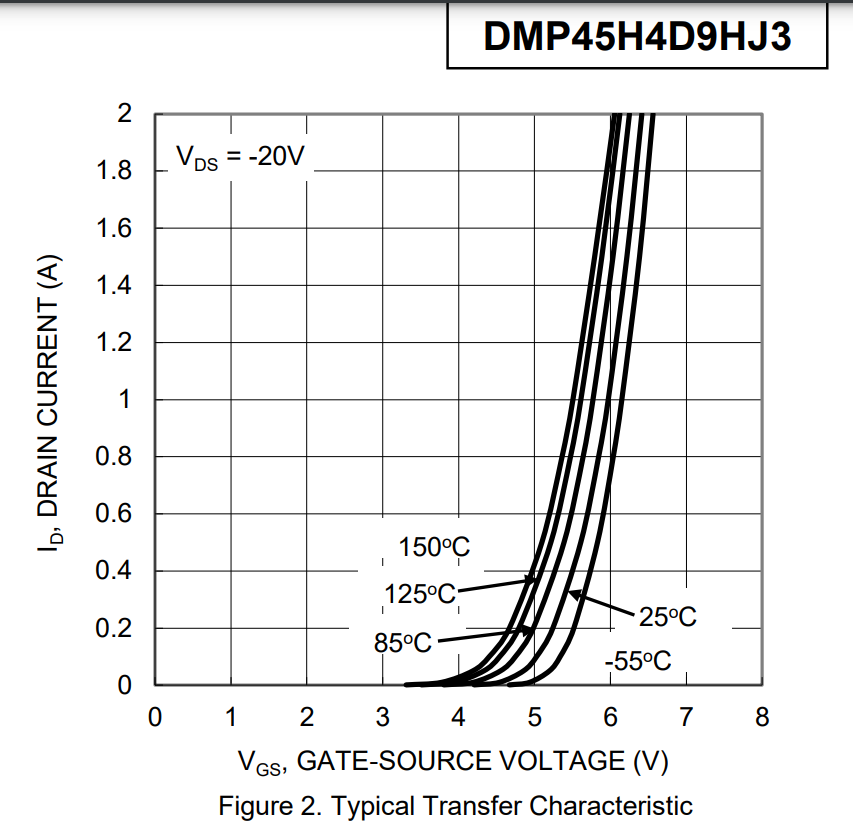

In my listening tests, those devices that had a wide and linear Vgs v Id region around the operating point sounded better. So, lets look at DMP45H4D9HJ3. I presume the current running through the device is less than 100 mA. If you look at the curve below, 100 mA is in the knee of the curve, right near the bottom. That part is not linear. You want to be in the region around 0.2-2A for this device where the current changes linearly as a function of Vgs. Now, while this bottom device is operated in follower mode, where the 100% feedback provides a high amount of linearization, I still heard this effect during listening (with the SCG). And when I switched to devices where the operating point is in the linear range of the curve, it sounded better. The problem is that there aren't any devices in the TO-220 package or any kind of package that can take some heat AND are also linear, by this definition, near the operating point we want. In P-channel devices, there may be none that are linear between 10-100 mA, say. You can check. I switched over to JFETs because they are linear around 10 mA and that is enough for a preamp application.
The caveat with all of the above is that the follower mode somewhat covers for this problem and in reality you may or may not hear this as a problem at all. It all depends on the overall architecture and how things play together. This is also just my theory that I have confirmed in listening, but I have not fully established that there are no other effects.
How much power dissipation is carried by that P-ch device in the UNSET architecture? You may be able to switch to paralleled TO-92 devices if the Pd is not that high (say, less than 1W). Also, I don't want to sound like a downer. For the most part, the follower mode covers this issue, and the gain device is a tube that is linear in the operating region. So, it is perhaps not a big problem. Just find a P-channel device that works and you are good to go. I am simply sharing what I've learned playing with this topology.
The UNSET and SCG bottom device operates as a source follower, which means it has no voltage gain and 100% feedback (these are the properties of a source follower). The middle gain device, the 'Schaded' device, is amplifying the signal coming from the source follower. Looking at simulation models, the distortion looks pretty low coming out of the source follower, but whatever is coming out gets magnified by the gain device. If you look closely, while the distortion products are low, but they are not always monotonic, i.e., H2>H3>H4 and so on. Sometimes, you get products H7, H9 and so on that are highest. Overall THD looks low from the follower alone, but then it gets magnified and coupled with the gain device's distortion products.Sorry for infiltrating this thread, but I am looking at the Tubelab UNSET architecture, which has similarities to this project, trying to find a P-channel MOSFET for the board. The recommended one FQPF9P25 is well and truly unavailable. There is another option that is discontinued, but Mouser may have a delivery next month: FQP3P50.

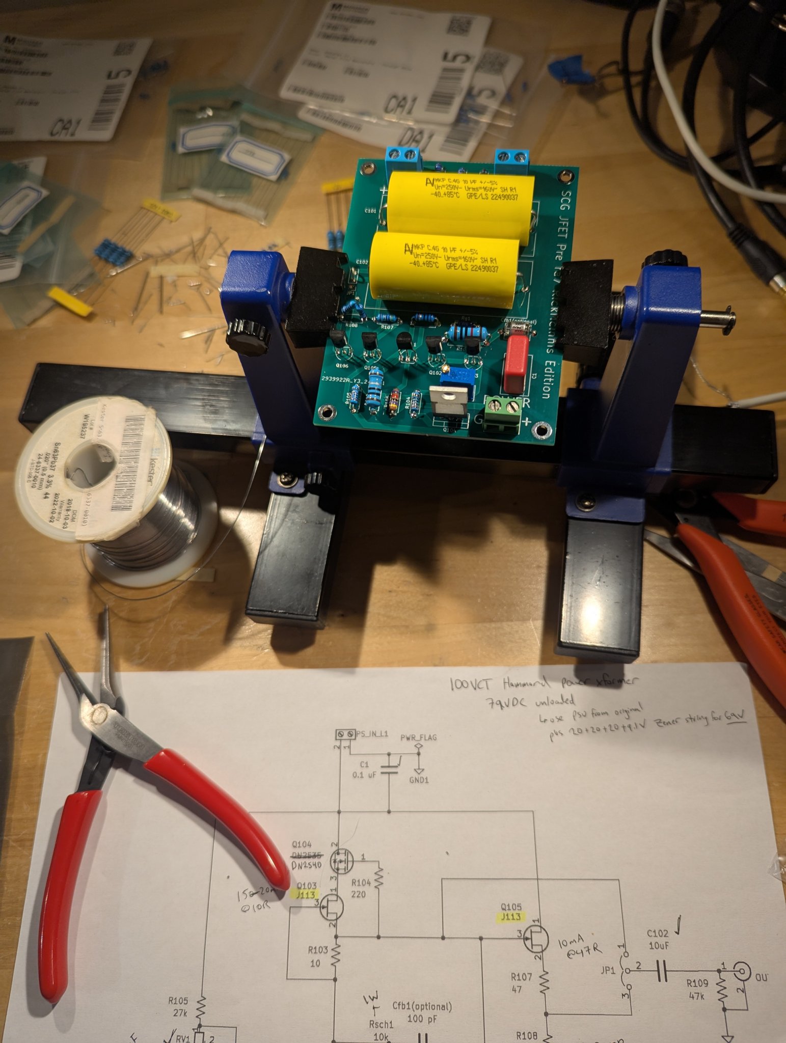

Checked all Mouser projects and made a couple of modifications in some places.
The most important change was: I put in terminal blocks for JP1, as I figured these can be easily jumped and also give you the option to connect leads for a switch that include or exclude the preamp buffer.

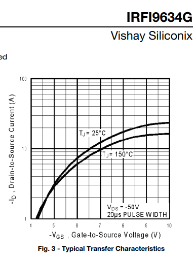

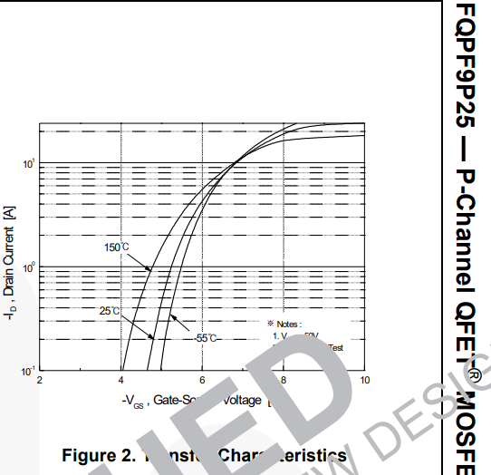

Thank you for the analysis, looking at the part I mentioned.
Looking at Transfer Characteristics for other candidates, including the FQPF9P25 which was specified, they seem to like a logarithmic chart, starting from 1A, so not deemed to be a useful range.
I guess the proof of the pudding will be in the eating.
Yeah, it is hard to tell with the log graph. What these devices have going for themselves is immense transconductance. This means there is a ton of feedback available to reduce nonlinearities. So, it kind of works.

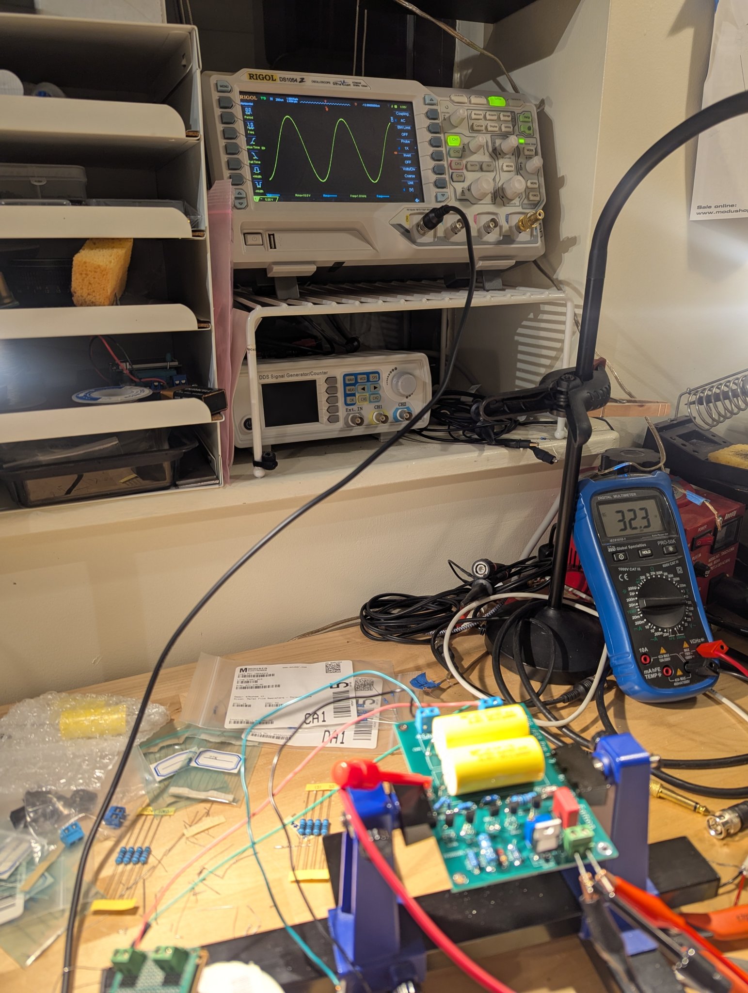

Built up my first board and connected it to my bench supply at 64V.
With C102 centered at 32V, roughly looks like it's swinging about 10Vrms before it starts to clip on the top end of the waveform. By reducing that down to around 28V I was able to get ~13Vrms before clipping.
I plan to run it on a ~70V supply and look forward to tweaking it once I have it set up properly.
I have had a bunch of these parts around since Dec of 2023, feels good to get the latest iteration of the board set up and working.

Beautiful! Thanks for sharing! Very eager to hear your sound impressions.
I have measured up to 15+ Vrms before clipping on mine, though it is powered by about 60V. I would lower the buffer bias current with a 70 V supply. The sweet spot is between 50-60V.
