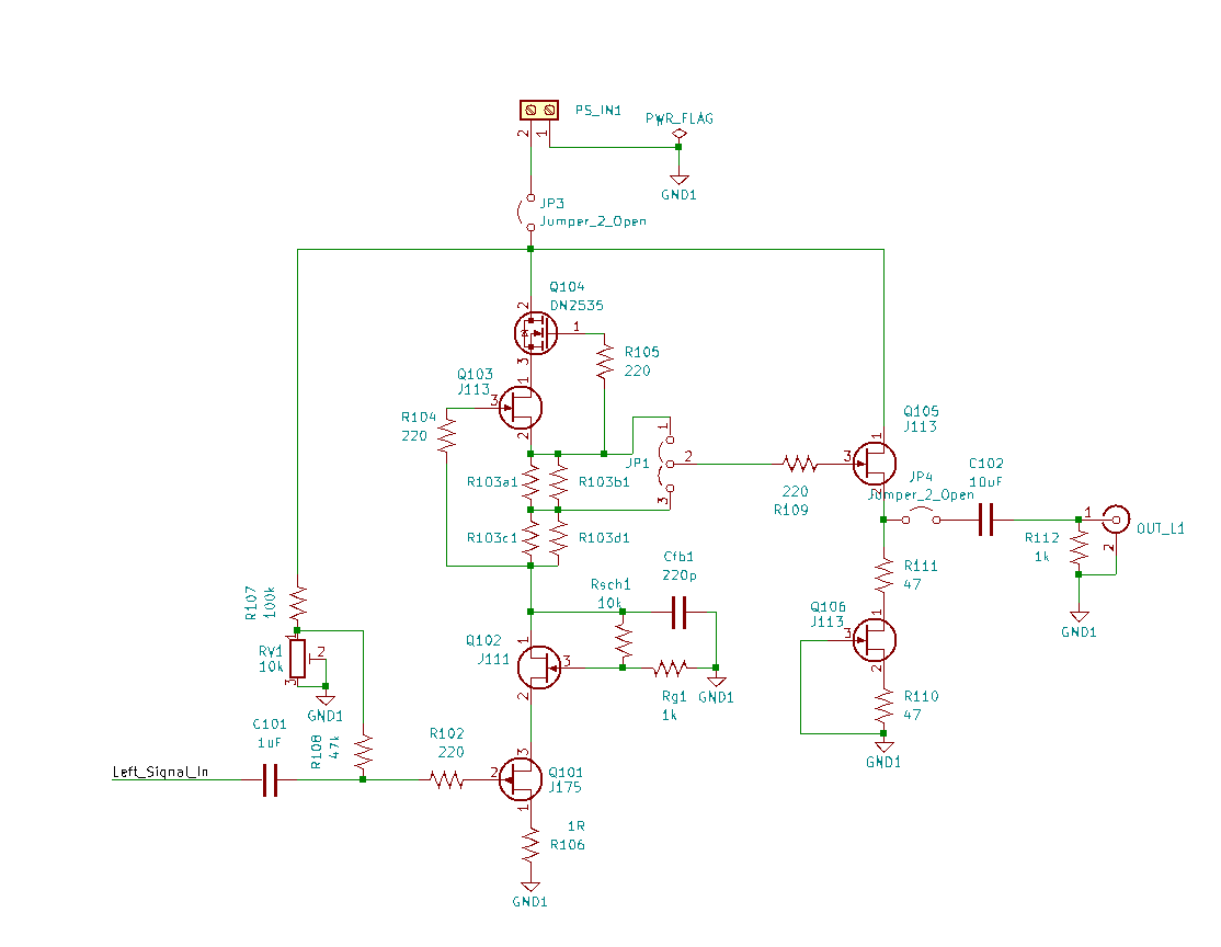

Sure. Note that I have not tested this buffer yet. I have been operating the main circuit into the F4, which has a JFET buffer as input. The main thing to consider is the dissipation. 80V into 8-10 mA divided equally over the two JFETs means they are operating right at the limit. How well it works and longevity is to be tested. It should work but use it with caution and at your own peril 🙂 Of course, we are part of the FAB gang, so we are not afraid.
You can ignore the jumpers, they are for my testing using the hat. Also, R111 may not be needed. Q106 is the CCS fet and R110 controls the current through the buffer. Lower values of R110 result in more current. Q105 should be selected such that at 8-10 mA, Vgs is about -0.25V - 0V.
You will note that the buffer is direct coupled. When the Vds of Q102 is adjusted to be 40V (using RV1), then the gate of Q105 will be at 40V, and its source will be at 40V minus the Vgs value, which is about 0.25V. So, you would get about 39-40V at the C102. I will note that the Vdg will be 40V, which is higher than the spec, so again, it remains to be seen if it works and if it lasts 🙂
The main circuit is mostly unchanged from before except the devices themselves. You could even use the old PCB and swap out the devices. I am calling it the test circuit because the final might change.
Test Circuit
Test Circuit

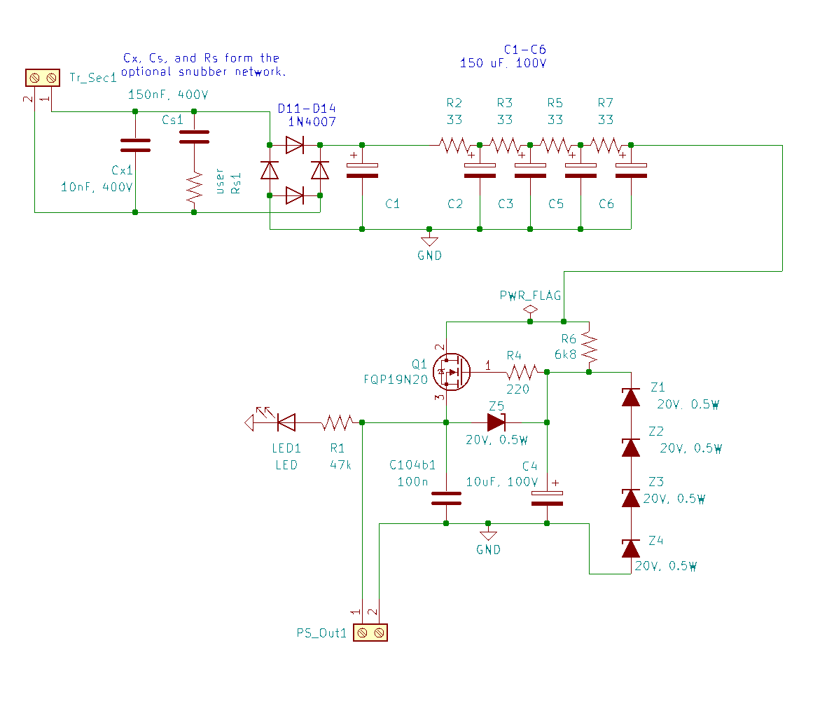

Here is the PS. Same as before, but with improved filtering. C1, the diodes, and the snubber network should be close together. Again, not tested yet. So, use at your own risk. It has high voltage and you have to use the usual precautions when working on this circuit.

Do I remember correctly that you removed the bias on the bottom source follower? I see it is here again. May I ask you why?Test Circuit
I am working on that right now. The design is not too sensitive to the spread in jFET parameters. More on this coming soon.I will be getting fets now, do you have an idea of the number to buy (all types) to be able to build two pairs?
Yeah, it was added to ensure the drain voltage of the gain device can be adjusted. In the previous design, the follower mosfet Vgs plus the gain mosfet Vgs put the drain voltage in the right region. With JFETs, it needs a bit of voltage on the gate to put it in the right place. But, by doing so, the j175 operates with a Vds of 10V or so, i.e., it is in the linear region. The combination of j175 and j111 allows for this and it keeps the design from requiring really high voltage supply.Do I remember correctly that you removed the bias on the bottom source follower? I see it is here again. May I ask you why?

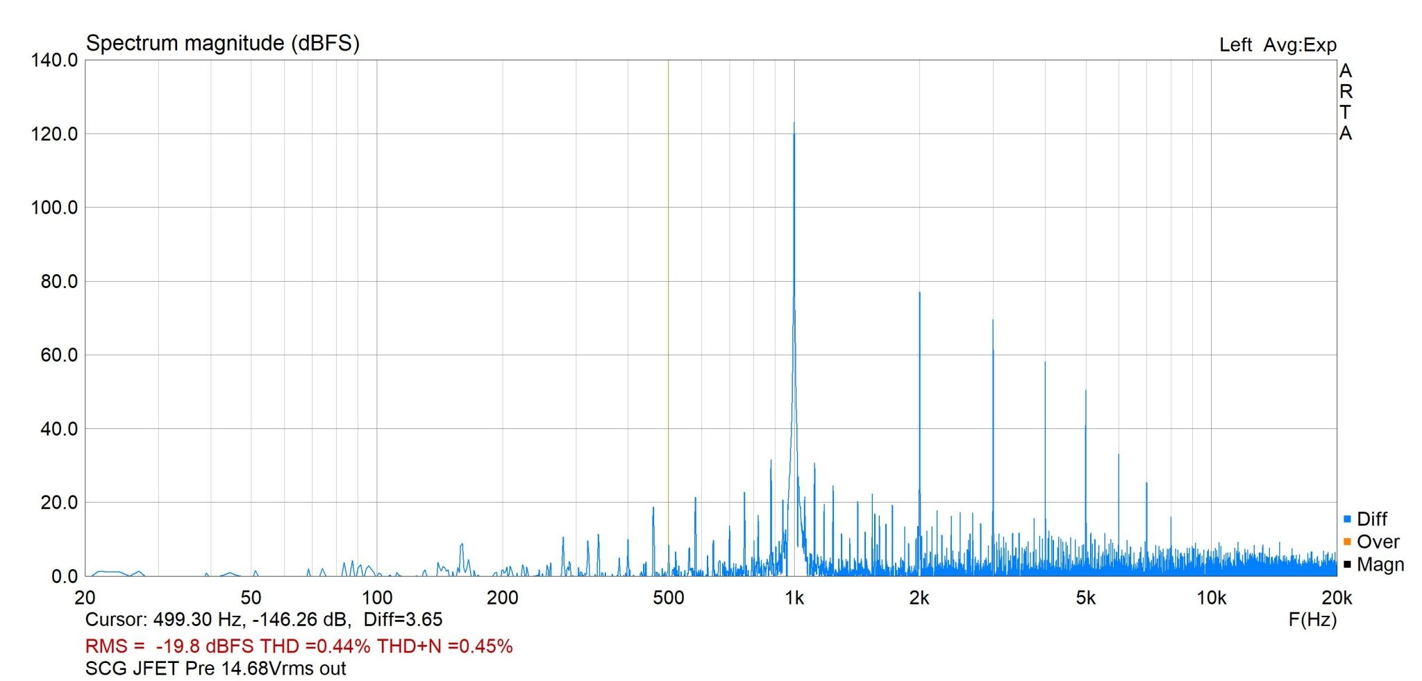

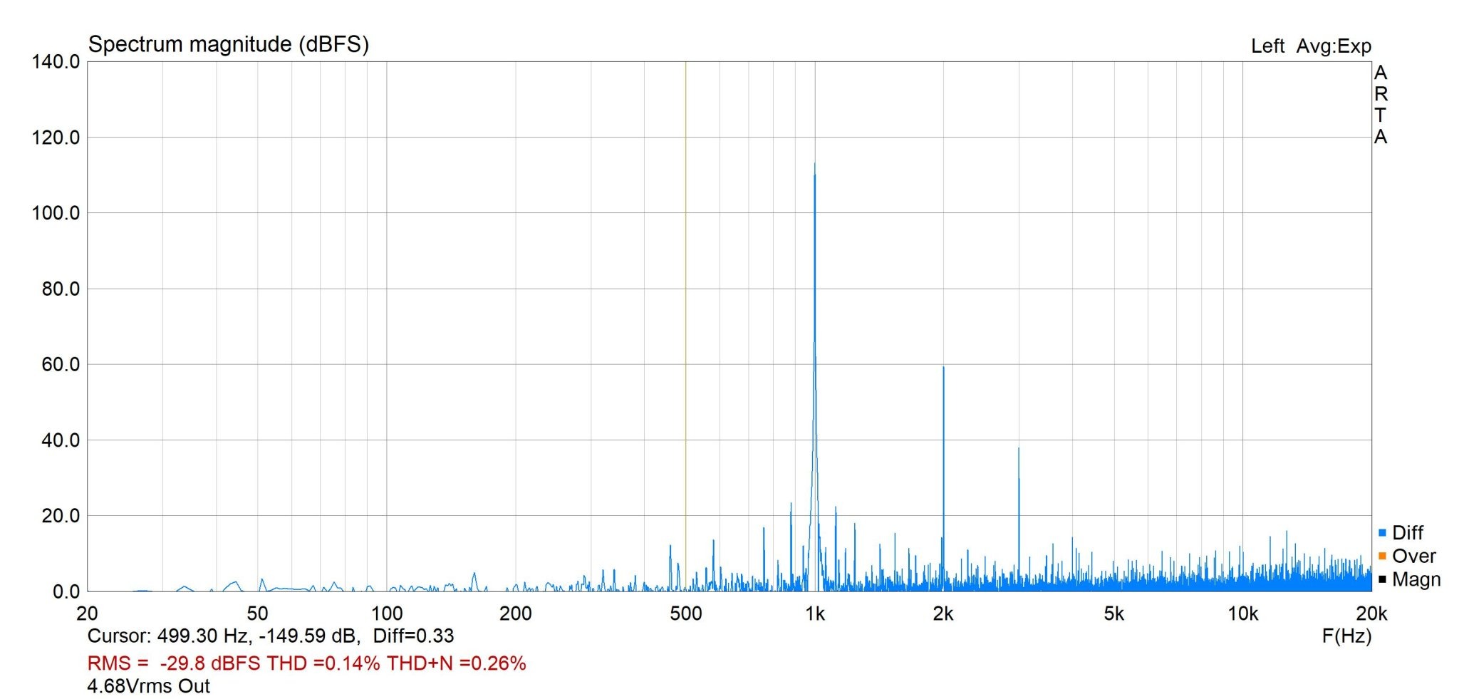

Made a few measurements today.
41 volts peak to peak (clipping the F4): 0.44% THD with a nice spectrum. I was measuring clean output to about 60V peak to peak. It could do even more but this is more than enough for a preamp. Headroom is good.
About 11Wpeak into 8 ohms (13.2Vp-p):
At about 1W, it does near 0.05x% THD.
All of this is without the buffer into a 10k load provided by the soundcard (RME ADI-2 Pro). The buffer is limiting the peak output, so I am still working it out.
The whole premise of this design was solid state triodes. The performance (and sound) bears this out. So, I am happy.
