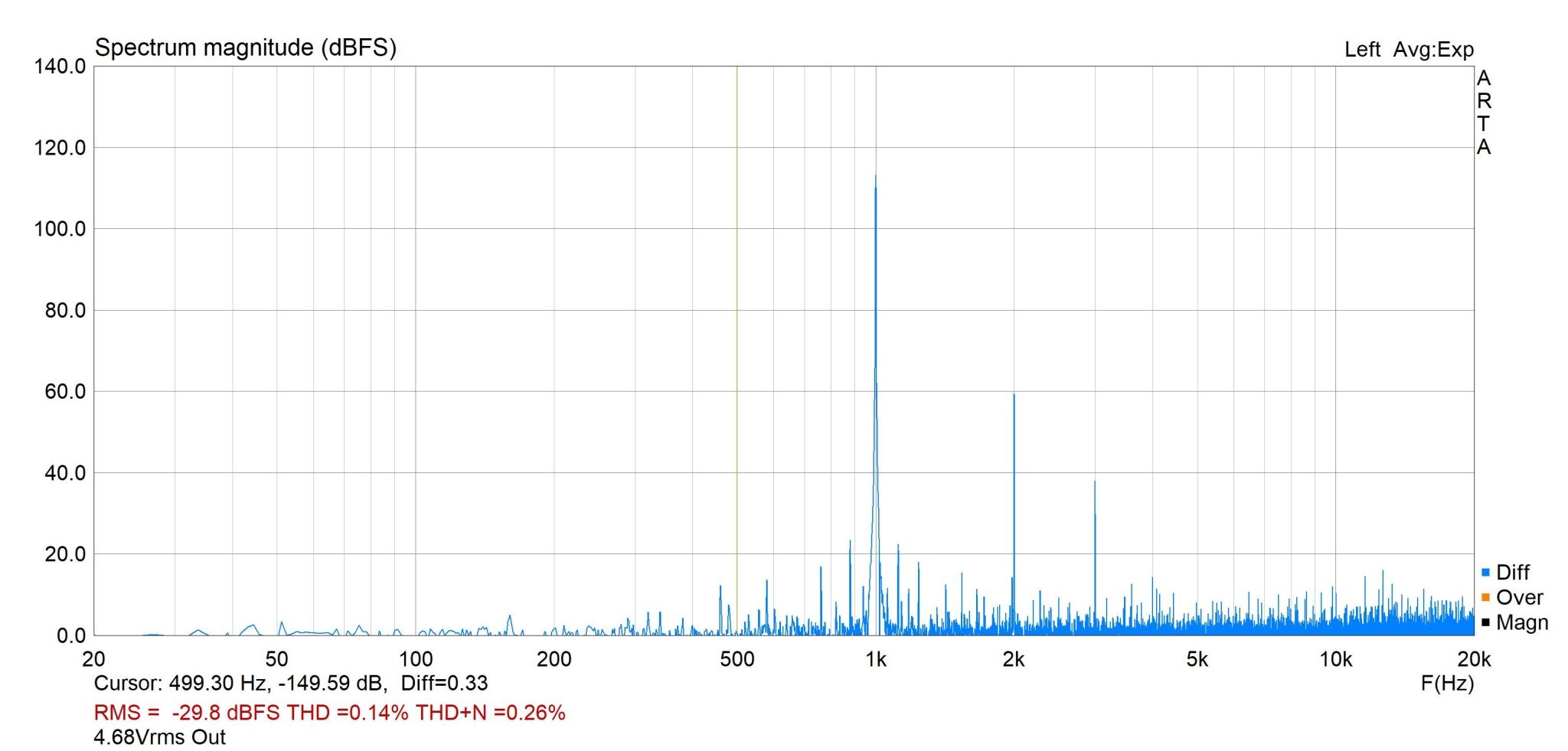

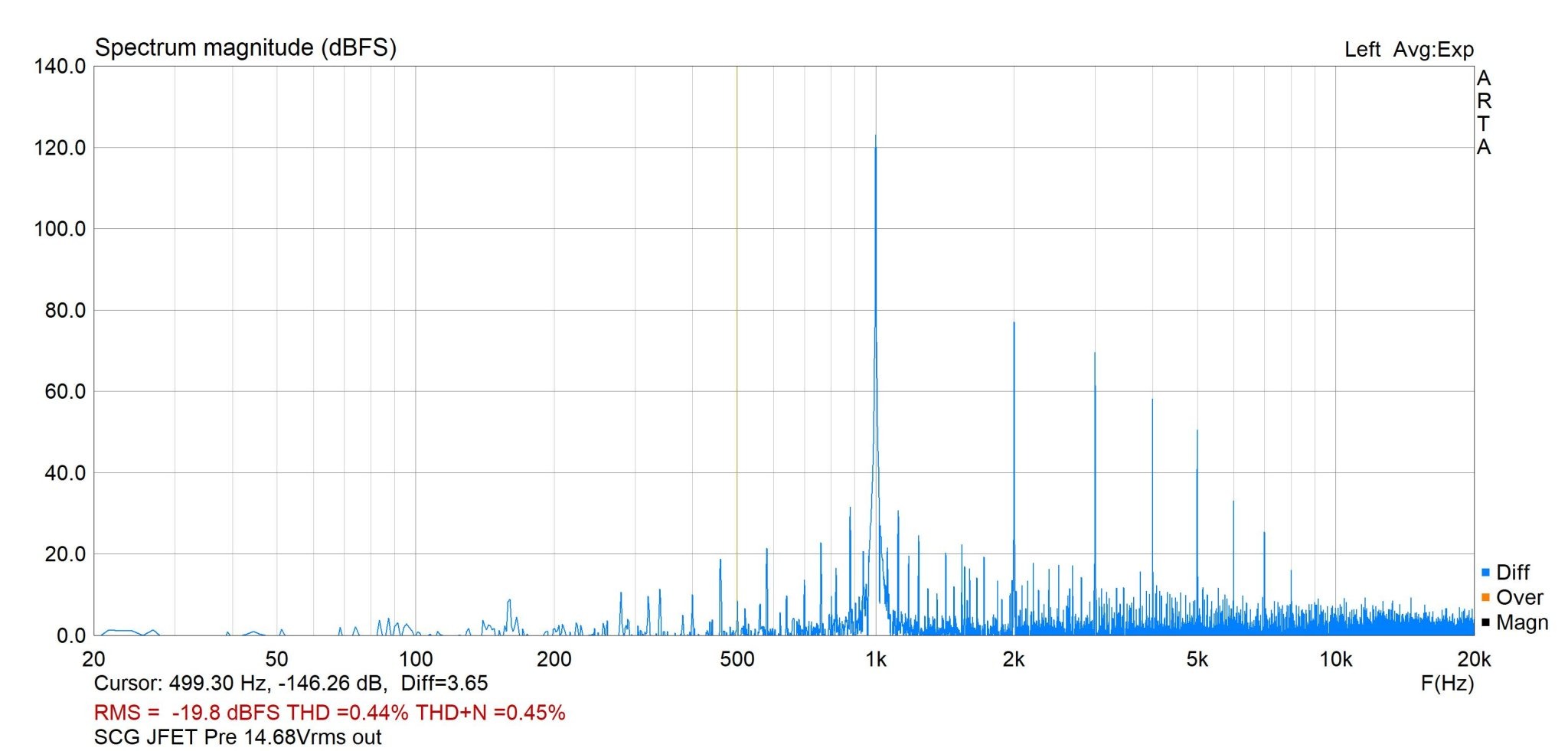

HiMade a few measurements today.
41 volts peak to peak (clipping the F4): 0.44% THD with a nice spectrum. I was measuring clean output to about 60V peak to peak. It could do even more but this is more than enough for a preamp. Headroom is good.
About 11Wpeak into 8 ohms (13.2Vp-p):
At about 1W, it does near 0.05x% THD.
All of this is without the buffer into a 10k load provided by the soundcard (RME ADI-2 Pro). The buffer is limiting the peak output, so I am still working it out.
The whole premise of this design was solid state triodes. The performance (and sound) bears this out. So, I am happy.

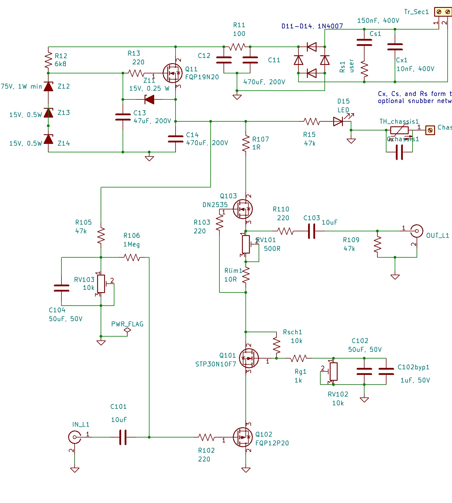

The latest iteration builds on those mods by replacing the input and gain transistors with JFETs. That is the biggest change. It can be done on the old PCB. In fact, I was using the old PCB to do all the testing. I can post what needs to be changed, if that would be helpful.Hi

Here's the changes to make from the schematic in post 1193:
1. Set the CCS to 14-16 mA. Measured across Rlim or R107.
2. Short zeners Z13 and Z14 to ground. We are looking for a 70-80V supply at the top of Q103. You can take the two zeners out and put a shorting wire across the holes. Or you can create a string that hits 75-80V.
3. Short C102 to ground. It might be easier to short the C102 bypass cap. Either one works.
4. Replace Q101 with J111. The drain and source of JFETs are interchangeable. So, the hole pattern on the PCB will work if you put the JFET in reverse. Just make sure the gate pin of the JFET goes in the gate hole.
5. Replace Q102 with J175 or J74. Again, the PCB hole pattern works for these JFETs.
6. Turn RV103 until you get about 40V at drain of Q101, could be measured at either end of Rlim. Be sure to set the CCS current before replacing the two JFETs.
