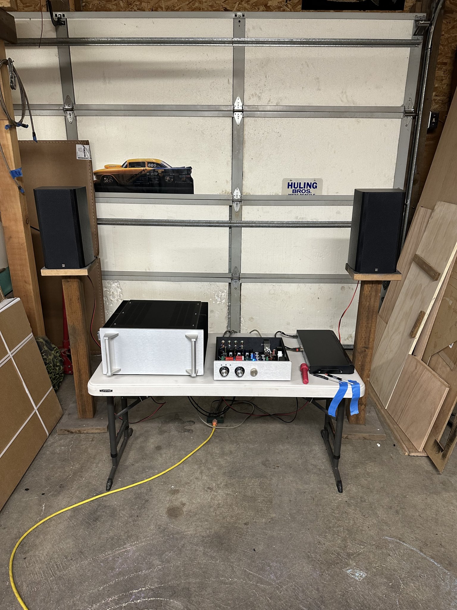

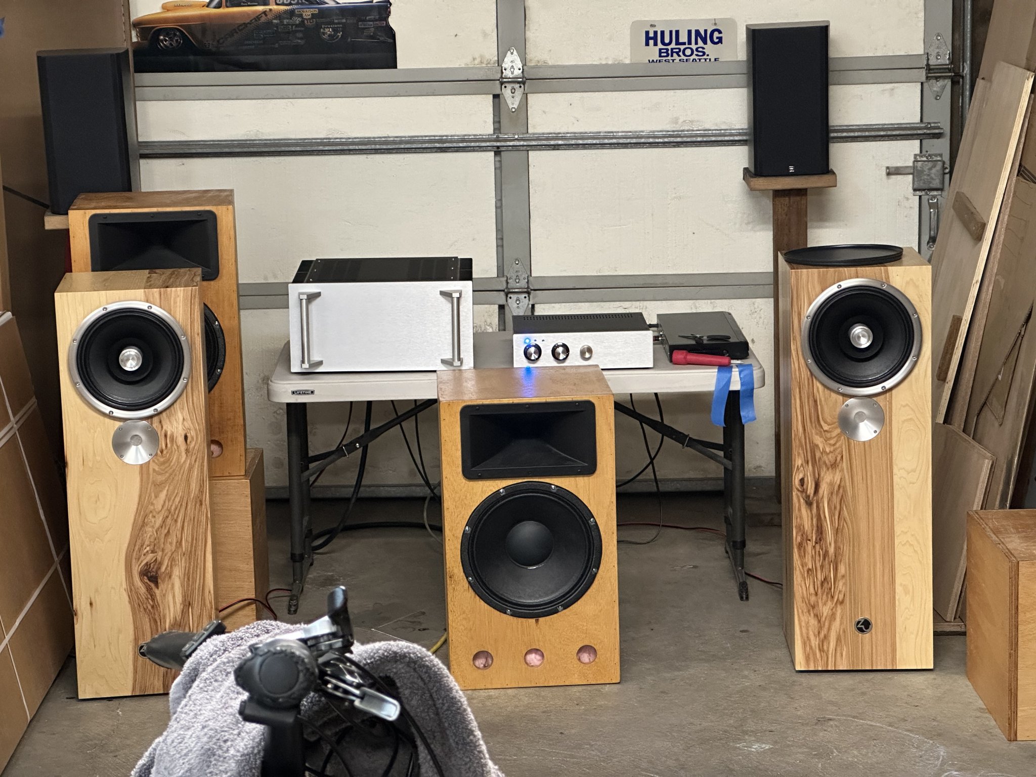

We’ll. It is playing music. No hiss or hum! Driving the F6. Sounds very full right from the get go. Needs time to break in, so I’ll throw several hours of CD’s at it. Started off with Louie Bellson/Jazz Giants. It’s kinda my westone bridge.

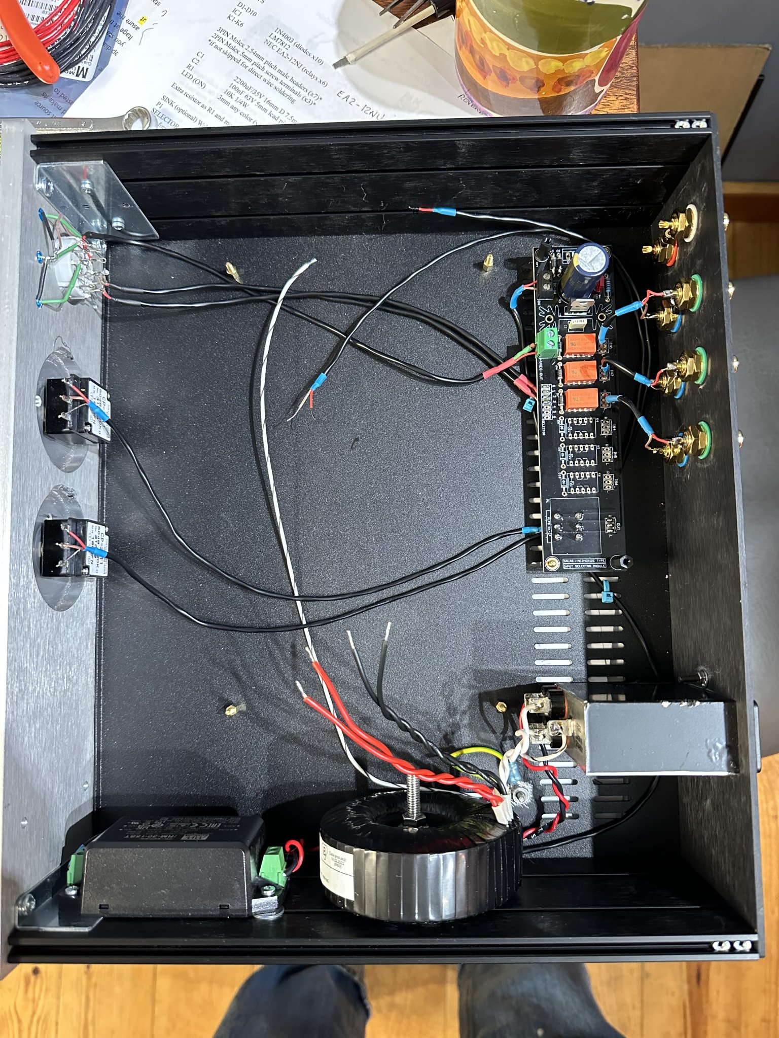

The cable is mogami 2944. Ya gotta love those Salas I/O boards!
Thanks RA7 for a very honest pre…it is truly very well designed. I would encourage anybody to give this a build.
I’ll bring more impressions after break in & comparison to a few other pre’s I have.
Only issue are the LED’s for the selector switch not working…not sure what yet as they were pre-tested. Always something ehh.

Continues to play (Adason)….sounding very good. More soon.
Gorgeous speakers!
