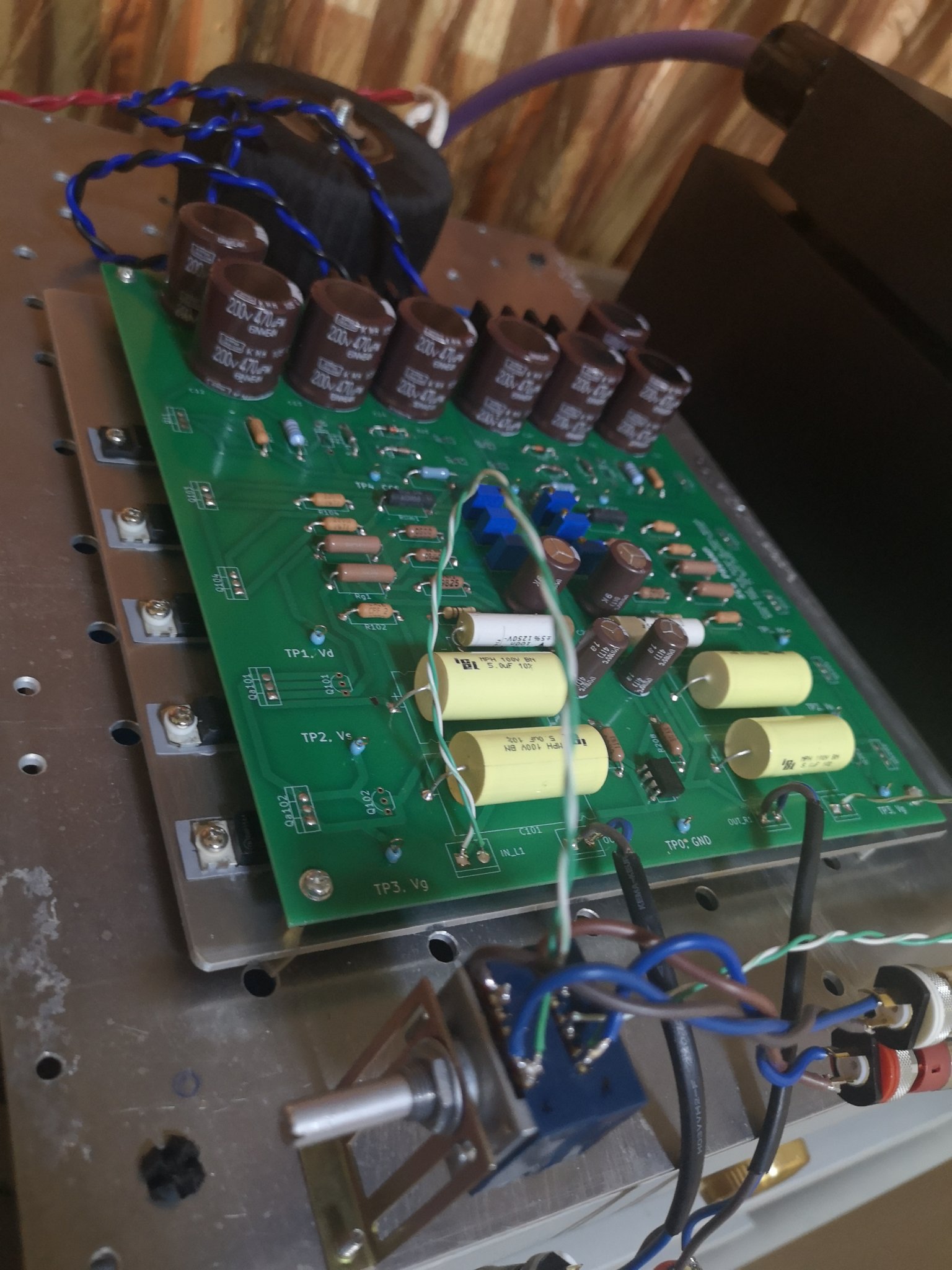

I haven't experience any buzz on my 100K TKD pot.Back to the SCG. I am getting some buzz on both channels with a 50k Alps pot at the 12-3 pm positions. It goes away below 12 pm and above 3 pm. What's the experience of others (@Alfi, @Vunce )who are using pots before the SCG? Getting any hum/buzz pickup at various pot positions? It could be the specific pot, but I want to ask before I dissemble it.
Thanks Vunce and Alfi! I’ll try NTC connection and see if it cures it. Or, it might be a faulty pot.

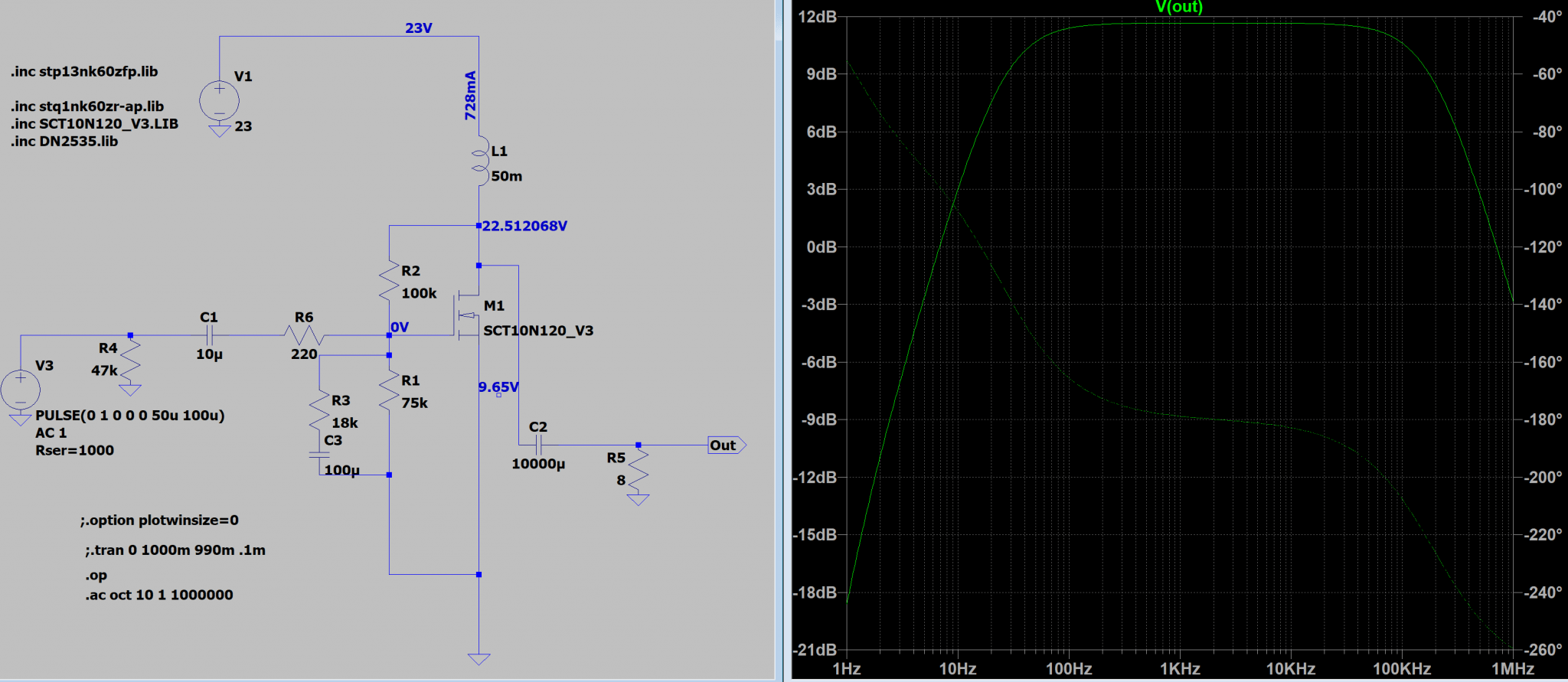

With R2 100k and R6 220 ohms there is virtually no Schade feedback and output impedance is very high, but good frequency response. Did the circuit you actually build have a higher value for R6 which would restrict bandwidth due to mosfet input capacitance? With output from the source the effective input capacitance is much lower so bandwidth would have been better.A little off topic, but thought George (@Tubelab_com) might be able to help me. I experimented with a power amp using the Schade method. Here's the schematic.
I am getting very poor bandwidth at the top end. Probably not even making it to 10 kHz and quite a bit less than the sim. Getting good bit of gain. The device is an SCT10N120 with nice looking curves. It biases up exactly as shown. This is not an SCG topology, but it is identical to a Zen amplifier just with an SiC device. I even added 1000 ohms of source resistance to the input voltage generator, but the sim still shows very wide bandwidth.
The same device but with the inductor on the source and the output taken from the source pin sounds quite good. Okay, it is no VFET, but it sound like a decent class A amplifier. I pushed it to 1.5 amps and it was doing fine.
I made R1 into a 100k trimmer pot for easily changing the bias. It works nicely. The bias does wander a bit, but mostly stays close to where you set it. Certainly could be improved.
The inductor is the Hammond 193T. The chassis and setup was my choke-loaded VFET amp, but I pulled the VFETs for the OS2 amp and now using the setup for experimentation![]()
The amount of feedback in this circuit is highly dependent on the impedance of the source that is driving the circuit.With R2 100k and R6 220 ohms there is virtually no Schade feedback.
This could be part, or all of the hum / buzz issue as with a pot at the input the fet sees a variable input impedance depending on the pot setting. This results in variable feedback and possible instability or oscillation at some pot positions. With the pot all the way down the gate sees 200 ohms to ground. With the pot all the way up the gate sees whatever the source impedance is paralleled with about 25K. With the pot at midrange the gate sees a minimum of 12.5K as the pot is essentially two 25 k resistors with one grounded and the other going to the source.
The 30 pF cap was an experiment to try on the simulator to see if it reduced the bandwidth as it's closer to what you have in your actual circuit. Adding more capacitance to the actual circuit would only reduce the HF response.

Yes, you are absolutely right. The circuit I built did have 220R for R6. It looks like this works as a virtual earth amplifier, where the node between R6 and R2 is the virtual earth. R6 should be increased and R2 decreased, maybe like 5k and 50k combo might work given a source impedance of 500-600 ohms. Might need some experimentation. If you look at the first few Zen amplifier articles, Nelson uses 4.75K for R6.With R2 100k and R6 220 ohms there is virtually no Schade feedback and output impedance is very high, but good frequency response. Did the circuit you actually build have a higher value for R6 which would restrict bandwidth due to mosfet input capacitance? With output from the source the effective input capacitance is much lower so bandwidth would have been better.

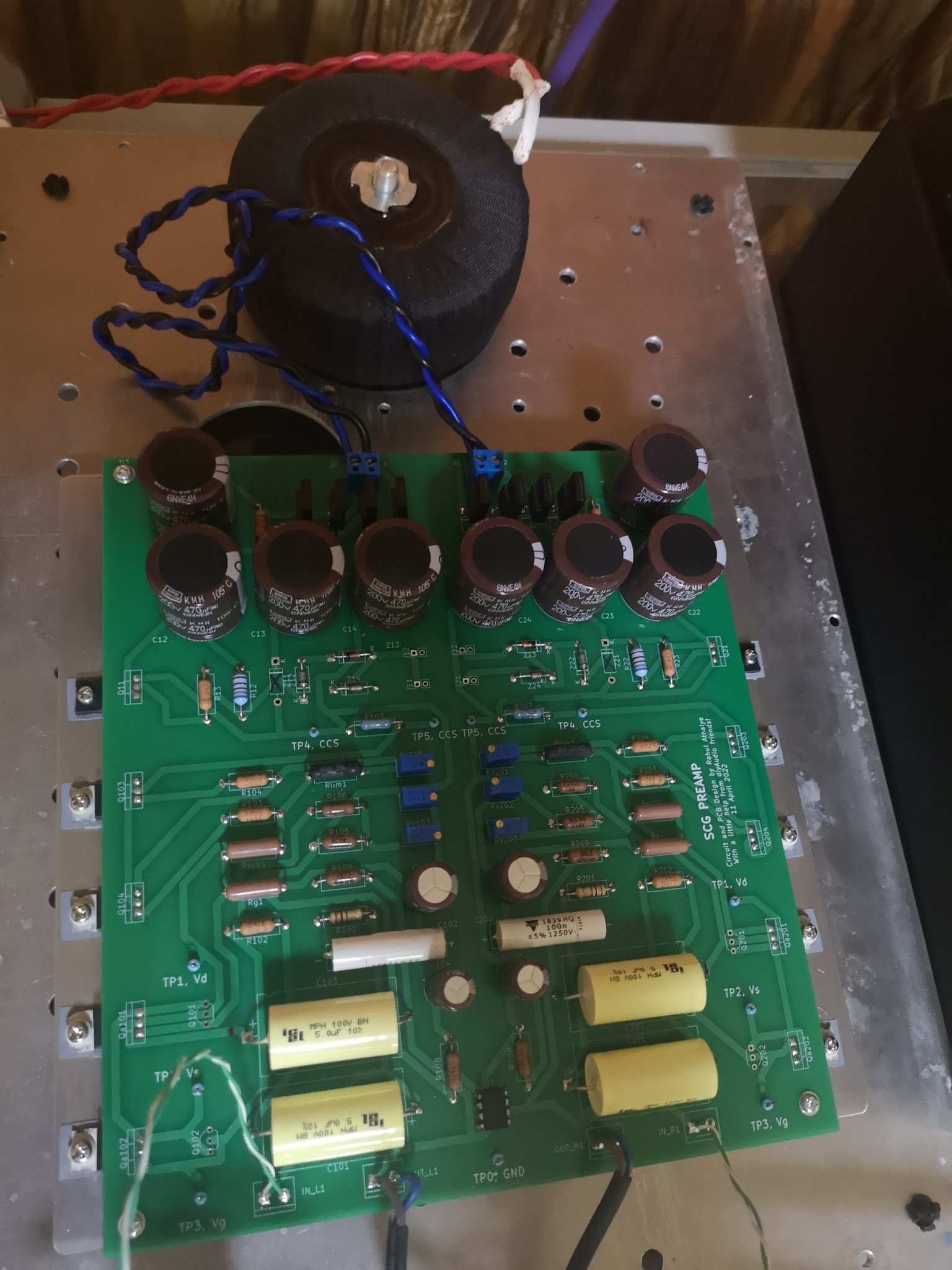

Making progress on the updated PCB. The only thing I haven’t tested is the output buffer, but I am going to skip it and keep the simplicity. Performance is quite good and output impedance low enough to not worry about it. The only benefit might be better AC loading with a buffer, with the tradeoff being more components.

Will post the schematic later and maybe start it’s own thread. Need to figure out how to better control the bias. On one channel the bias runs away a bit too fast for my liking. I believe it is the gate current issue that Ben and ZM have referred to in other threads.

Sorry that my progress is slow. Life issues got in the way but I am getting there. Transformer reached me yesterday evening, installed and adjusted the parameters as suggested by ra7. I have also set the gain to 6X so that I have more flexibility in using it to drive my a few different amps. Currently still waiting for my actual chassis to be delivered while I mounted it on an aluminum plate to test. First impression is very positive. Warm, powerful sound. Will let it run for a few days before I listen critically.
