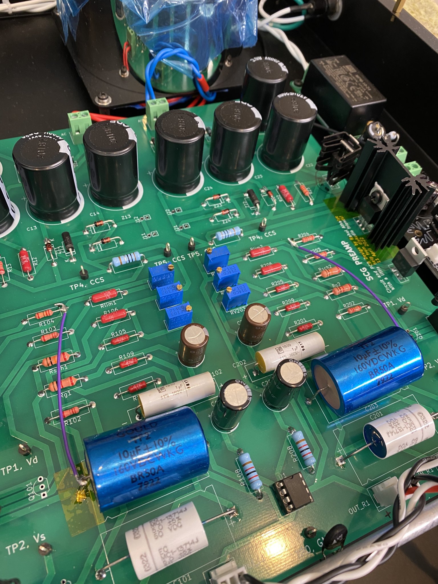

Modded SCG has been driving my Big Mofo’s going on 10hrs now. I’ve been carrying on my day as normal with random stops for listening. I would say this mod is an improvement, although not a drastic one in my system. The music has more air to it, my living room seems bigger and the speakers were harder to place. This was more evident listening to genres like smooth Jazz, orchestral, rock and modern country. I didn’t notice a difference listening to alternative and heavy metal. For you fellas in possession of this pcb version SCG, the modification is so easy to do, try both ways. I will leave mine set up with the Mu-Follower mod in place!

Thanks Vunce! That is pretty much what I heard as well, though it was more dramatic for me. The speakers were disappearing earlier, but now the walls have completely melted. Such an ease and naturalness to the sound. Even more so than before. Now I am fully 'there.'

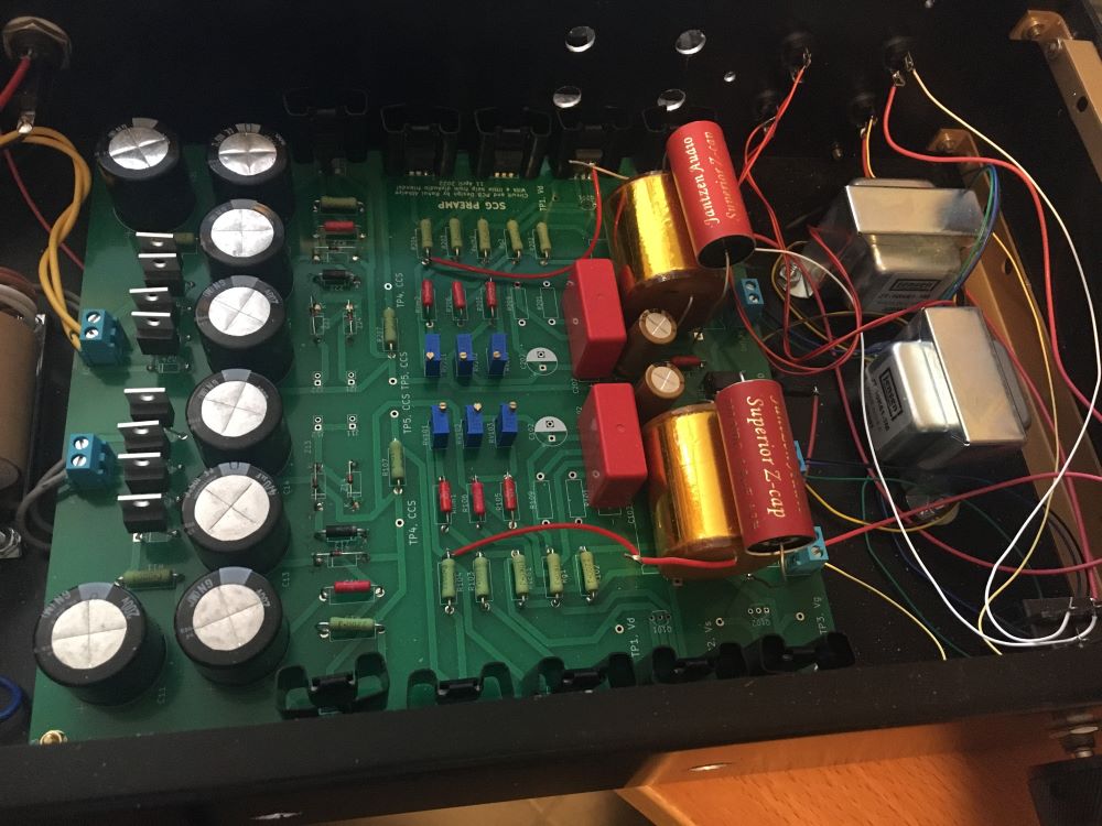

Rahul,
I built a headphone amp using your Preamp PCB where the output is connected to an output transformer(Jensen JT-10K61-1M).
It's driving my Sennheiser HD600 headphone.
I really like what I'm hearing, it's transparent and nature sounding with good imaging.
Thank you for the design and for providing the PCB and gain devices.

Vunce,Your build looks great Alfi! I see you went right for the Mu-Follower mod, good choice IMO. Cool idea to make an HPA with SCG.
Thanks. I used the pics of your build as a reference when I was soldering in the parts.
Regards.
Rahul,That is awesome, Alfi! Another great build. Congratulations!
How did you wire the Jensen's?
Looks very neat!
I omitted R109/R209. I wired the primary of the jensen across the output of the PCB.
I wired the jensen's two secondaries in series for a 4:1 step down.
I believe this results in an overall gain of 2.5 for the headphone amp.
Regards.

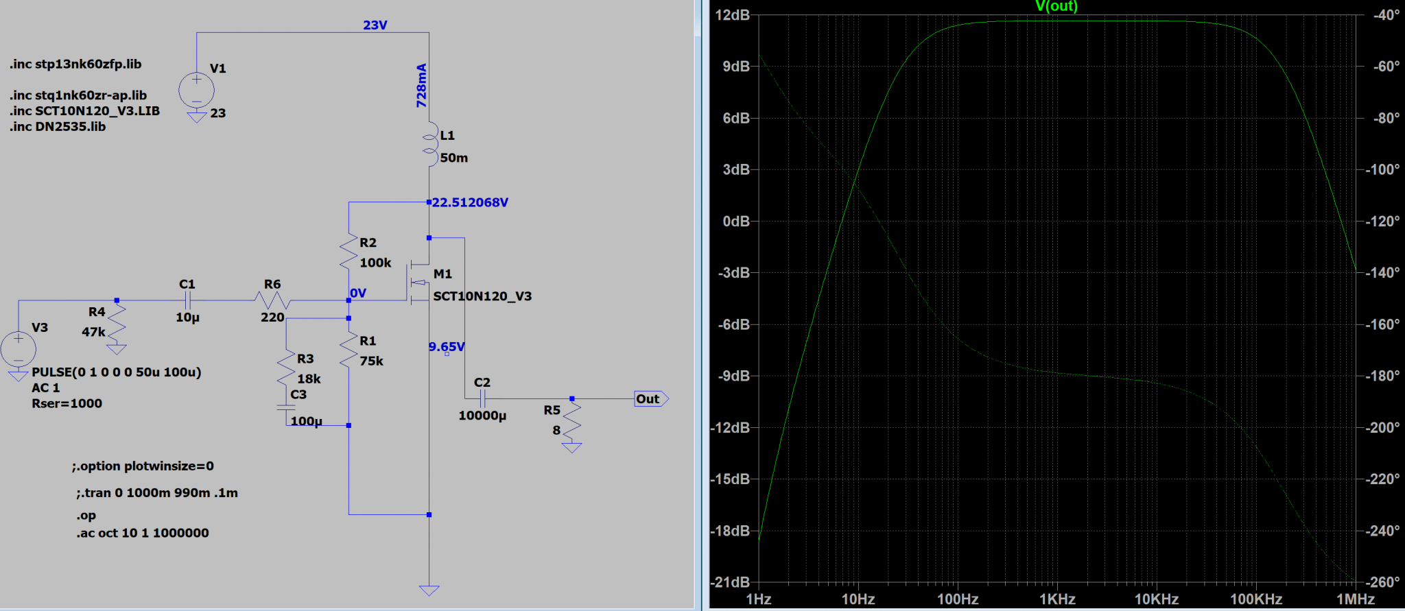

A little off topic, but thought George (@Tubelab_com) might be able to help me. I experimented with a power amp using the Schade method. Here's the schematic.
I am getting very poor bandwidth at the top end. Probably not even making it to 10 kHz and quite a bit less than the sim. Getting good bit of gain. The device is an SCT10N120 with nice looking curves. It biases up exactly as shown. This is not an SCG topology, but it is identical to a Zen amplifier just with an SiC device. I even added 1000 ohms of source resistance to the input voltage generator, but the sim still shows very wide bandwidth.

Try sticking a 30 pF cap across R2 in your sim and see what it does to your HF response. The spec sheet shows 9 pF with 400 volts across the part, but the graph shows about 30 pf with 10 volts across the part. It also varies a lot with the signal voltage in the range you will be operating it at.A little off topic, but thought George (@Tubelab_com) might be able to help me. I experimented with a power amp using the Schade method. Here's the schematic.
