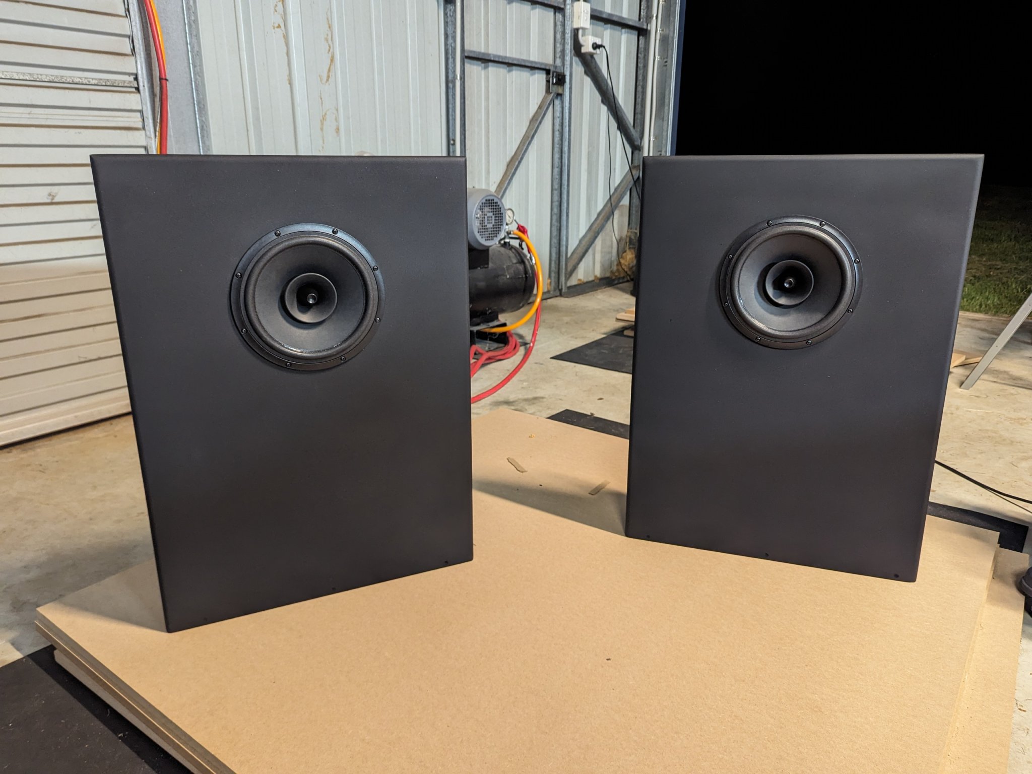

Thought I'd give these drivers a go in an open baffle arrangement to see if I like the open baffle experience (never tried it before).
I'm really enjoying these things! I could add a small sub a be pretty happy for a while. Even without a sub they are fine for some genres. I am finding that they don't need to be too far from the wall, 70cm from baffle to wall is great. Highly recommended as a cheap experiment! Give them a go!
P.S. don't toe them in. The off axis response is flatter. Straight out is best IMO...

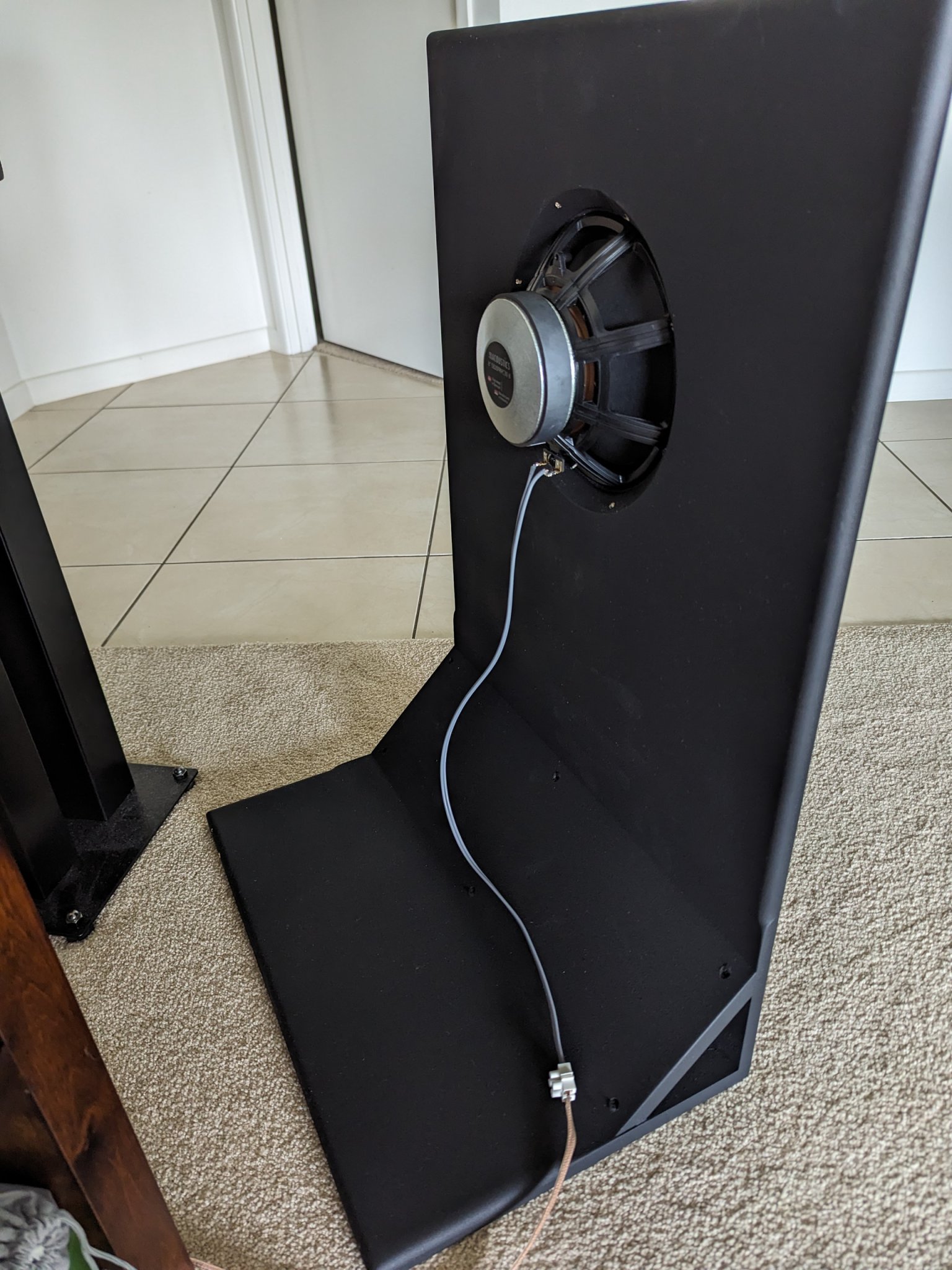

How deep is the extension with these baffles?Thought I'd give these drivers a go in an open baffle arrangement to see if I like the open baffle experience (never tried it before). Other than very little bass (as expected) they sound pretty good! I might try some kind of baffle step compensation or inductor in series to see if I can increase the bass output slightly. The baffle size is 50x70cm with the driver centres 20cm from the top edge. Any thoughts on a good starting point?
Will definitely be trying a "proper" open baffle design next with some 15" woofers.
Do they hit 100hz?
I suspect there is some 100hz information but I don't trust my ears when it comes to measuring frequency response. I find them enjoyable with easy listening vocals and simple music that isn't too bass heavy to begin with. If bass is your concern, I would not recommend them on their own. The bass is very thin with EDM or hard rock beats for example. Present but thin. Deep male vocals sound great though. They also play loud!
As a way of experiencing the spacious presentation of an open baffle speaker without spending more than $200AUD for a pair they are great. I could add a sub and be pretty content for a while with my half deaf ears.
Btw, in the event you try to build them, you will see in the attached photo I have a 45 degree brace at the bottom. I am not sure if/how this might be impacting the sound but it's all coming together in a way I like. Though I will add the caveat that after 20 years of being into audio I can appreciate imperfect things for what they are! These are by no means perfect at the frequency extremes.

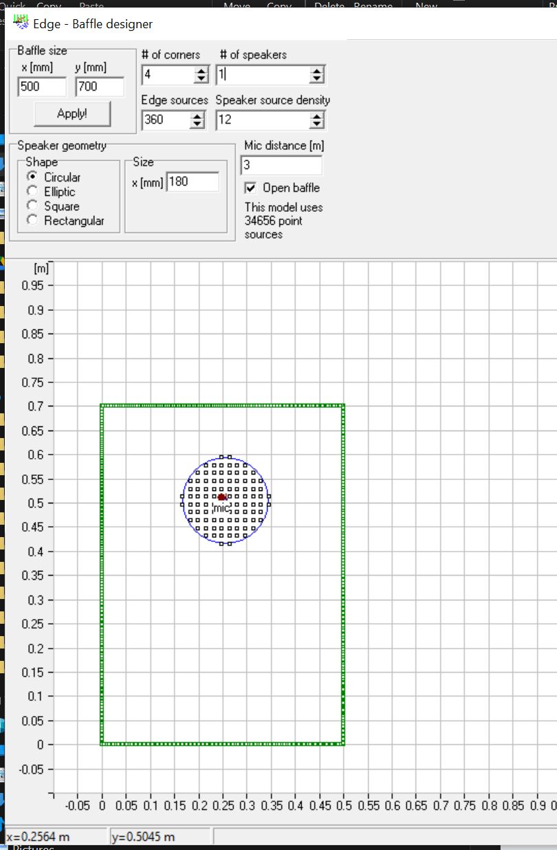

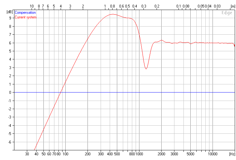

I suspect they would, if you actually tried to optimise the baffle size or add some wings, etc. I just built a baffle that had visually appealing dimensions, It's not optimised at all. Below is the response that edge predicts for this baffle size. 100Hz is about 5db down.
The baffle gain is pretty extreme but it's in the vocal region so I find it quite satisfying.
You can flatten the response dramatically by offsetting the driver of course.

They would, but it is stretching it quite a bit.I was just wondering if they’d go low enough to cross directly to a subwoofer.
Their Fs is low indeed, but their Qts is also low so not perfect for OB.
Instead of Edge try to simulate them in Basta, Edge's cousin.
You'll see immediately what's happening.

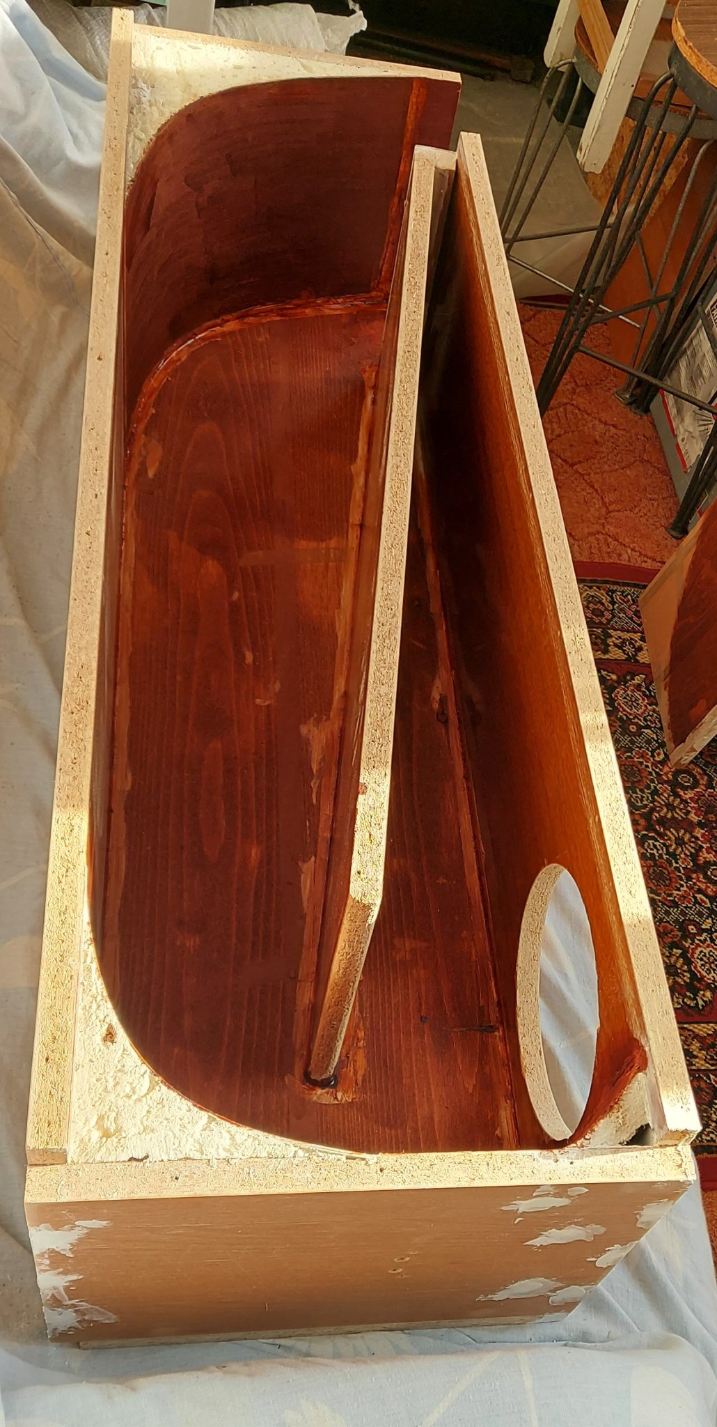

I ordered SB20FRPC30-8 after reading this topic.
Now I have to decide between the DDVP-20 and this version of the Voigt Tapered Pipe enclosure.
