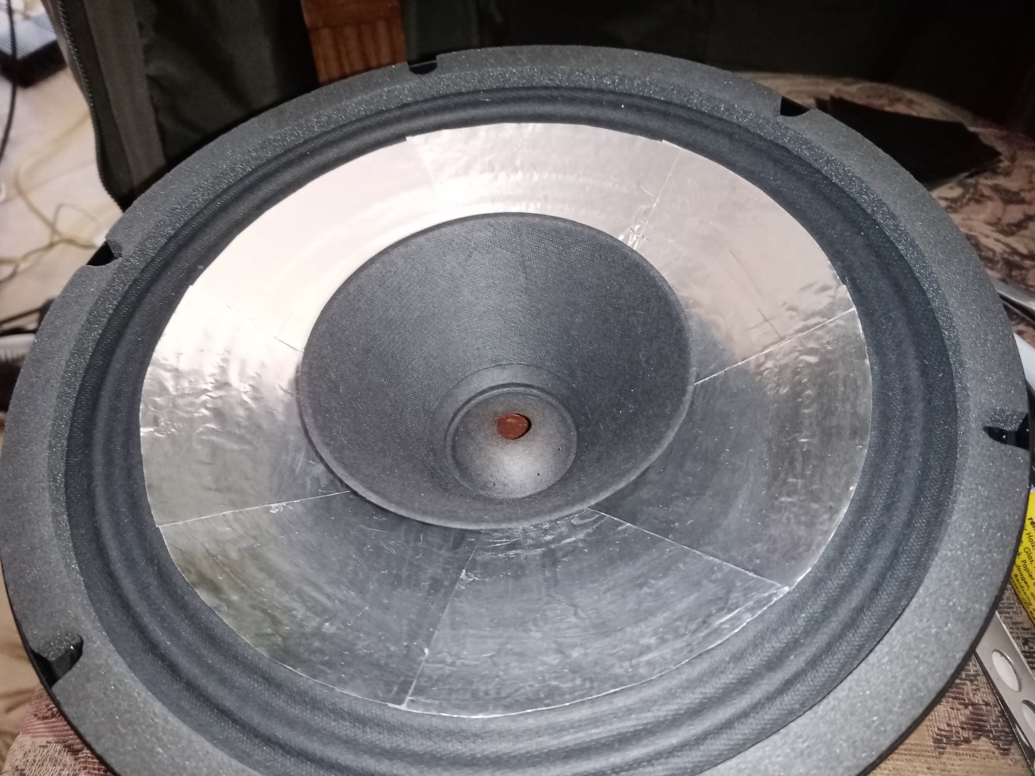

The ultimate DIY tweak in my eyes is aluminum foil on paper cones.
Here a Beyma 8 ag/n
See
https://www.diyaudio.com/community/threads/how-to-make-a-loudspeaker-sandwich-cone.402917/
Here a Beyma 8 ag/n
See

If this was ultimate, wee'd see it much more... ;-)The ultimate DIY tweak in my eyes is aluminum foil on paper cones.
What does the tweak intend to do and can you provide relevant clinical data that supports that there is a benefit?
