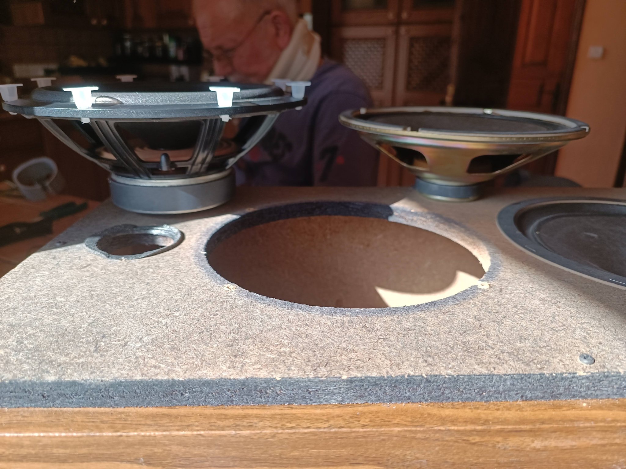

So I got the drivers and I wanted to try them out before installing in the car. I installed them in an enclosure of some vintage 2-way Sony 8 inch speakers with passive radiators and they seem to have a lot of potential, so now I want to buy another pair (one for the car and one for the speakers).
I need some help deciding what's the best approach to utilise the enclosures as I love their look. The enclosure is about 26L, 15.5x30x56cm
a) Replace the passive radiators and if so with which? I have no idea about radiators and how much difference they will make but my options for 8'' seem to be limited to
SB Acoustics SB20PFCR-00
Dayton Audio Designer DSA215-PR
Dayton Audio DS215-PR
b) change the front panel of the speaker completely and go sealed
c) change the front panel of the speaker completely and go ported
d) leave the old radiators and use it as it is using low shelf filter
I get the feeling that the current radiators make the mid bass sound muddy. As they are currently they drop really quickly below 75-80 hz. I want to make them reach as low as possible before using DSP.

26L total sounds pretty small for the pair, but if you make it leaky enough it’ll probably work
Styjp, he is saying to replace the passive radiator with a woofer run in a 1.5 way configuration. Coil and maybe zobel on the woofer and no components on the full range. Resistive vent usually go on the back.
It’s techniqually too small a box for that driver with a passive radiator. You need about twice that size. But if you must, you could use the matching SB 8” passive radiator.
If it was me, I’d block off the opening for the passive and use it sealed. Near wall or with a sub it’d sound quite strong in the bass
Thanks, now it makes sense to me, was confused with the model numbers. I am thinking of going sealed and maybe add a port tuned at 45hz which I can use in sealed, ported or aperiodic modes. Would this make sense in a 26L box with a single driver?
It’s probably too small ported but no harm in trying. But a lightly stuffed port makes a pretty good aperiodic. Heavily stuffed for sealed.

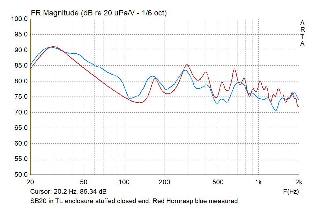

SB20 in 90 litres TL with offset. Stuffing 20 litres at closed end and comparison with Hornresp data (port output):

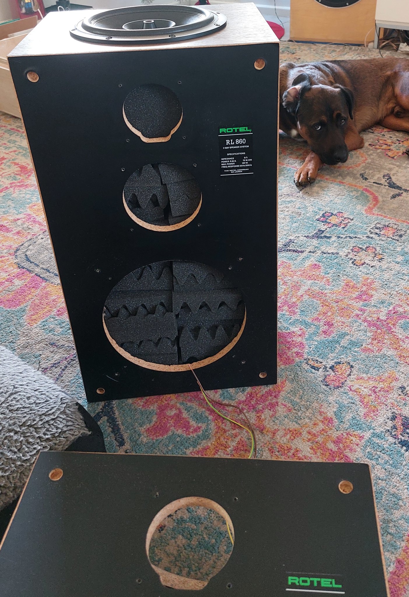

Finally got around to putting them into an old enclosure. I've got a mountain of this open cell eggcrate foam so that went in there. Very roughly set up over a 15", so far sounds quite detailed. Haven't bothered sealing the old driver holes yet as they're lying on some carpet tile and rolled off at 400hz.
Just a thought. The label on the back of the driver feels like it might be covering a vent? Would removing it improve things?
