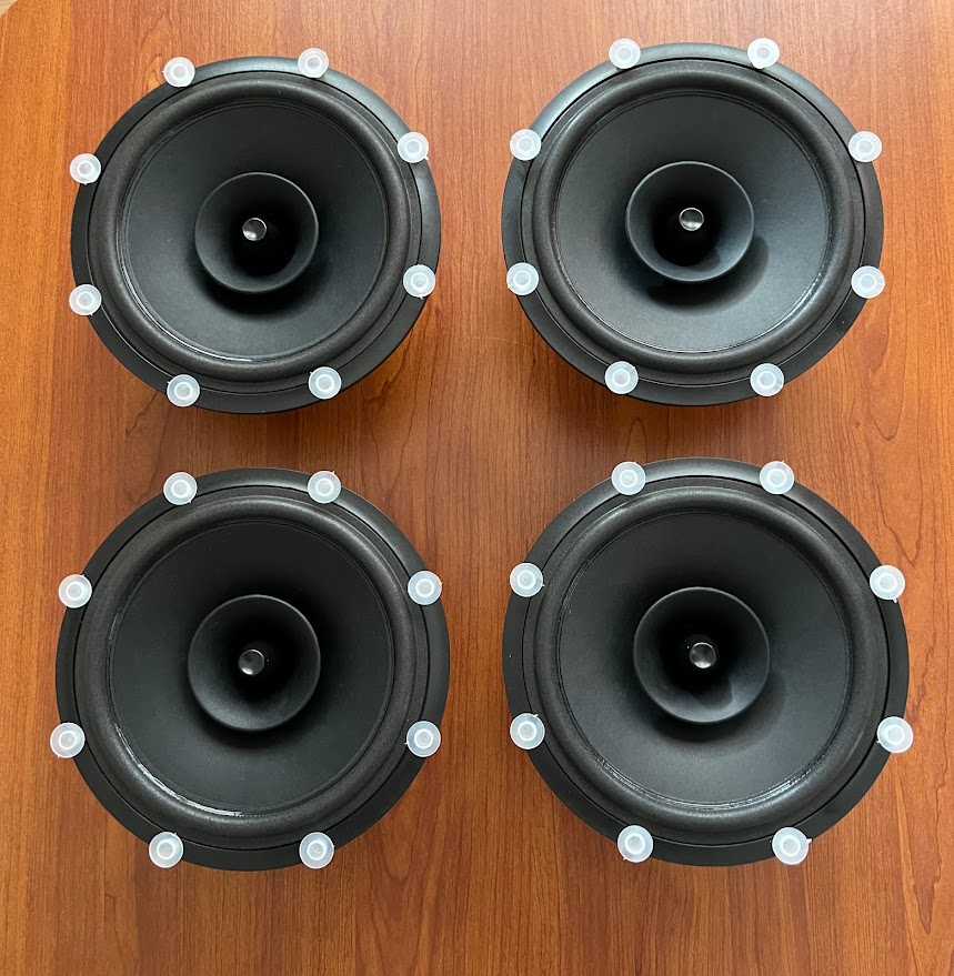

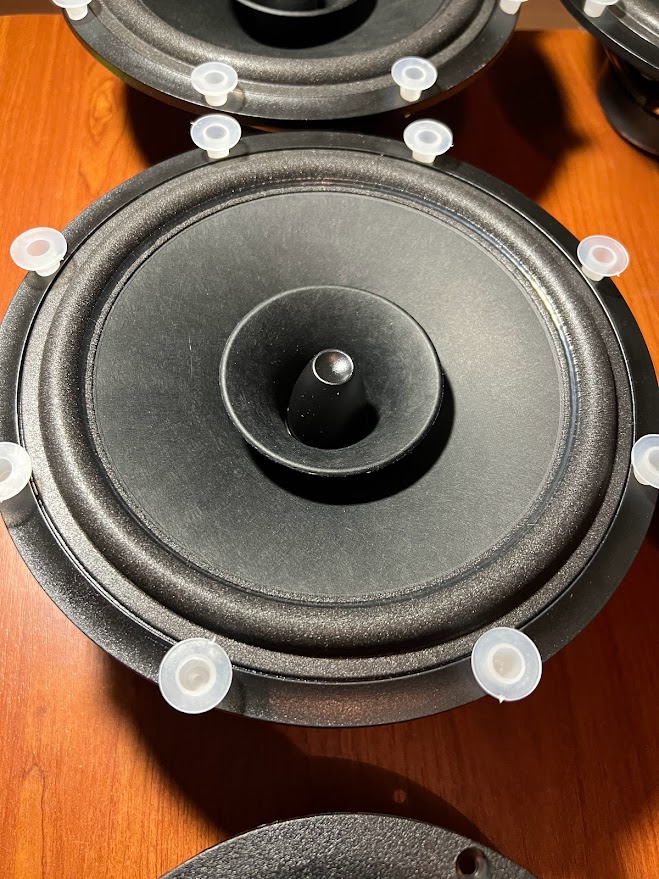

Four pieces of Cheap Monsters arrived!
They are cheap, but build quality is excellent. They have that old school green cone look and foam suspension. I will put them in sealed box for the first test.

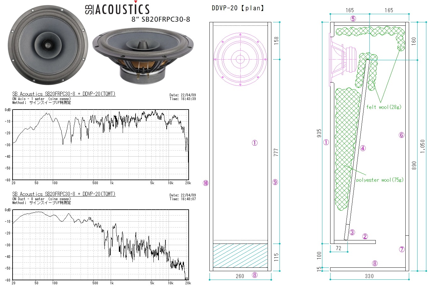

nandappe, thanks for the recordings which you are providing regularly. Sorry if I missed, but in what kind of enclosures are yours installed? Thanks...

I believe they are his DDVP-20 boxes.Four pieces of Cheap Monsters arrived!

Many thanks for sharing the details of your build. After watching the videos I am genuinely intrigued and very tempted to build a pair myself if you do not mind? I have just built a ‘bass module‘ using an SB Acoustics 10” SW26SFC38-8 for my father in 15 litre sealed enclosure only 9cm deep which had certainly added richness to his Tannoy dual concentric standmounts. I haven’t run any simulations but I wonder if these speakers, augmented with a stereo pair of sealed bass towers containing 2 x SW26s in opposing configuration, would work well?SB20FRPC30-8 is installed in DDVP-20(TQWT).
The sound is well-balanced, so I don't think filters or DSP are necessary.
SB20FRPC30-8 and DDVP-20 are a good match, so please build them.
I imagine you will be happy in the near future.
Please use the additional woofer as you like.
DDVP-20 plan and cutting

Thanks for the link. Regarding the cabinet, is there a reason that pieces 3 and 4 are separate rather than one slightly longer piece? Is it to make it easier to make an angled cut on some smaller table saws?SB20FRPC30-8 and DDVP-20 are a good match, so please build them.
