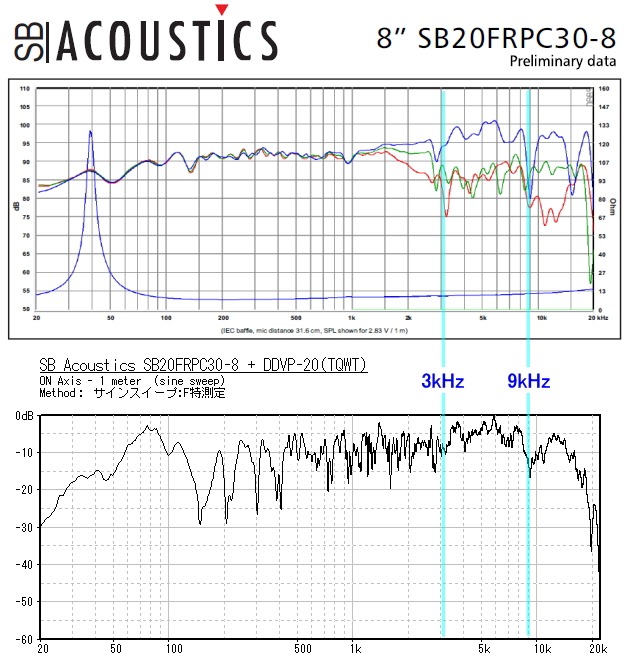

SB Acoustics SB20FRPC30-8 (8" Fullrange Cheap Monster II)
anyone do a filter to balance the 3-9 KHz peaks?

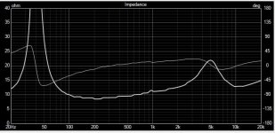

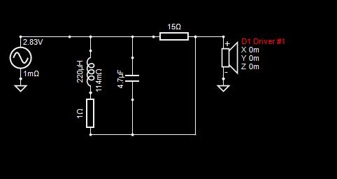

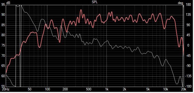

I know very little about crossover design but I fed my measurements into Xmachina with a flat target curve and got this.
